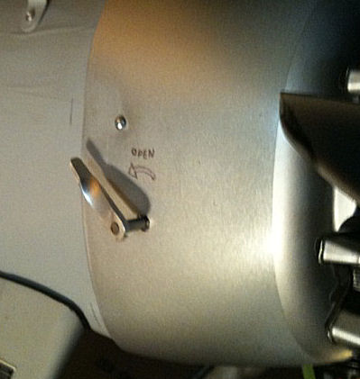

well i have not touched the engine all week i have been busy at work and have had no time maybe some time this week

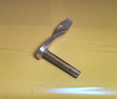

pullup, what is that attached to the choke shaft my plan was a length of brass tubing soldered to the existing shaft and putting a handle on it

ORIGINAL: av8tor1977
Interesting idea. How did you make the internal hex?

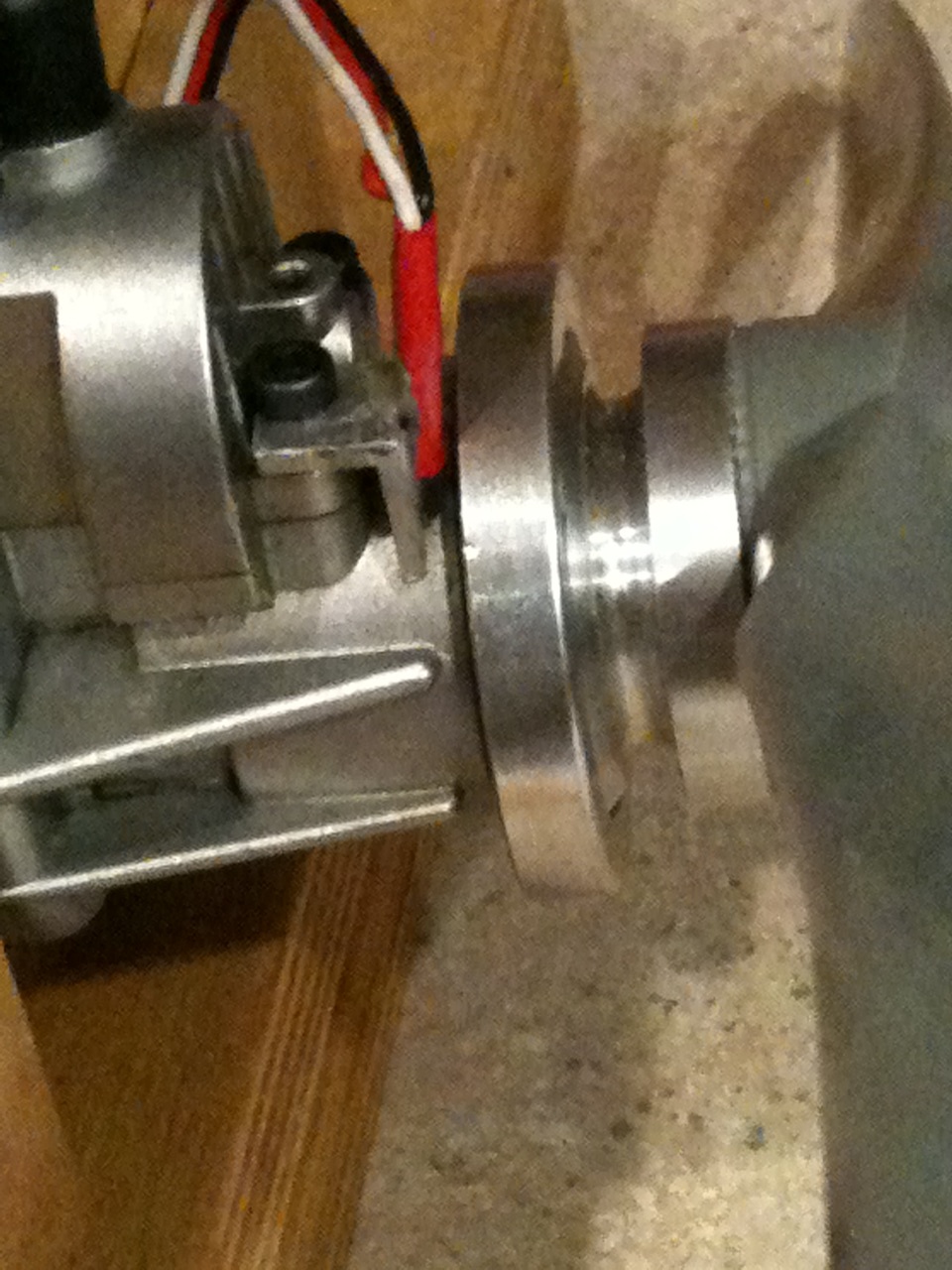

Thought you guys would like to see Saito 150 gas conversion #2....first run. Walbro was balky at first, so I just set them at the factory 1-1/4 turns out and you can see the results.
This conversion's hall sensor and magnet are a little different than the first one. This was made by CH Ignition. I like the vertical concept for the hall sensor bracket. The magnet is mounted parallel to the crankshaft in the ring, which is adjustable (timing) because it's only held on by a couple of setscrews. Good job CH! Just make the sensor bracket a little shorter for Saito and it'll be PERFECT! The bracket wouldn't fit the engine unless I placed two washers UNDER the bracket. Otherwise, it hung down too far and hit the front bearing housing. The sensor is held onto the bracket only by JB Weld. Working so far.
The good part is this setup is getting 8500RPM with an APC 13x8 prop (pattern). Seemed like it had a lot of compression when working with this engine on the bench, so I guess I'm not that surprised.

Adrian,
The carb is a used WT456 purchased used for $20 on Ebay.
Here's some pics that show that sensor mounting bracket. Unfortunately, with the viewing angle, you can't see the two washers under the mounting screw that were needed to keep the sensor off the bearing housing. Couldn't just file down the aluminum because it was the actual hall sensor that would have touched first.
Too bad the video is kind of dark. Probably won't be another one....that water has already passed under the bridge so to speak.
