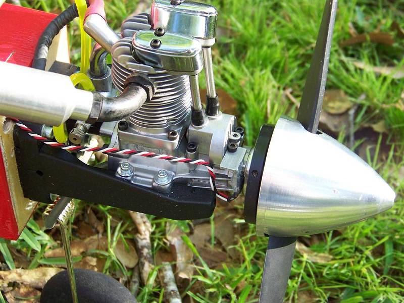

I still have to make a bracket to support the underside of the carb. the insulator is just a piece of actel sheet, 3mm thick.
Curious how the OS's will hold up. Especially the bottom main journal (plain?)
what do you mean by plain main journal? the bottom end of the OS120FS has a bronze bush, I think the later alphas series do not.
I've run the engine on glow and clocked up enough run time now to switch over to gas. Im running redline synthetic oil at 16:1. I know it may seem like alot but redline is very clean burning and in the grand sceme of things 16:1 is still alot lower than 16-18% glow mix.
I was thinking about installing a small nipple (such as a exhaust nipple) in the backplate to allow a small shoot of pure oil to be injected from time to time, to aid in bottom end lubication. there's two bosses in the back plate so drilling and tapping this area will be easy. Any thoughts?
I should mention my inspiration came from the work that ''pull up now'' has done and the videos ''i7x58'' has posted of his sweet running satios. not to mention w8ye and others in this thread and there trial and error examples. And not to mention the fact this is my last glow engine that I own, no more hydroscopic, rustly, slimely glow fuel
Thanks for the compliments about this thread, and the success we've had converting these engines.
A plain bearing is a bushing, either bronze, brass, oil impregnated bronze, or even babbit (tin & lead), that is contained within a diameter at the end of the rod. That circle on the end of the rod is called a journal. From your description, you have a plain bearing. The alternative would be a ball or needle bearing cage.
The nipple on the crankcase to inject oil is probably not necessary. I've inspected my conversions' lower ends a few times, and there is always plenty of oil. Besides, the upper end of the valve train is more of a concern. There are some who have devised a check valve system to route oil to the cam gear to address that problem. I've not had to resort to that though. Never let the engine lean out. Even if your carb comes loose from vibration, causing an air leak, is enough to destroy the engine if you don't catch it quickly and throttle back. Besides, the crankcase on a 4 stoke needs to breath freely. It's not like a 2 stroke that has a sealed crankcase, using the pressure pulses to drive the gas-rich charge into the cylinder up through the bypass ports.
The lack of a lower support on the carb is one of the instigators of the vibration that can loosen the carb, by the way.

yes I see what you mean by a plain bearing now, I've never had conrod issues in the past, mainly bearing corroison problems so fingers crossed with this new converison. I've just bench run the engine to see how it operates for now. I'm going to make a bracket to support the carburator, a piece of light aluminum should be ok as the cylinder will grow with heat, I quess 0.005" or so won't cause problems.
http://en.wikipedia.org/wiki/Polyoxymethylene "Acetal" spelt with a "e", my mistake. As far as thermal properties are concerned there are better plastics available. Acetal is very easy to cut and work with and the fact that I had some on hand. If I find my brass plate reaches high temperatures I will most likely make a new insulator.
I have no real gasket, just a thin layer of exhaust gasket sealant on the carb side, nothing on the brass plate side.

For the bottom bracket I bought extruded aluminum 1/8'' from mcmaster and cut it to dimmension , then Igot it in to my mill and went to 2.4mm all around. For the plastic top part of the carb Iseal it with RTV , I cut in to the top part some grooves for the RTV to get better grip. Ihave couple more Zama on the way, seams like those are easy to adjust. I havs an OS 91 that I have and I will convert that one when I get back home.
You may run in a little issue with idle. Have the throttle screw out all the way and just bearly touching.
Idleneedle 1 1/2 to 1 3/4 turns
High 2 turnsas a start point.

I finally got some running time on my OS FT160. I used the updated Reichmuth ignition, now being manufactured by Ridge Machine Company. The system uses two pickups set 23 degrees apart. The low speed pickup handles things up to 2000 rpm and the second one then advances the timing between 2000 rpm and 4000rpm where it reaches full advance. The system was chosen because it has very small plastic spark plug caps instead of the huge metal ones common to the Chinese systems. With the engine mounted on my 1/4 scale Cub those Chinese cap looked ridiculous.
The results using 93 octane gas 20:1 with Avenger oil and a 18-6 prop are 1400 idle and 7500 WOT. The most interesting part of this is Initial engine timing is low speed pickup set at 37 degrees BTC and the high speed pickup at 60 Degrees BTC. If I set the high speed pickup at the normal 28 degrees BTC and the low speed pickup at 5 degrees BTC the idle can be dropped to 1100 rpm but the best WOT speed is 5000 rpm. As an experiment I install a Chinese ignition system and found that I had to set the pickup at 60 degrees BTC to get the WOT rpm up to 7500. I've been talking to Ridge Machine about this and even spent 3 hours at their shop working with them and we could not figure out what was happening to cause the requirement for the large timing advance setting. Any ideas anyone?
By the way I found that the OS carb performs more than adequately.
