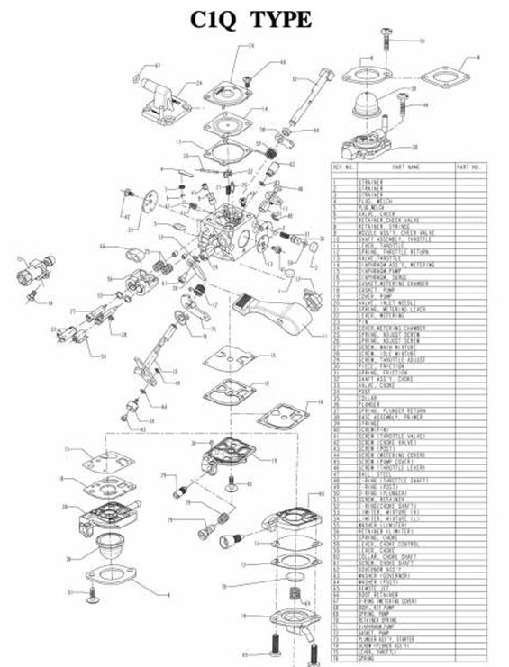

Here's the only parts diagram I could find for Zama. It was from some 3rd party site. There doesn't seem to be an organized site with all the different carb's diagrams (for Zama). And looking at these detailed diagrams are the only way to answer questions such as the presense of an intake-only spring, or an accelerator pump. Anyway, here's the diagram.

I honestly do not know what I am looking at...or for...
could you tell me what you see???
THanks..

that's why I was wondering if there is an organized Zama parts site that has diagrams (exploded views) of their various carbs. Because the picture I DID find was useless....too fuzzy to read anything on there.

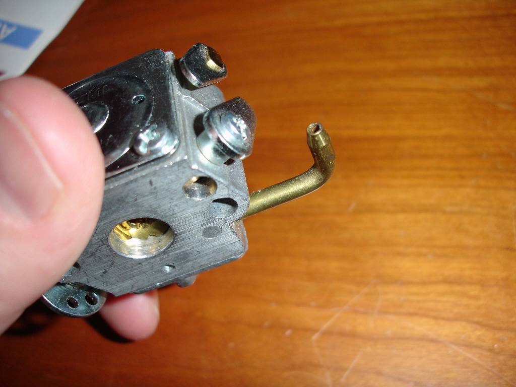

Do you guys know if the 2nd small brass outlet/inlet is if you wanted to install a primer pump ?? (In the 2nd picture right next to the low needle)
And I will have to crimp this off?
I don't think it is for intake tube to connect to?
I would think the carb would be like the Walbro and you have to have the tube line up on the base of the carb where there is a little hole, for intake pressure tube..
Anyone care to jump in on this one?

It's a little hard to follow your questions because when you ask about a little hole, you called it a tube. But when REALLY referring to a tube, you called it an inlet. But I probably suffer from a little Aspergers, so it's my problem, not yours.
Anyway, I think you're correct. Just crimp & solder the straight tube. Or cap it off with one of those little caps. This means to start the engine you'll need to be able to cover the venturi with your finger. Turn off the ignition, go to WOT, and flip the prop until your finger is wet. Then it should start. If you actually use the primer as intended, this procedure MAY not be necessary.
Yes, the little hole in the base is the impulse input. It usually just routes to the crankcase. In 4 stroke applications, it goes to the intake stack.
In picture #2, there is a little hole in the face of the base. This hole lines up with the cross shaft of the throttle plate. Look in this hole as you move the throttle to see if there is a little brass plug moving up and down. If it's there, it means you have an accelerator pump.

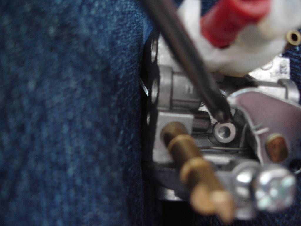

Old 01-14-2011 | 08:40 AM
  #534
Joined: Dec 2005
Posts: 3,934
From: Victoria, MN
Default RE: SMALL DISPLACEMENT FOUR STROKE GLOW TO GAS CONVERSION
In this picture, I have at the tip of this screw driver? what? = A primer tube that I should crimp off? Correct?
Old 01-14-2011 | 08:42 AM
  #535
Joined: Dec 2005
Posts: 3,934
From: Victoria, MN
In this picture; I have at the tip of my screw driver....??
The hole that lines up with the intake manifold??
Old 01-14-2011 | 09:20 AM
  #536
Joined: Dec 2005
Posts: 3,934
From: Victoria, MN
The tip of the driver must be where a hole would be drilled and the accelerator pump would be, correct?
So if mine doens't have one, is there a issue with that??
Will there be a issue with tank placement??
What purpose of a accelerator pump?
Fuel delivery? Attomization?
Thanks..

The accelerator pump squirts a little extra fuel into the carb throat when you advance the throttle.

On a Walbro, if there is a hole that exposes the butterfly shaft on the gasket face of the carb, it is has a accellerator pump. The pump is a spring loaded piston that moves on a flat spot on the shaft. It looks like the Zama might be the same from your picture.

No, that is not correct. As I said earlier, look for a hole on the mounting face of the carb, that lines up with the throttle plate's cross shaft. When I say "lines up", I mean the two holes cross each other. In your picture, I'm pretty sure I see just such a hole. Look for a little brass piston moving up & down when you rotate the throttle lever. Also, usually, you'll feel some spring tension as you rotate the shaft. Most people assume that is the external return torsion spring they're feeling. But if you remove (or unhook) the external throttle return spring, you'll still feel spring tension on the throttle. That is the accelerator pump. There's a compression spring under the little piston that keeps the plug pushing up against the throttle plate shaft.

Okay....It does have a pump.......
