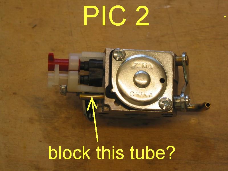

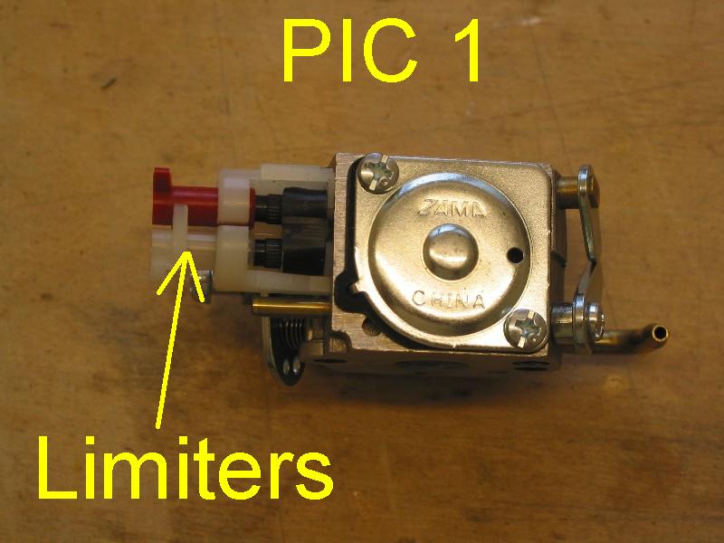

I've now got a pair of Zama C1Q P8 8YA carbs and I'd appreciate advice on the items below.
Pic 1 shows the huge plastic needle limiters, which I hope I can do without because they'll get in the way. Is there an easy way to remove them?
Pic 2 shows a tube which I think I saw earlier in the thread is used for priming. Presumably this needs blocking?

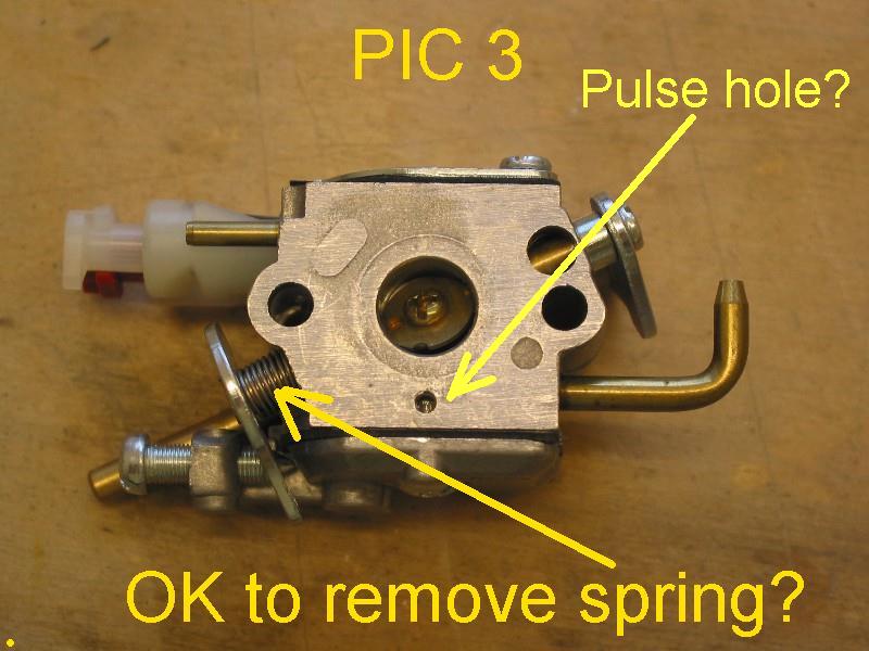

Pic 3 shows the throttle butterfly. The spring is far too strong for working with a servo, so is it OK to remove the spring? I remember reading years ago that the spring also stopped the butterfly from chattering, so maybe it needs replacing with a compression spring between the lever and the carb body.
In this pic, have I correctly labelled the pulse pressure hole?

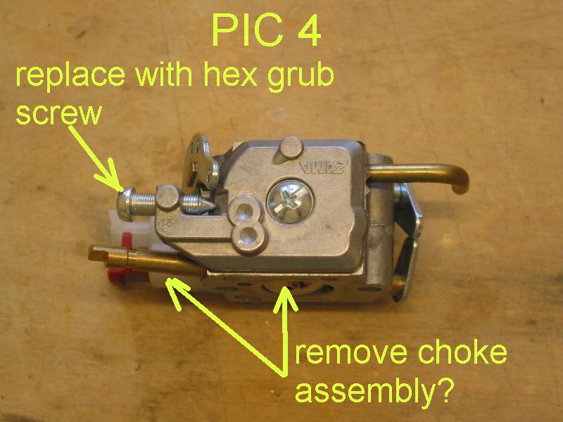

Pic 4 shows the choke and throttle stop screw. I'm thinking of removing the choke, and replacing the the screw with a sharpened grub screw. Any problems?

Pic 1: You can remove the Plastics, just get a pair of pliers and pull them off. I do that 99% of the time.
Pic 2: You must plug that. Get some tygon tubbing, heat it up and one end with a ....lighter and pinch them together when is hot enough...or pinch the brass shut and solder.
Pic 3: Take the spring from curent position and put it on the curve between the 2nd and 3rd hole. look at my pic. Pulse hole is correct.
Pic 4: Yes you can remove it if you like....but why? if is to long...you can cut it. It will make it easier to prime the carb. You can remove also the thootlle adjustment position since you get it on the servo and you will position with that. however
it my get idle sensitive and you will relay on the servo. If the screw is there ...then will hold that position all the times.
This carb can pull gasoline from 1-2 feet away easy. tank can be below ,above center carb.

Pic 1: I did it the messy way, just hacking away until it was off. Lucky for you both needles are adjustable, my carb had one adjustable and one pressed/fixed needle.
Pic 2: Just cap it off some how. I wouldn't recommend crimping it closed as you'll never know when you want to use it again.
Pic3: I never removed the spring as the carb never progressed to flight status. Removing it may create some lateral shaft slop so be careful. I'd also suggest removing the butterfly and sealing off any holes in the throttle plate for better idle control. Thin litho plate secured by the centre screw will do fine. Watch which way the plate goes in, it only fits properly one way due to the various bevels/tapers. Yes, that's a pulse hole.
Pic 4: I left the idle screw in place, it will still provide a stop if needed. Removing the choke shaft will cause a detent bearing and spring to come out. I've run mine without this but be aware you could be letting air bleed in from the shaft hole. You could probably plug it with some fuel compatible sealant.

A couple of weeks ago I tried using a Perry regulating pump working from crankcase pulses with the standard glow carbs. I spent an afternoon trying to get pump and carbs to work together, but in the end gave up as I began to lose the settings, couldn't remember what needle settings I'd started with, and couldn't achieve reliability. I wondered about getting a Cline or Iron Bay regulator, but then the Zamas came up on Ebay, and as the pair were cheaper than one Cline or IB, I decided to get the Zamas and give them a go.
With the limiter pulled off and choke shaft shortened, I should be able to fit one per cylinder. Looking at the engine this morning, I spotted what might be an easy way of fitting a single carb. Laser vees aren't just as straightforward as the usual 4-stroke singles or flat twins for fitting gas carbs. It doesn't matter whether I fit one or two carbs, I'll still have to replace the existing radial mount arrangement. A "U" style as used on various flat twins made from alloy plate will suffice. I'll keep you all posted with progress, but please don't hold your breaths as I'm dealing with some other projects right now.
The pulse hole is quite some distance from the intake throat. I'm planning to buy some PTFE sheet to make a heat spacer, so presumably, I can cut a slot in that to link the pulse hole with the intake?
