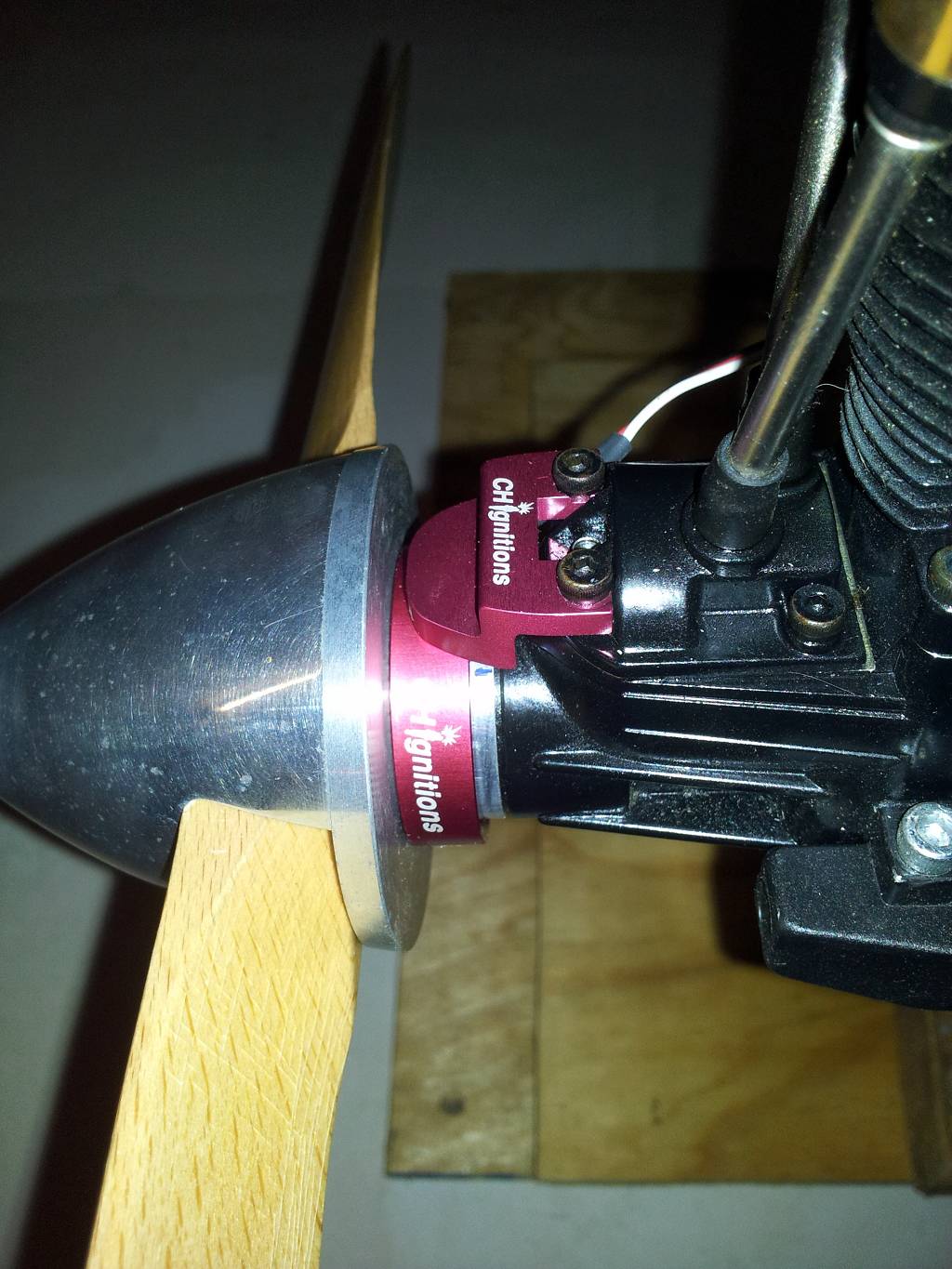

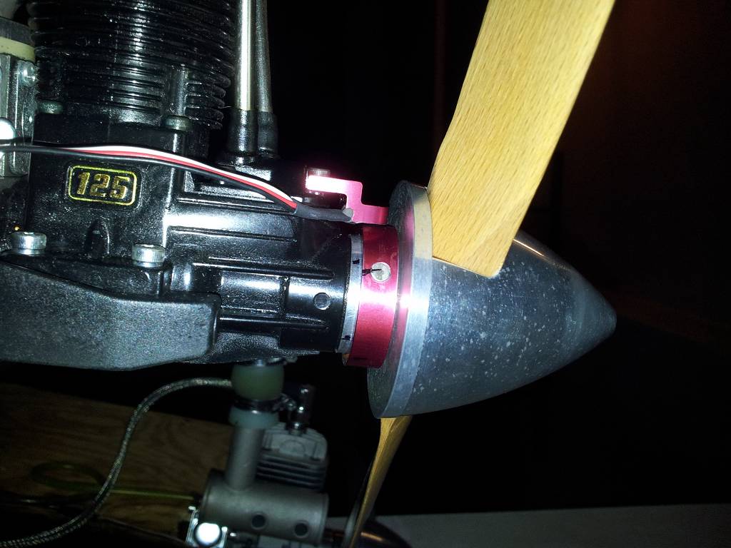

Old 02-14-2013 | 11:05 AM
  #695
Joined: May 2006
Posts: 225
From: nin, CROATIA (HRVATSKA)
Default RE: SMALL DISPLACEMENT FOUR STROKE GLOW TO GAS CONVERSION
just received my ch ignition pick up for my saito 125GK conversion looks great and works perfect.
