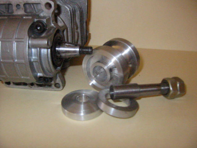

I got a FS110R string trimmer for $10.00 from our local lawn mower shop. I came home with it and setit aside. Last weekend I decided to see if it started and it did without muchcoaxing and ran like a champ. Long story short, the crankshaft is barely as long as the flywheel which makes it useless for a conversionengine.

Yeah, the crankshaft is short, but it can be done The crankshafts for the Honda and Subaru/Robin/Fujis aren't much better but again they can and have been done. If nothing else you got yourself a heck of a weed whacker for $10

If the FS110 is used for a conversion, I'm at a loss as to how one can use the flywheel/mag as it's configured from the factory. The only way I see
to use the engine is to useaVERYshort prop hub with an electonic ignition.

It surely is a good idea to keep the hub short, but I am working on a solution for that so I can have a longer hub. I have done about a dozen 32s now (both mag and EI )and in MHO, they aren't too shabby. They are compact, run inverted, and have decent power.

I've never seen one but, could you make the hub so that the prop shaft fits inside the hub and over the end of the crank? Possibly some variation of the attached photos? Using this method the par tof the hub that fits ove the taper could be little more than a thick washer.

Of course you can. The short shaft Ryobi conversion kits are done similar to your photos. Where there's a will there's a way! I would probably just make up a hub with a taper that screws right onto the shaft however....
