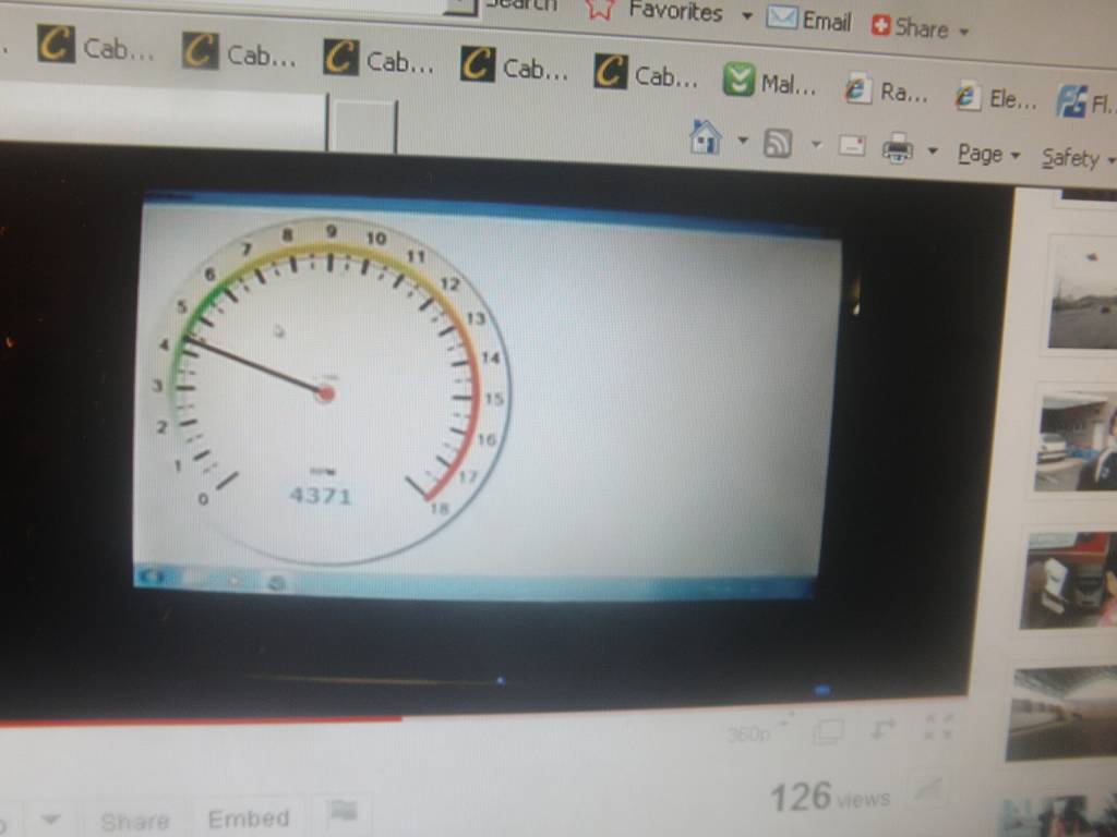

i'm from italy. i tryed the Gompy CDI project, but i have a comunication problem with the software!
The Software in the PIC work great, but with no comunication with PC software trougth Max232 TTL converter.
this are the errors the i have!
can anyone help me?
thanks for replyes!

Hi Joe..
Make sure your com port is set for 38000 baud first before trying to access it with the software. Do not try to access it more than once or an error will occurr. Also try switching the 2 wires for communications on the timer board..rx & tx.

it's really strange this!
usually the com port was setted by the software. so, i'll try this way.....i hope it start to work.

ok.....it's very strange, but now it work. but......i don't know what i did for.
now, we have to test it on my engine, and maybe, after add some function that i need. IF is possible to have the surce code.....
for exemple, add 2 different advance table, or add an encoder or a trimmer for change on-line +-2° all the table.
