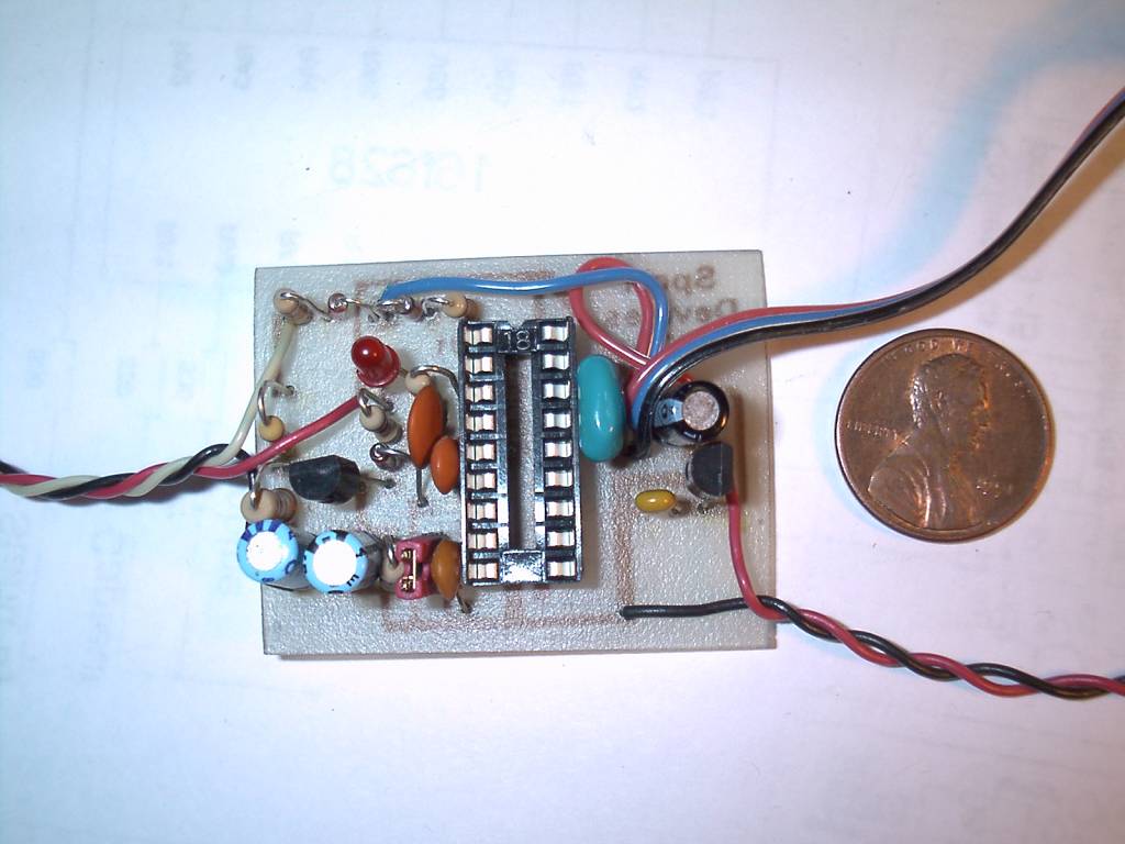

I am itching to try this new board (Sport Devices) but I can't see how the table gets added to the hex file.. Is there something I am missing?
John

Old 01-19-2011 | 05:44 PM
  #420
Joined: Nov 2005
Posts: 805
From: Hamburg, PA
Default RE: Complete new CDI - website open
Anyone else know how the programming of the 2 curves is accomplished in the Sport Devices CDI auto advance board?
Also, does anyone have the hex file compiled with the CCS compiler?
John

John,
I do. I emailed it to you.
Old 01-20-2011 | 02:26 AM

I don't know. You would have to email the guy that wrote the code.
Charlie.. the hex didn't seem to work on the board.. you have any luck? When I power up, the led blinks once and that's all the activity I get from it.
