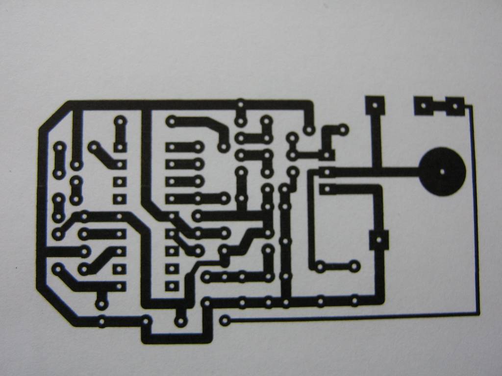

Hi John,
You are right and I change the PCB. (new documents online now)
THX !

Hi Jeff,
R8 isn't connected to plus anymore but to ground into the new pcb.
I work for 40 years with layo1, I think I can make changes faster
