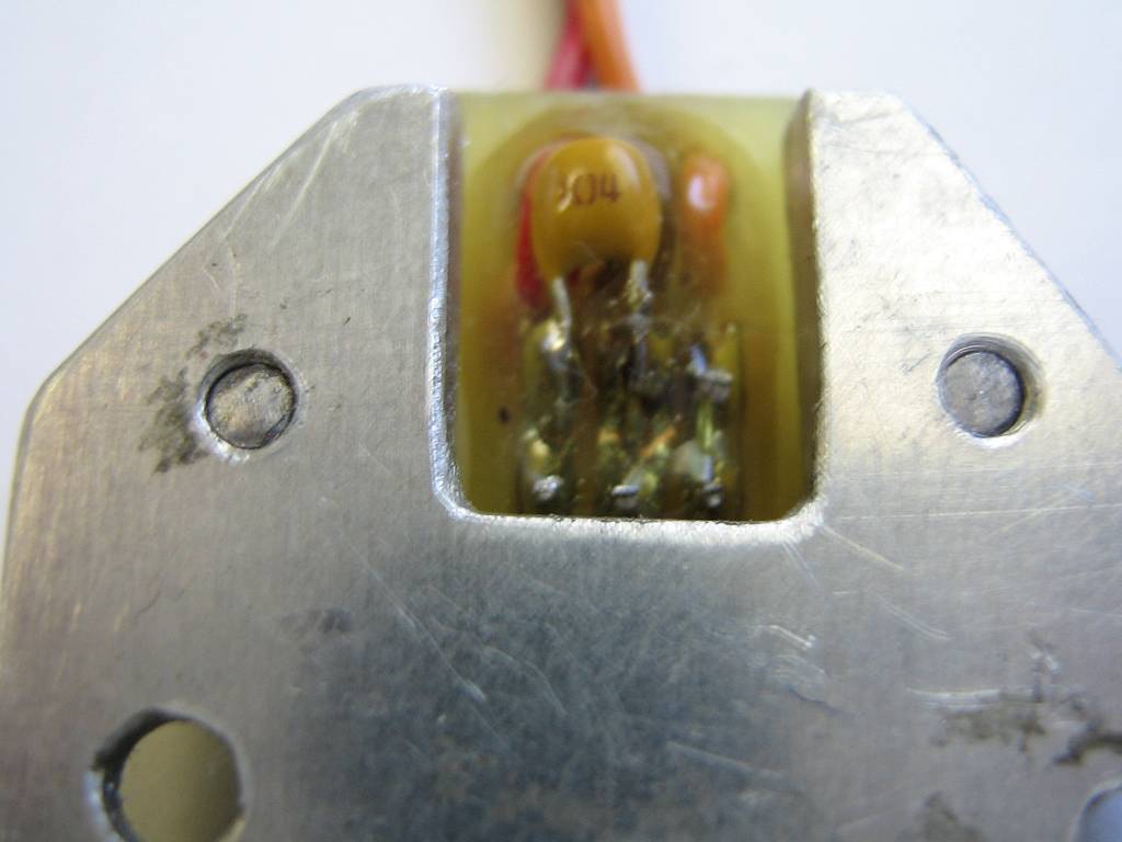

If you can't see anything wrong or missing Charlie, then I sent you the correct edited layout.
So far, I think the small .1 uf cap across the hall leads has solved my misfires at low speed. If we could only change the firing to after the magnet passes, it would be great. Alot must be changed for my hall mounts to accomodate the early firing.
I've been doing a work-around on that and it seems to be ok. Maybe the pickup point can take care of that? Not sure yet.
John
John

3e, you can change the pickup point (hard-and software).
4e, every detection in industry isl make on a ricing point.
#118
Joined: Mar 2009
Posts: 293
From: xnot applicable, AUSTRALIA
ORIGINAL: gr8flyer55
John
John
Jeff
#120
the compiler is out of free use
Rob,
What compiler did he use? It won't take any more program space to change the way the pic operates. All you have to do a logical AND on the input. Just as Nemey did. know I misspelled his name.
#121
Joined: Jul 2010
Posts: 404
From: Alkmaar, NETHERLANDS
Why change the program for one person if everyone is / can changing the POP ?
BTW, wat do you thinking about the time left to calculate the advange ?
It's not only to change a bit, the complete calculation will be wrong or to short.
I don't know wat compiler he was using, even I don't have the source code (or compiler)
#122
Joined: Nov 2005
Posts: 805
From: Hamburg,
PA
Rob, I can take care of the early trigger point. What I have experimented with was to set my low rpm timing to zero degrees and the total advance to only 17 degrees for top rpm. It works that way and I don't have to really move the hall mount much.
When I ran the engine that way, it still started easily and gives me the same top rpm and power as before.
The oscillation I was getting at slow speeds was fixed mostly by adding the .1 cap on the hall leads. It only does it now at starting speeds and then goes away. One odd thing though was that it takes 2 passes with the magnet after power up to produce the first spark. Charlie mentioned that also in his testing..kind of like it tests the speed first to make sure the engine is rotating or something..not sure what it does there.
John
John
