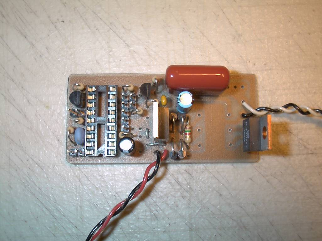

Rob.. I think I may have the diodes soldered in wrong. Which bands are up and which are down? Other than that part, I am almost ready to test the combo board. Just have to solder in the toroid transformer.
John

GR8 ...if you are referring to which end is which on the diode, the band end is the cathode.

Diode

Ok Charlie.. Was just wondering since you said you were ready to start assembly. Thanks Rob for the diode direction symbols! I did have them all wrong, not just two..Oh well..unsolder and resolder I guess..winding the rest of the toroid today sometime and then time to program the pic.

No HV on the combo board yet Rob. Wired in the toroid and all I am getting is a hot MJE3055t. No oscillations for some reason.. Tried switching the primary leads and feedback windings. Raised the resistor value and lowered it. Still no oscillations. Not sure why yet.. I'll try another transistor next.
John

Is there anyone building the new combo board? Mine is now working..had a nonresponsive transistor..go figure. It now runs my test engine equally well, like the stand alone timer boards and ignitions..
Thanks Rob for the great combo board!

I found a potential problem for those who are building the combo board. the schematic is correct..but the parts overlay has one error. The one end of resistor R-8 is showing that it goes to a positive connection, where it should go to a negative connection. I switched that one connection to get the board to function..now it works perfectly. I just thought it might be helpful to those who might have overlooked the schematic and built the board from the component overlay.
I ran the test engine with it and it works great! I'll get back to the instructions with pictures on winding the toroid transformer now and should have it posted in a day or two. Thanks again for a great addition to this project.
