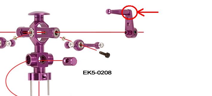

So, I am hovering myHBK2 in the driveway...nice and steady,really enjoying myself.
When, all of a sudden, I hear a ZING go by my right ear...kinda like a bullet richochet....only smaller.
I dismiss it as a mosquito or some other bug trying to distract me so I will crash. I keep hovering for about 2 more minutes ,then safely land.
After the rotors stop spinning, I notice something is not quite right......parts are hangin abnormally.
Turns out, the tiny screw that holds a little spindle on had worked loose.......thought I had threadlocked everything,guess I missed that one.
Anyways,see the attached pic for location of said screw.Amazing how it id NOT crash with this part hanging freely....flew just fine in fact!

Briz i had a very similiar problem. flying around then all of the sudden the blades just decided to do what ever it felt like. After i landed i noticed this screw was missing (the one in the pic) This is off of the king bee V2 CNC and now i cant figure out which screw to get to replace it? anyone have any thoughts?? i bought some 2-56 but they were to big! i have looking around but no one gives any specs on screws. can someone point me in the right direction?? THANKS!!

All the screws on the Heli are Metric! Worse is they are Chinese Metric which is not the same as any other metric (Chinese don't abide by world metric standard).
That little screw you lost is a pain to find without buying a new head and its crucal to setting pitch when its loose. Suggest you get yourself a 2-56 tap and a large assortment of screws and bolts as your going to find that most of the screws and bolts in the cnc head are going to work loose, loctite or not as the taped holes are ALL over sized, and combined with the poor quality alumn that was used ...
Old 07-26-2008 | 08:12 AM
Joined: Nov 2004
Posts: 968
From: South City, CA
Default RE: ZING!!!!!!.......threadlock needed!
I believe that screw can be replaced with one that holds a ball link. Notice that it is a flat head with a angled base to it and it, check out a set of ball links for a CP they include the screws with the balls and although you only need one screw now you will want the balls later for linkage upgrades.
