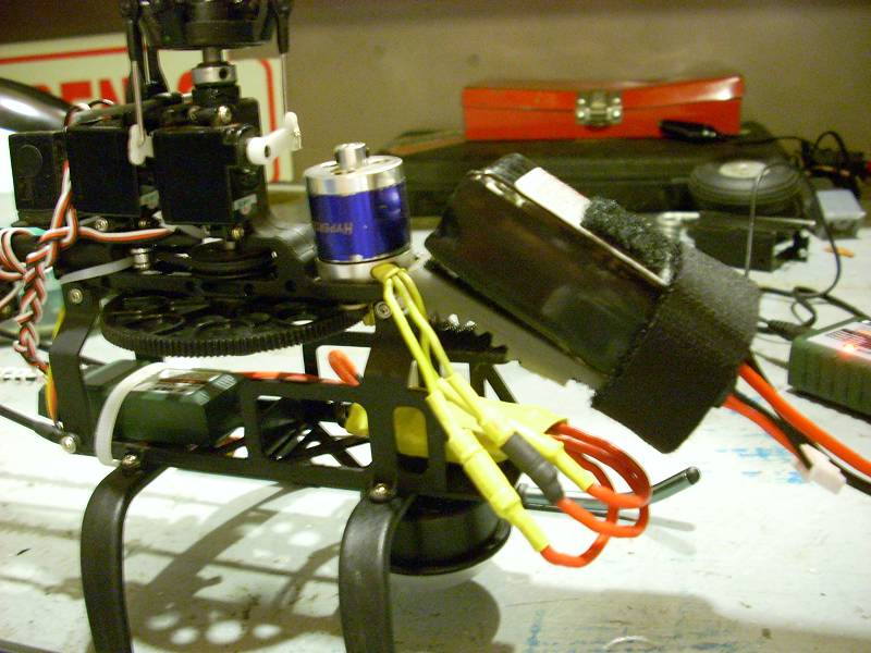

Well call me an idiot! I just got my new Dynam ESC and i dont know how to install it. I have three red wires? Which one goes to which color. and pics would be extremely helpful! I bought a programmer as well hope it works!

Spamming your questions ehe Bob??? Like the answer in the tuner thread states, connect all three any way you want. If the motor spins the wrong way, swap ANY two wires an it will spin correctly...Heres a pic of mine...
