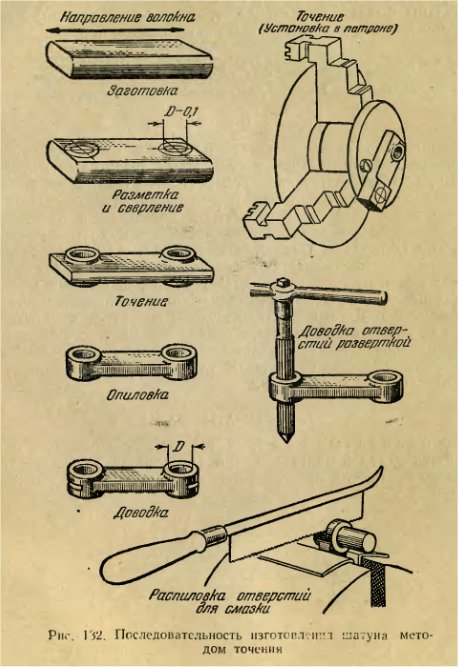

Getting back to this project , yes Im taking the lightening too far , I will use a 2.5mm piston pin instead of the usual Silver Swallow 4mm , that should be right on the limit ,
I will just test my rubber mounts and get back to building this interesting motor,
my last 3 cranks lasted an average of 6 controline flights before big end failures
Diesel is hard on big end ?????

Depending on which material was usen in Silver Swallow under production. I am unknown with the material in the Silver Swallow..
And how much is percentage of oil in fuel.
1. I will replaced with a duraluminium (Dur = Hard) as material. If you has acess to a lathe or milling machine, you can make a new con-rod.
2. Drill the oil hole or small saw cut under and above ends of con-rod to improve lubrication between con-rod and crankpin/wristpin. Important! Never drill oilhole where the crankpin ans wristpin has contact with con-rod since there is a hydrodynamic oilpressure under use. If there is oil hole on wrong place, the hydrodynamic oilpressure will disappear and give more abration between con-rod and crankpin and wristpin. see pic...

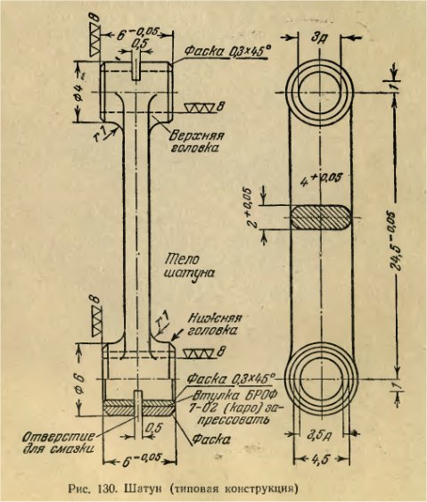

I sorta like where they drill the oil hole on the top facing the intake hole in the crankshaft. That way it gets more fresh oil coming in more cool and hits the crankshaft on the way into the crankcase. This example is from a old Irvine .61 engine. But the oil hole could be either way, top of bottom as both methods work. I am not that fond of the narrow slit or cut in the rod. I see that as a point for failure as it weakens the rod more, but that would be with high RPMs or higher stress situations where it would be a issue.
#36
ORIGINAL: earlwb
[img][/img]
[img][/img]
I had never seen the engine been damaged by slitted recess for oil in the bottom of connecting rod. I has some model engines with slitted recess in connecting rod, in fact there is not much load in running condition.
See the pic..
In the engine who has a oil hole placed on the top of con-rod has own oil pump to give continous oil pressure whole time as you find in the automobile car engine to example..
The purpose with the oil hole placed on the top of con-rod to lubricate the pressure zone between the cylinder and piston before the piston goes down during the combustion period.
Edit: forgotten to write more..

A trick that I have seen on a few diesel conversion and Team Race diesels is to simply file a 'star' shape or cross on the big end eye of the rod closest to the crank web, this allows four points for the oil to get out once it has entered, and it gives a full flow through from the star points to the back of the rod.
It OK providing an oil entry point with a hole or a slit but its more important that it has a really good exit point and a 'star' shape, much like the much vaulted crank web grinding seen on RC cars, will act as an oil slinger flicking away what is coming out of the bearing.
In talks with some racing guys here in Oz, they reckon that the star alone is far better than any oil hole or slit with the rods lasing longer.
(I found it hard to get my head around it but the proof is in the pudding!)
Cheers.
Cheers.
