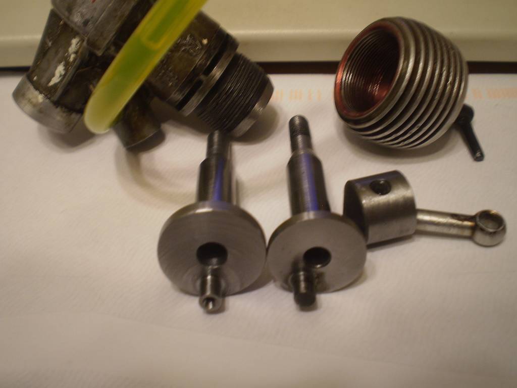

Old 07-01-2011 | 04:25 AM
Joined: Oct 2005
Posts: 396
From: ACTAustralia, AUSTRALIA
Default RE: Silver Swallow Pulldown
so far , a 2 mm increase in stroke to bring it to 1.75 cc and a bigger gas passage and a 19 dia crank counterweight instead of 17.1, I will cut some from the pin side of the crank to try and balance a bit and a 3mm wrist pin instead of a 4mm in the piston , the stroke is bigger than the bore now , I dont know how that will affect it ?
Old 07-01-2011 | 04:44 AM
AMB
Joined: Jun 2003
Posts: 6,748
From: winter park, FL
my guessa few less revs but a torque increase should swing a little larger prop martin

I was a bit surprised that crank fitted in,,,,,,,, its much bigger and Ive got the cyl honed with a pretty steep taper , that maybe bad,,,,,, and I was thinking of a longer rod ( about 8mm ) to reduce the piston acceleration I will use a Viton O ring in cast contra piston,

I think I was up the creek about piston acceleration ,and rod length , i will just ask ,
what is the accepted rod length to stroke ratio for a model diesel?, I guess an Oliver Tiger would be a good example
Old 07-04-2011 | 01:25 AM
Joined: Oct 2005
Posts: 396

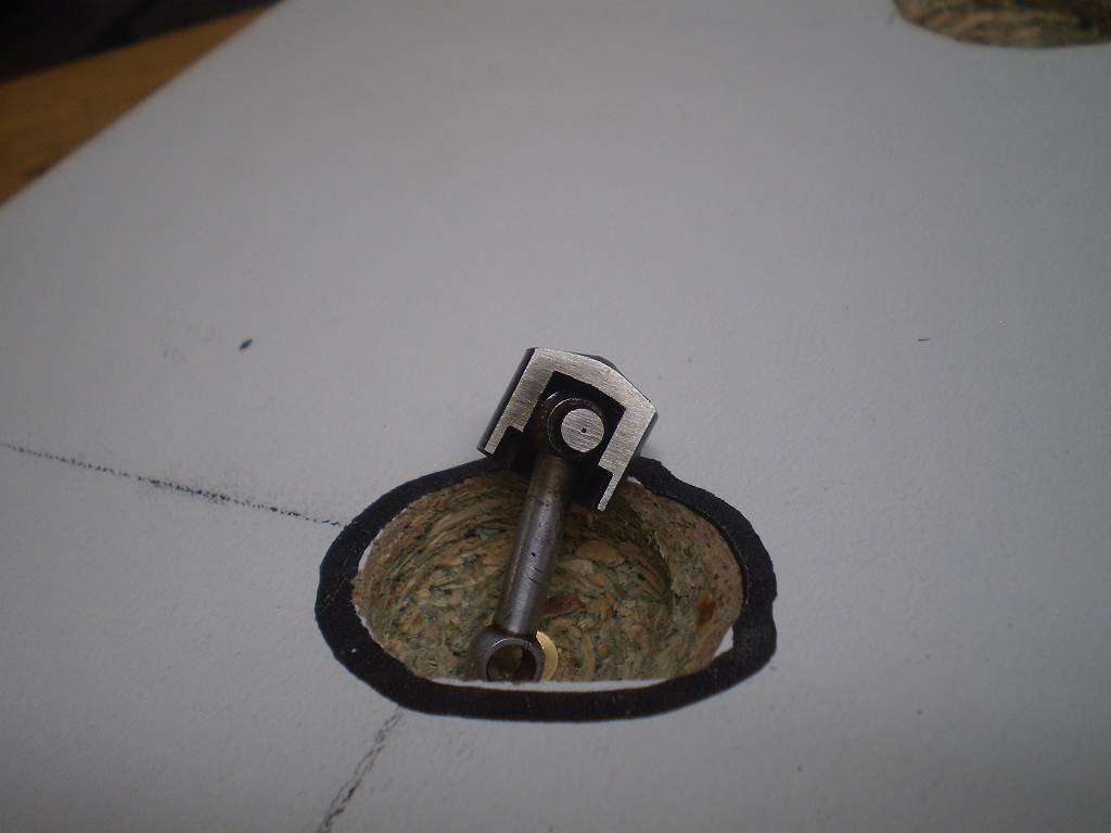

I cut the piston in half and measured 2mm crown and 2mm sides , will post picture tomorrow , that pretty thick , I will go for 0.8mm thick and a 3mm gudgeon pin , hard dowel pin
I made a con
rod at stock length , its short at 1.5 x the stroke but a cyl spacer would bring it to 2.00 , thats on the long side,
I will put a 4.5 mm dia x 2.8 mm long copper piece in the counterweight for some better balance
Im going to put a big type OS glow , type induction hole in the crank, may as well , the stock hole is pretty small
Its for a C/L slow combat model . and it needs power the stock motor is a bit weak

Old 07-05-2011 | 02:54 AM
Joined: Oct 2005
Posts: 396
The piston in section
