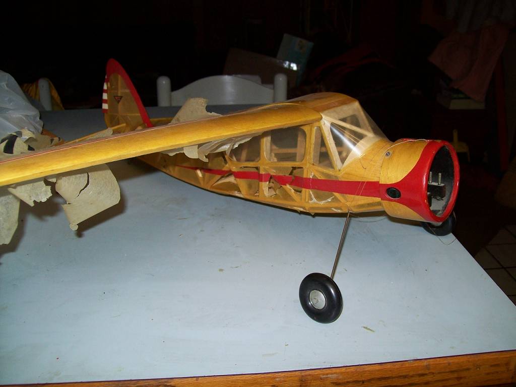

This may be it was given this years ago rudder reads keilcraft, covering in tatters but structure OK other wing is in the back room somewheres
very light. looks like free flight but rudder and elevator can be modified for RCmight make a nice redo project, old, cowl is made of rolled thin plywood
for the 06PAW have no idea of vintage but most be up there in years

You must have been still editing your previous post, as I didn't see that cute little airplane when I first read it, and replied.
Don't know what model it might be, but it's very attractive. Would like to see it when you get around to putting it in the air where it belongs.

Bill I was at the local HS a few years back and they had bought a large amount of model stuff engines planes etc in an estate sale and this was one of them
the owner said nobody is going to redo ( the ARF thing
is it now) this and was going to trash it, so he gave it to me,It well sealed wing mount glued to body, so I guess access to putting in servos
receiver and tank will be thru the windows and needsa new engine mount for the 06 PAW the installed one looks to be about a .10 engine size
anybody have an idea one the age?? Keilcraft made it a kit?? martin
LOCTITE 101 was posting when you were thx for the info wow goes back a few years and it shows a diesel with tank on engine hence solid firewall
wonder what engine that was?? Its very well put together all joints solid

the engine shown is an ED Bee. These were a very popular small free flight diesel (1 cc or 0.06 ci capacity) in the anglosphere, possibly second only to the Mills range in popularity. They are still available on ebay UK, but clapped out rather quickly.
I think I could find a plan for the model. They are still being built as free flight assist models in Australia and the UK. A friend of mine has a kit, they were still being sold into the 1990's IIRC.
Ray
LOCTITE101 I just checked and my Sharma 09 is a drop in fit on the mount, so a little more punch for thee weight, it is fiited with a PAW stack,
The OS 10LA or TT10 davis heads would fit but the muffler would mess up that nice cowl martin
I think the orginal owner used an engine larger than 06 due to the engine mount

The ED Bee details are given here.
http://www.modelenginenews.org/cardfile/edb.html
No doubt a modern slighty larger diesel would make it fly better as I believe they tend to be tail heavy.
