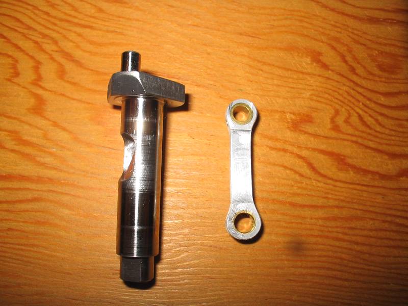

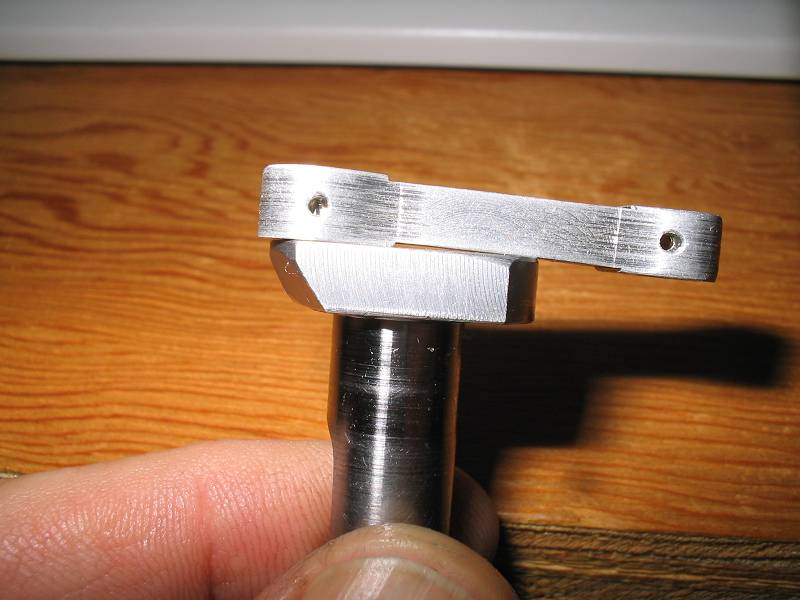

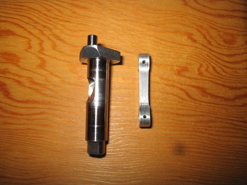

Here we have the Norvel .15 rebuilt with a custom made rod, brass bushed both ends. The crank has also been fitted with brass bushings on both ends. We now have a machine with zero slop in the system.
A prior experiment using Soya oil and ether as the fuel was met with the justified criticism that perhaps it was just the ether that was burning. The clue was the heavy white smoke generated by the engine at full throttle.

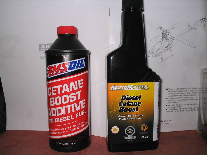

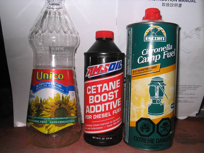

So this time, I made up a mix of
6 oz of Sunflower oil straight from the fridge.
2/3rd oz of kerosene - (11%)
2/3rd oz of Camp stove fuel (naphtha) - (11%)
25 drops of Amsoil cetane booster - (1%)
Much reading on biodiesel and SVO (straight vegetable oil) lead me to this formula. Special thanks to Kelly for the tip on using naphtha in a diesel fuel.
And as you see, it runs. Note that this time, we have MOST of the mix composed of oil as the fuel. On top of that,,,, note that we have no added oil for lubrication. As a two stroke, the Norvel normally requires an oil to be added to the fuel for lubrication. However, as the oil IS the fuel, it serves double duty as in burning for the go and oiling for the keep it from blowing up. Neat.

Pictured below are some of the ingredients.
Also pictured is the mysterious, MotoMaster cetane booster. It finally came in. The bottle reads that it contains mineral spirits and 1,2,4-trimethylbenzene. Sounds nasty and look, a skull and crossbones on the bottle. Didn't check the MSDS but I WAS very careful with handling.
A full afternoon of testing has confirmed that it pretty much works as well as the Amsoil which is octyl nitrate. The 350 mL bottle cost 10 dollars $anadian and at 2% concentration, that'll make 4 1/2 gallons of fuel.
So, straight vegetable oil, or SVO, WILL run in at least, a dieselized Norvel. Viscosity is an issue, as you correctly point out and that may be just a matter of more kero and/or naphtha. The question that comes to mind for me, is that, how does the engine know how much oil to burn and how much to retain as a lubricant? And how do the other ingredients contribute to this unusual situation.

So it is interesting as you believe it works as well as the Amsoil Cetane boost - octyl nitrate also known as 2 ethyl hexyl nitrate. Two very different products.
I am not questioning that it appeared to work but I am starting to question just what the ignition improvers do for our fuels. Some descriptions of how our fuel burns is that the ether ignites first which then causes the other fuel(s) to ignite and the DII (amyl nitrate, iso propyl nitrate etc) modify the burning rate to eliminate knock, in other words when the ether goes off it just doesn't cause everything to off all at once causing detonation (I think that is right term, I will have to revue ealier in the thread on that discussion). If this is the case then perhaps some of the octane boost compounds sold for use with gasoline might have the same effect ? Remember my earlier comments about the F2d team racers adding tetra ethyl lead and ferrocene to their fuels for much the same purpose and I recall that they tended to use amyl nitrate or IPN in the 1% ranges as well. And of course kerosene burns at lower rate than gasoline, maybe the DII work their magic better with lower grade kerosenes?
Andy has some of that Klotz Nitro power stuff which contains nitro propane, have you tried that in place of the Cetane boost? (he may have I just can't remember)
Maybe all this cetane boost stuff has been a bit of red herring. Useful in our fuels perhaps but not the be all that was thought. After all, high cetane numbers or index is preferable but if you can't create a high enough temperature to cause ignition and get the fuel atomized then it just isn't going to go pop.

Thanks for taking the trouble to look into MotoMaster's version of cetane booster. Yes, it APPEARED to work, I couldn't distinguish one from the other when I ran the .15 on a standard 40/40/20 mix. But I've also managed to run the mix with NO cetane booster. Needle and CP settings were different and throttling changed a bit etc. etc.
And there was that run I made on the PAW here,
http://www.youtube.com/watch?v=8R9YL_KPRYE
with the 10% Amsoil CB on a no ether fuel. In that case, I had to back out the CP more than on a lower percentage mix. So CBs ARE doing something. And in that case, with the reduced compression, throttling suffered. Maybe MM's version of CB will behave differently? Making throttling not such an issue? Just need to try it.
But a few posts back, I found that in some cases, leaving out the CB provided some benefits. But we're calling it cetane booster when we SHOULD, maybe, be calling them ignition improvers. As in when you're trying to start your traditional diesel by hand. With electric starters, maybe we really don't really need the stuff. Somewhere it was suggested that what the automotive world called cetane booster performed the same function as amyl nitrate which is really an ignition improver, not a cetane booster. So you have a point about the red herring thing. This is getting complicated.

About the rod mentioned earlier. Pictured is the rod I made after I bent the stock rod. The aluminum grade is unknown as it's just a piece of rectangular material from god only knows where. It cuts easily but does not feel too soft. At any rate, mass makes up for grade,, or so I thought. When trying to get some of the dud mixes going, I eventually got hydraulic lock and banged up the rod. It bent in both directions as can be seen. Why? Well, my Sullivan MicroStarter stopped working due to a bad switch and I had to go to my stock starter for these runs.
One thing I did get from this is that Norvel cranks are TOUGH and can take the abuse. No worries ever, I think, about diesel conversions for Norvels. STILL have not been able to break a Norvel crank.
Hopefully I can tap the rod back into reasonable alignment. This should be possible as I now have a small bit of slop/clearance. Hope so as the spare rod was installed into my "good" .15.

I'm confused about what the cetane booster is doing as well. I don't think it changes the auto-ignition temp and it almost seems like it would make detonation worse. But I have to say it seems like it helps.
I flew again today for about an hour on my Black Brew 4 parts to 1 part Davis Plane. I works well once the engine is warmed up.
I'm also wondering when we mix fuels with different auto ignition temps whether we get an average or we get different parts of the fuel lighting off at different times. If it is the latter it will allow us to time the layers of the combustion event to best suit our needs.
20% oil really seems like more than necessary with pump diesel. I bet I could go lower but I really don't know how to tell when to stop so - maybe I will leave it alone.

An excellent suggestion. Kero has an AI of 420 and ether has 170. Quite a spread. So it's easy to see that the one brings the other up or down and we see the result in our engines. Gasoline and naphtha have an AI of some 250 and so, being better than kero, addition of same would average out to a better AI than kero alone. This is what Kelly was getting at, I think.
So we may just be back to square one in all of this. Our engines WILL run on just kerosene and oil. That oil can be a highly refined, modern grade of castor and it WILL stay in suspension as long as the ambient temperatures are reasonable. Or that issue can be eliminated altogether with the use of 50 weight Aviation oil. But for those of us that demand it, throttling suffers with little or no ether. Greater amounts of CB makes it worse.
A mechanical solution is being considered but some snags have been encountered. Theoretically the device should work but a chemical approach that works automatically and every time and never breaks may be a better way to go. But you never know.
The biodiesel and SVO and even crankcase oil was interesting and informative. Who would have thought ANY of this was doable. And ONLY doable if you use an electric starter.

The .15 is rebuilt and ready for more abuse. Kelly has offered a new approach that has merit and will be tried. If only the #$%^% weather will hold. Global warming? HAH !!
