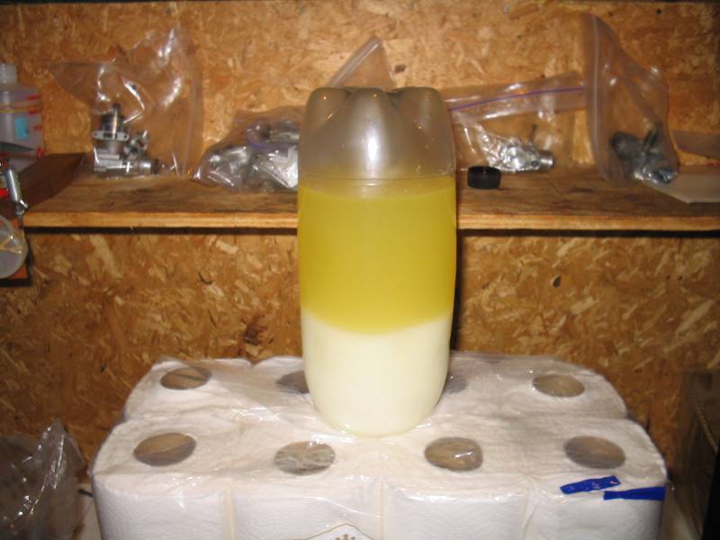

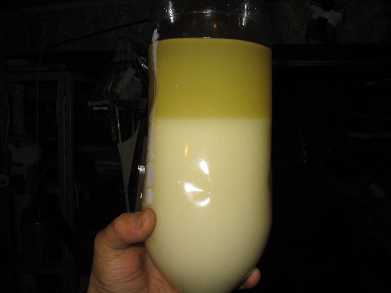

BTW, coconut oil remains in suspension in kerosene at below 70F at 30% concentration. !!!! Hmmm. Looks like the fat man is lingering at the stadium. Maybe, as coconut oil is radically different from other SVOs, we have some possibilities here.

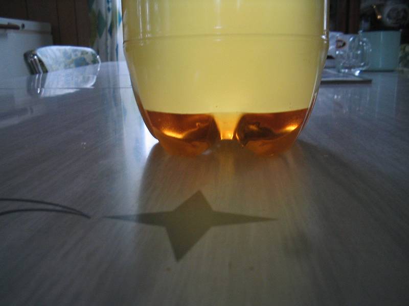

Tonight we have some clarification and refinement of the procedures for making Biodiesel fuel. Some random pictures to illustrate. First, an adaptor was made to make the settling and draining of the unwanted materials much easier to do, with less mess.
The second and third picture shows what you get settled out after the lye/meth treatment.
During the washing process, during the latter stages, the settling takes longer as the soap scum gets real heavy. Fourth and fifth pictures.
Six and seven shows the soap scum that the washing takes out.
