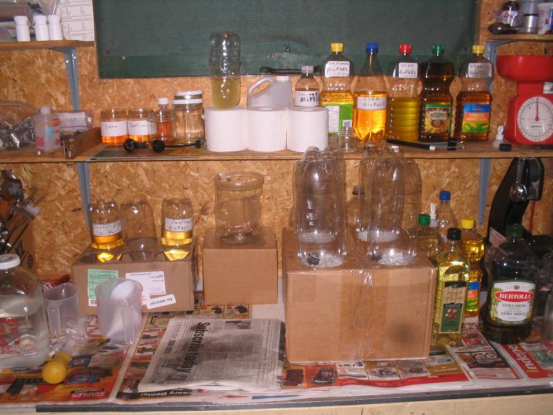

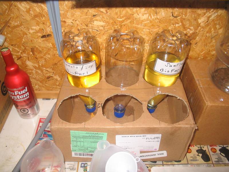

The next experiment is related to the pictures enclosed. We are gaining more skill at producing BioFuel. So we now have better facilities to produce in quantity. Set up are four jugs to make up about a gallon at a time.
Our fuel is now clear with no long settling time required. The trick was to make up special jugs that would allow the left over methanol and water to evaporate. The brews were quite cloudy as long as they stayed in sealed containers. Once exposed to air for a day, they cleared up perfectly. So, I suspect that water is also the culprit in a cloudy BioLube.
So with very good samples of canola/soy, corn, and sunflower BioFuel, I proceeded to try to get these to run as B100 fuels. That is, no ether OR kerosene. Just 2% Amsoil, ignition improver.
As before, it took some gnarly effort to get these fuels to run. The needle needs to be out six turns. The compression needs to be maxed to start and then, needs to be milked out some 3/4ths of a turn. At least on this day, on these brews.
The Corn BioFuel was the easiest to get going by far and ran the best, with better power and smoother runs. I was glad to find this out as I was prepared to make up a gallon of the canola/soy just because it was cheaper. Well, I found a brand of pure corn oil that was only a dollar more so that was a good thing and will be the base for all my future experiments with BioFuel.
