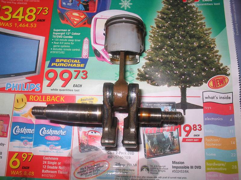

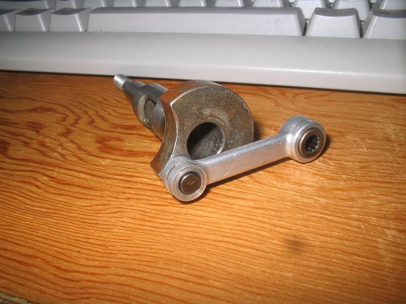

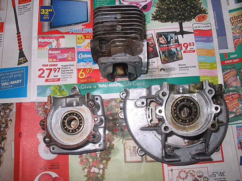

Another neat thing happened today. I was the lucky recipient of three Tanaka engines, the bigger one is a cream puff, excellent compression and the rings and cylinder look prime. I've got it apart and it has needle cages on both ends of the rod. Zero slop and oh boy, what a solid looking rod. Forged steel but quite slim and light weight looking. Besides, the double counterbalances on the crank are a sight to behold. I've got the prop hub made and the rest is just grinding off all the unwanted metal. I think I'll run it as glow first and spend the winter doing it up diesel.
But, big question. The Mills diesel is a sideport design. Am I not right in that as such, it'll run in both directions? Equally?

Good pickup with the Tanaka engines , will look forwards to your diesel experiments with them.
Yes the mills will run either way, as will all sideport motors, they also suffer the same as cox reedies in sometimes not starting in the desired direction. Not a problem with electric or spring starters but sometimes frustrateing till the correct hand starting technique is learnt.

Stewart,
That's good to hear. This engine has the cylinder held in place with four, equally spaced bolts. As such and with the side port design, that means that the carb can be placed forward and the exhaust to the rear. Or any combination you want. Wonderfully versatile feature. Hey what of a twin with counter-rotating props? Or even a four like a big B-17? Can you hear it? Four of these, on diesel, purring away on the tarmac,,, and then you hit the throttle,,,,,
And with the needle raced rod, it'll be cheap to run, just bit of kerosene and a dash of olives. [8D]

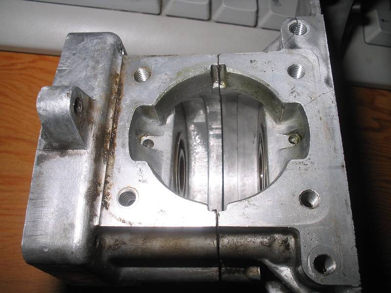

Andy,
On the Tanaka engine, if the cylinder transfer ports are matched to the crankcase with the exhaust/carb in the side to side position, rotating the cylinder to a front/back position will block the transfer ports unless the crankcase has cutouts in that position.

Will,
That's a good point but this is another reason why I love this little engine. The transfer ports are part of the cylinder. They go along for the ride if you decide to rotate the cylinder to any position on the compass you want. Neat. I'm anticipating that with the intake and exhaust oriented front to back, the bypasses will be in a much more suitable position.

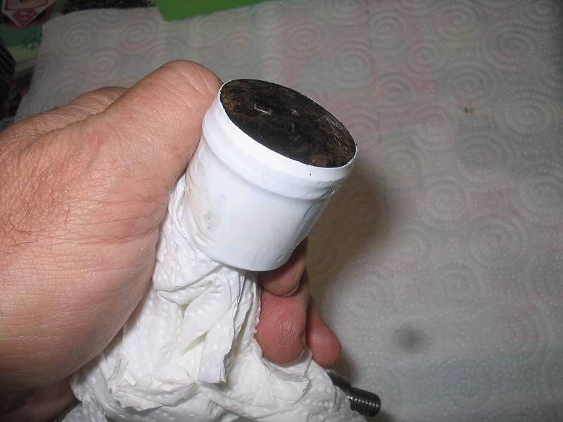

Despite the low mileage on this engine, there's LOTS of carbon on top of the piston and at the top of the cylinder. It reminds me of the Norvel when I ran that heavy DinoLube. Don't know what the drillers used for oil in this little guy but what if they used one of them new, BioLubes that are about to explode on the market in a few years. [X(] NO carbon implies much less pollution going out the tail end. If I had another like this, I'd look at the condition inside, and then run the engine on our OliveLube and gas and see what happens. Can't do that with the other two engines as the electricals are stripped off. Unfortunately, one of these also has a scored cylinder. Good for parts.
But, aside from the anti-freeze/Crockpot procedure is there any other chemical way to get the gunk off the parts? Not the carbon, the dried, cooked, god knows what on the outside. I'm contemplating anodizing the engine black,, or gold,, or,,,,

That’s one fine looking motor. I think the crankshaft and rod look much stronger that my suggestion of using a Ryobi string trimmer motor. The only two good points about the Ryobi are the hemi head and they are often free, but you now have a much nicer engine that a Ryobi.

The shrink tubing was applied to protect the rings from contamination from the cleaning procedure which consisted of scraping the crud off and then using sandpaper to refresh the surface.

You are correct that the cylinder transfer ports are part of the cylinder. However if you will look closely at the back and front of the crank case you will see where the cylinder transfer ports mate to the crankcase. Slip the cylinder in one half of the crankcase in its normal position. Then rotate it 90 deg and you will see that the cylinder transfer ports are partially blanked by the side of the crankcase. Although it may run, the output is going to be significantly less because of the flow disruption entering the cylinder transfer port.
I have been converting trimmer and chainsaw engines for model use for about 5 years so I've seen the inside of these type engines many times. Even have a 21cc Kioritz converted to diesel. I'm looking foward to trying some of the no/low either mixes in it. Soon as I get some other projects finished and out of the way.

Hard to say what caused the rod wear. Note that this was not a rod FAILURE, but rod wear. When I did these rods, one, likely this one, turned out with a press fit of the bushing that wasn't as tight as I'd have liked. I have few good measuring tools and do this by feel. This one, I used Loctite red and this is supposed to cure a not so tight fit but here we may have a spun bushing. Tearing it down soon, will get back to you.

Yes, I had taken into consideration what you're referring to. I had intended on cutting new bypasses into the case and plugging the old ones as I did in the conversion of a Norvel to rear exhaust for use on a heli and a pipe. See the first picture.
BUT, another problem has revealed itself on closer inspection. What fooled me was that the cylinder is square, but the bolt pattern is rectangular so the only flipping you can do is left to right. In that case, still, in a twin you can have counter-rotating props with inboard cylinders and with the muffler outlet straight down for both. Well, just thinking ahead a bit. I'm mostly 1/2A and am getting a bit saturated. Seeing the potential of the Tanaka has got me thinking likely too big for my britches but don't we all dream, from time to time?

Found that Webra .60 rod. The piston end is fatter than the crank end and it looks odd but it worked very well. And note the slot on the crank end. A good idea that seems to have worked as well. There is no slop here except that which might be expected from normal clearance. And note that it isn't brass bushed. This engine saw many, many gallons for fuel over some six years. However, that was some thirty years ago and it isn't Schneurle ported. I'm fairly certain that it never saw anything but a castor based fuel at 25% as was the norm back then. Still,,,
