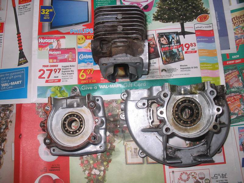

Looks like theres plenty of room and meat on the crankcase to plug the existing holes and redrill to a square pattern , is there room on the cylinder base to slot the holes to suit ?
To plug the holes use an aluminium stud and screw it in tight with loctite or an epoxy adhesive then cut and grind flush, after the adhesive has cured mark out and redrill and tap the new holes - it wont matter if the new hole is 1/2 way over the old , they should hold ok just dont have loose fitting threads, and maybe loctite studs into the crankcase for the cyl hold down.

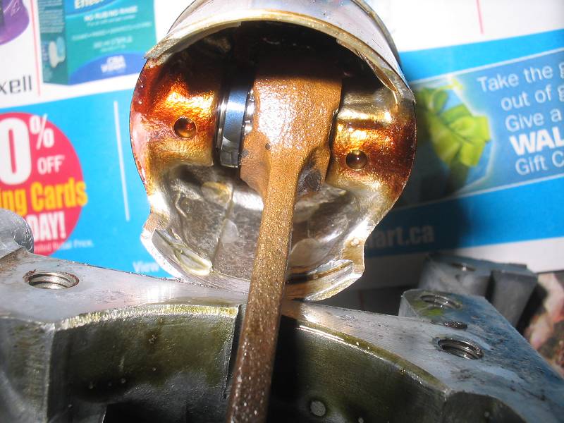

Hard to say what caused the rod wear. Note that this was not a rod FAILURE, but rod wear.
Something caused the wear. This is a failure. These are your choices in no particular order.
A. Poor construction. It looked good to me in the pics, but If the bushing spun and it was oil starved a possiblilty.
B. Overloading. Hard to say, the engine doesn't make any more power than it did before so this is unlikely.
C. Lack of lubrication. Potentially it happend when you were running the low lube mixes.
D. Lubricant failure. Potentially the lubricant wasn't good enough.
The only way to find out is to make more rods and run each on one fuel mix to see the results. That would be a lot of work, which is why I'm not all that interested in homebrewing lubricants. Engineers are good at that. And within a few years they'll be good at bio based lubes.

All good ideas and certainly doable. Will back burner that for now, though it would have been interesting to make up a rear exhaust just to clean up the front profile for cowls and the like. My first gasser was the one that started it all, the Quadra. I made up a muffler/mount using aluminum, rectangular door frame material. The top and bottom were plugged with caps with the bottom one having an exhaust tube. The rear exhaust flange of the engine needed just two more gaskets for a perfect seal with the exhaust going straight back and down. This gave me a muffler with huge volume, very quiet with no loss in power. I have conventional pictures somewhere that I'll try to look up. This was mounted to a big "Ugly Stik" that was modified to look like an ordinary airplane. Outlines changed is all.
I think instead, that I'll make up a conventional style, glow motor muffler but with the necessary baffles to make it quieter. The Walbro carb will be replaced with an Enya .60 or other carb.
I really enjoyed the big airplane with the Quadra and I've flown/run most other sizes planes and engines. If you know me, you know that I also enjoyed a LOT the smaller planes. Missing though was good throttling and full four channel control. Got that beat and needed a new challenge. Diesel did not come to me naturally but I'm glad I got involved. Plenty of challenges here and neat stuff to do. But I never did lose all my attraction for big, but heavy engines or expensive electronic ignition always held me back. And glow conversions? ****edaboutit. At 35 dollars a gallon for even 5%, well,,,,
But a diesel conversion? Now we talkin' turkey. Strip off all the ignition stuff and you get light. Eliminate any need for an ignition source and you eliminate expense. Eliminate ether and it gets even cheaper. Add an easily homemade oil and you get better performance especially with the latest mix that Reg has come up with. Olive might be best but peanut might be second, still acceptable and cheaper. Never know till you try. AND, because we have needles in the right places, what if we could run, oh, say, 5% or less, VeggieLube. Now that would be an inexpensive way to power our flying machines.

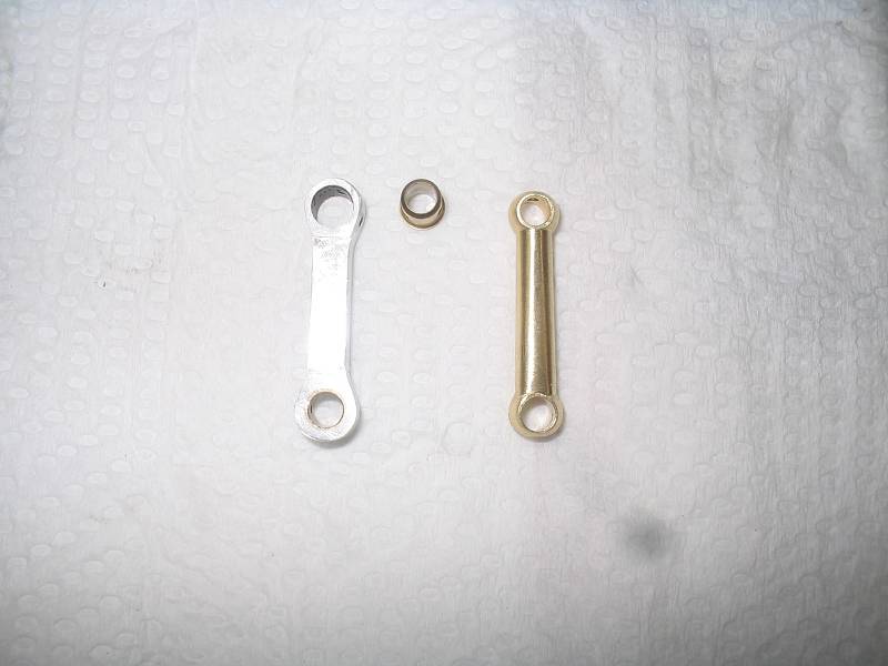

About rods. I've done a search for thin wall, seamless, smooth tubing. As luck would have it, Microgroup Tubing has just that as used in many instrumentation applications. Just need to find a size that, along with thin music wire as the needles, we may be able to come up with a very workable needle bearing set up for even the little .15. As we don't have high RPMs to contend with, we can make the entire rod out of brass. The extra strength will help where needed and the extra weight, where not needed, can be trimmed off. This allows the tubing to be press fit in place. The needles will ride directly on the wrist pin and the inner bore of the tubing. Full complement and full floating. The tubing, by the way, has a wall thickness of .5mm or .0196. Along with .01 needles, that still makes a fatter dog bone but I checked, there's just enough room. The tubing is available in a variety of materials, will call the company to find out which is the hardest and most suitable for this application. I'll bet they never had such a request before.
But there may be an even simpler, cheaper way to make wear at the wrist pin a thing of the past. It'll take some serious R&D to prove out but if it works,,,,

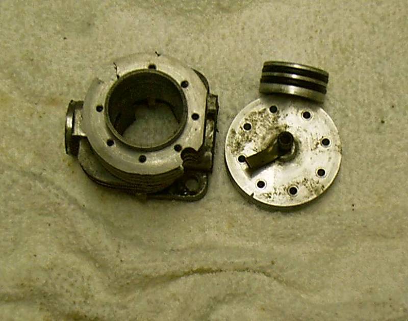

You had asked for some pictures on the Kioritz, however I don't have anything. I do have some on my first proof of concept effort on a Mac 21 cc. The engine was basically worn pretty good and I thought I'd try it out on it ratha than one of my "good" engines. I could only get it to run sort of on a high (30%) castor mix because of the worn rings. It didn't run very long before the crank gave out. It did show that there was enought material in the cylinder to turn it out and mount a conventional contra piston and head. The pictures are not very good, but you can get the idea of how I did it. The Kioritz was a little more difficult because it had an angled spark plug hole and didn't have as much material at the top of the cylinder like the Mac which had a center, upright spark plug.
I have been wondering if one of Motorboys ignitors might be the way to go. Cut down the cylinder base till you have about 10 thou clearance after cutting out the squish band from the cylinder head. Use the Ignitor to adjust the compression ratio. It would be easy enough to try.
Incidentially, on the Kioritz, I replaced the stock rings with rings from Frank Bowman. They are pinned, but made so that they cover the pin and have minimum clearance and thus minimum blowby.

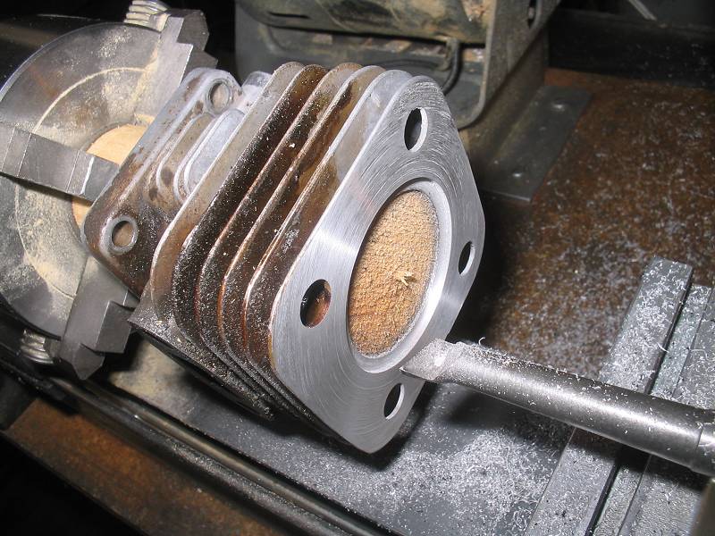

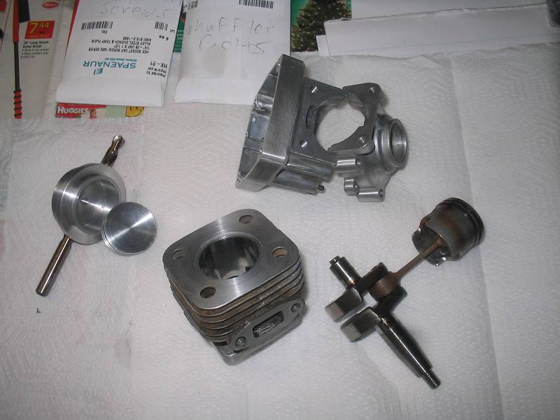

Have been unavoidably preoccupied for a while but I have made some progress. But first about rods. The needle bearinged rod has run into a road block. Hoping to get samples of that microtubing, my efforts to do so have failed. I even tried to bribe the guy on the order desk but no go. Minimum quantity and billing and all that.
So, I made up an all brass rod. If that one bends, well, I think that the crank will break before it does. Yeah, it's heavy but no spun bushings here and we ARE doing diesel so high revs not an issue. And so we have pictured, what I regard as rod failure, as opposed to rod wear. Not to say that the bushed rod wasn't HEADED for failure,,, Anyway,,,
Will,
Your pics of the dieselized Kioritz are appreciated. I think I see how you went about it and this has given me some ideas. A diesel head is in the works for the Tanaka, some teaser pics included. What I really like about the Tanaka is that the rear case sports a perfect, four bolt mount. And the pattern IS square. So, eliminating all those spark ignition parts should give us a light, powerful engine. Sure hopeso.
And maybe some runs can be posted on YouTube before winter REALLY sets in. Hopeso there too.
But what's a Motorboys Ignitor?

Seems like to me if you had a bronze bushing on the connecting rod small end (at piston) and a needle bearing on big end it would hold up a lot better. Not Sure. Capt,n
#590
ORIGINAL: captinjohn
Whenever I have an engine that has a solid aluminum rod, (no bushings) the wear always happens at the piston end. At the crank end, we have much fresh fuel/lube sloshing around and with the pin rotating a full 360 degrees, lube distribution is quite efficient. At the piston, the pin only oscillates. Plus, it's enclosed by the piston skirt and not much flow can be happening there, I think.
