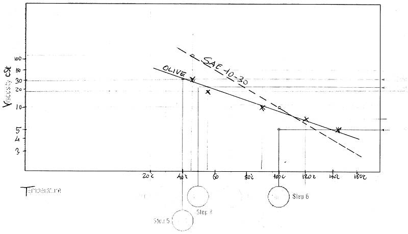

Here the first tentative numbers coming from the above olive oil batch
Due to the small differences between unmodified and modified oil, data are pooled in a single curve. The linear behaviour is confirmed as expected from the universal temperature-viscosity ASTM graph.
Note how olive performs better than (extapolated) mineral SAE 10W-30 at temperatures higher than 100°C.
The exceptional viscosity index, far higher than that from mineral oil, is confirmed as expected.
More to come
Ugo
More to come
Ugo
