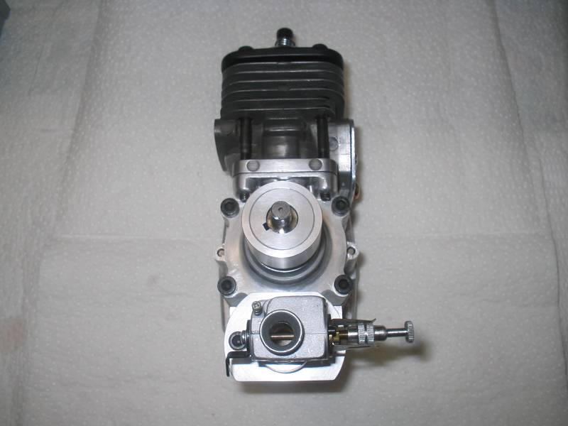

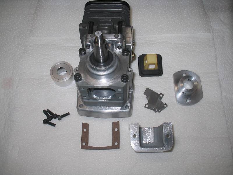

On the rebuilt and modified Tanaka, I added a reed valve intake directly to the bottom of the crankcase. We all know that these engines, these days, are sideport designs and the carb has a fibre/plastic intake block between it and the hot cylinder. I believe that's to prevent vapour lock. At this point I'm considering just hacking up my good Tanaka but leaving the intake as is. Only this time, I use a stock, RC carb from my Enya .60 and also leave out the insulating block. The idea is that the hot carb will vapourize/atomize the incoming, thicker, BioDiesel fuel charge.
