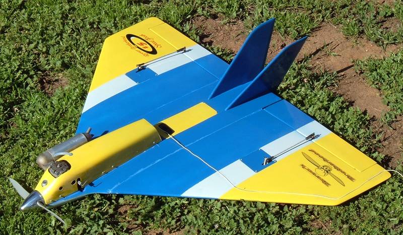

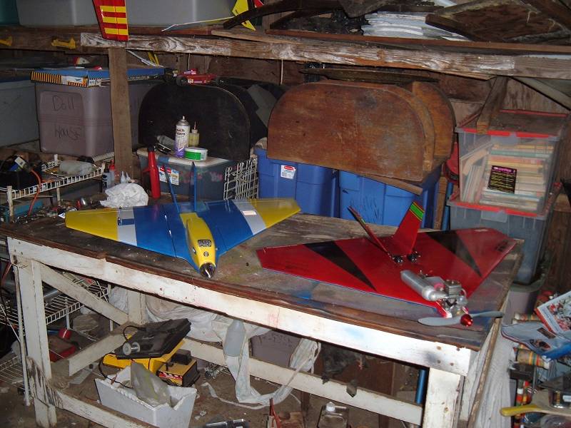

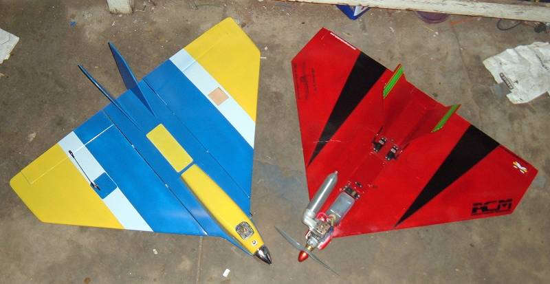

Some more progress tonight... I don't remember exactly what all I did or what happened but I can tell you it is structurally strong! I tested it against my big Margarita glass! (see pic)
Also see pic compared to Whip.
More to follow-

That looks great Razor! If I had to pick between the two, I'd have to say that blue and yellow looking thing looks so much more classy than the red one does.
Looking forward to hearing about your flight.
Russ

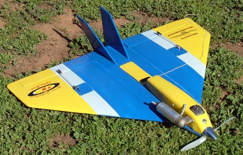

pics-

Looks good James [8D]

Nice stickers bro,
Bring it out anyways. I would like to see it.
