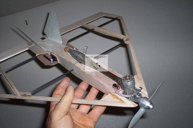

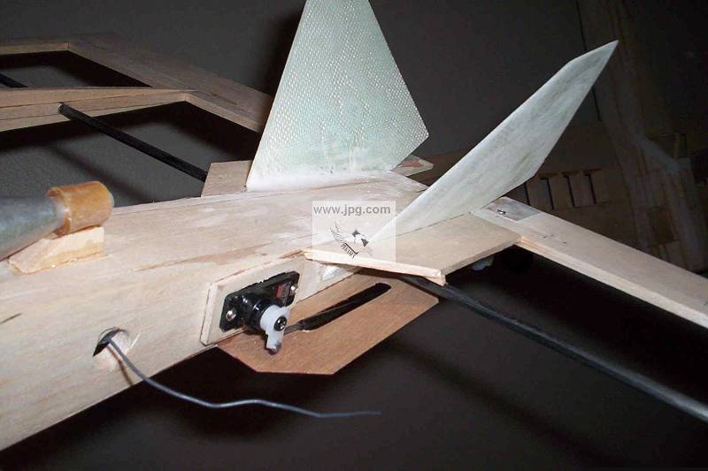

Here is a project for a GZ .061. This engine turns a 4.2x4 prop about 36,000 on 15% nitro. With higher timing and more nitro it can turn 42,000 with the same prop, but replacing tiny engine parts every other run gets old. The RTF weight of this plane will be less than 12 ozs and I believe there is over 24 ozs of thrust on tap.

Real nice combatpigg! Looks like a lot of head scratching went on during the build. Two comments, the control horns are on the bottom, can you put a small skeg/guard on, or remove any extra horn below the clevis for protection during landing? Are you going to seal the contol rod pass though so that the wing won't inflate and blow-up the ultra coat?
I bet that little thing will Haul A**, I hope it's bright and you've got good eyes!

FF, You bring up a point I had not considered, the wing getting pumped up through the slots. A couple of fairings would help with that. These 11 oz. planes when they land don't ever find dirt [unless you hit a mole hill], so the linkage on bottom will be OK. The main concern is heat transfer from the pipe to the radio compartment and also keeping the fuel cell padded so high frequency vibration doen't work pin holes into the fuel bladder. Even though this engine is running below what it can, the piston is still making 600 trips per second.

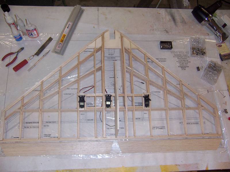

This is my latest home improvement project. It is a Wild Wiz 40. So far so good and really a quick build.

I will probably put a magnum 46 in it. I have a new one ready for something. Rick at Haslam Hobbies suggest a 32 SX being ideal. I also have a Magnum 52 that I am breaking in on a Dominator that I am going to put in a Diamond Dust. It will be here mid week. One of these days I am going to own a Jett.

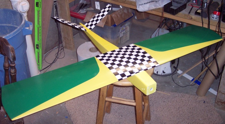

Ah yes, it was a nice looking bird wasn't it.. Oh well, all good things come to an end.. When I ordered it I actually gave Bruce creative license on it.. Just told him the colors I wanted, the rest was all him..
Here's my latest racer.. Tried my hand at painting checkers.. It's not hard but pretty time consuming.. It still needs to be cleared but I'm waiting on the weather to warm up a little..

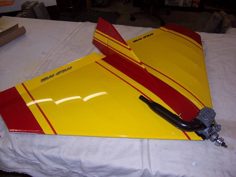

The Wild Wiz is almost there. Just got to install servos, receiver and fuel tank.

very sharp!

That is really a nice looking whiz, they are so easy to build and fun to fly they are hard to beat, good luck with it. Mine has a Norvel 25AME with a moose can flies great.

Thanks. This my first Delta. I'm hoping to break in on it ("break" maynot be to best choice of words). I have a Diamond Dust kit to start on next. Maybe this WW will get me somewhat ready for it.

That WW sure does look clean........I'll bet it is a lot of fun, too.
