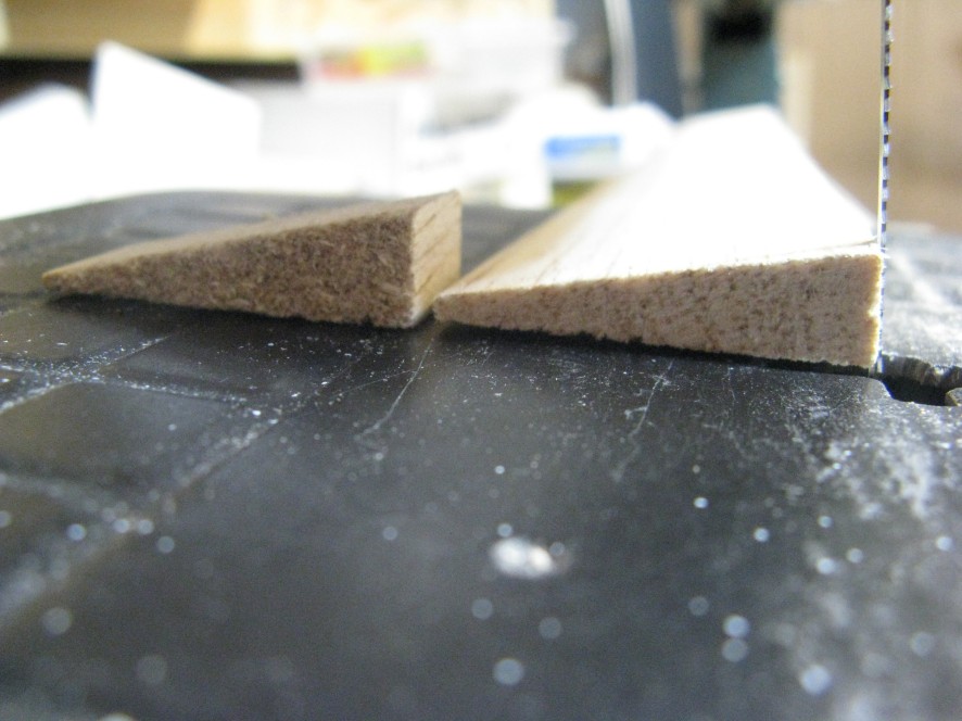

Har har, I got the cowl plug all done, the second mold layup is next on the list, as soon as the PVA is done drying as it is doing right now. So far so good.
So.. with the bench (partially) cleared, the Screamin Demon .65 project is back in the spotlight. In the meantime I fiddled with the engine mount and firewall, trimmed them to fit the engine and intake, and cut spars and ribs. And run the engine a few times, I think it will pull the aircraft okay from the sounds of things [>:]. My crude method of caging it on the front of the delta is evident here, note that at this point it's all just push-fit together to stare at. I'll tie everything together solidly after basic assembly. I'm hoping the engine doesn't just tear out the nose first time I throttle it up.
If this goes well, will it fly before the snow does..? Never know.

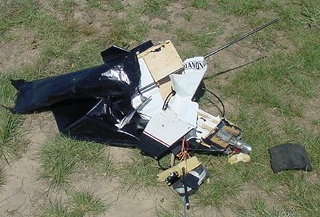

I doubt it. Here is a 1/8" ply engine mount that survived 120 flights and this crash. Beside that, I am sure you are going to strengthen the entire area with you monster engine.

I laminated three 1/8" ply motor mount plates with 6oz glass/epoxy between each layer and on the outsides. This made a nice 3/8"+ a bit thick and very solid beam mount. I'm tying it all together with some extra spar material and a couple of little mods here and there. I'm taking progress pics but too sleepy tonight for any more up/downloading plugging things in and out crap.. manana, manana. I think it will work, and there's room for everything too. The only big job is one more cowling plug and mold, but I'll try to make this a production prototype and therefore useable for any Demon. I didn't change the exterior envelope at all on this one for that reason.
The small block SE engine/tank cowl mold is curing overnight, then tomorrow morning I tear it apart, hopefully successfully. I get the first one, I get the first one, tra la la la laaa laa.. [sm=lol.gif]

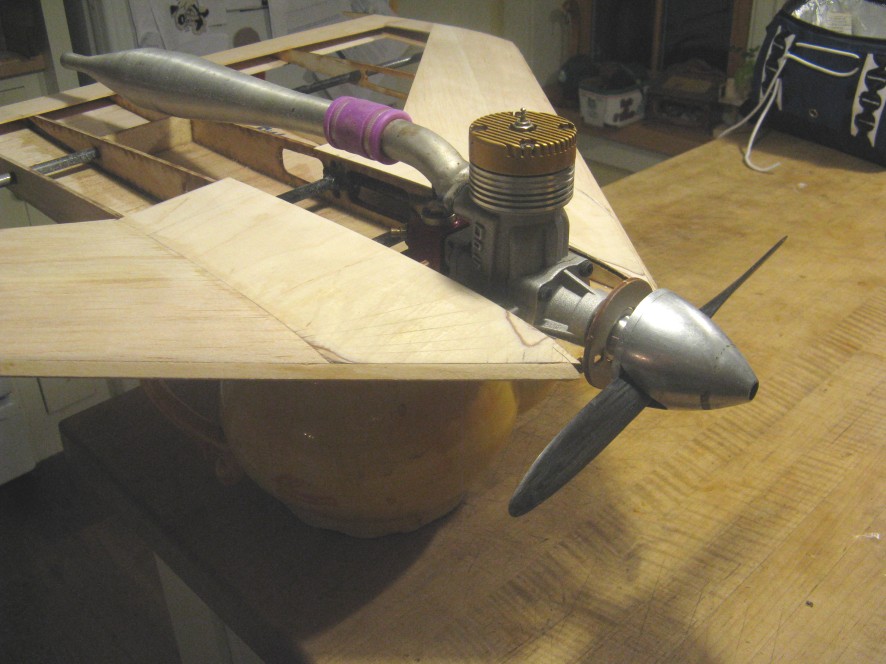

Progress pics.
The middle spar will be cut out in the center bay to make tank space. The rest of the gobbledy gook is mostly to recover that lost strength, add a bit more, and add solidity to the front end. So far I am happy with it.

That looks great!
If you limit the flying to big, open, back and forth passes, there isn't that much stress. It's absorbing the vibrations and sending those bad vibes out the wing-tips, giving that junk the path of least resistance. I believe it works something like electricity, same goes for the shock waves of impacts.
I think applying some FG to the spar / rib intersections is worthwhile, and also to FG the ends of the spars to the perimeter of the frame. I just did a post mortem of an old DD and those areas were still mostly intact.

You're right, I'm not building this one to play flying circus. I have no intentions of trying full deflection elevator tricks or the like at speed, with the possible exception of fast rolls by accident or intent. So my biggest concern was integrity around the engine mount (that is an awful big chunk of howling, thrashing metal up there) and a means to distribute the engine loads/vibes about the framework somewhat fairly.
Since I have an abundance of arrow shafts I made a cradle you can see in the prev pics, and wrapped the intersections with carbon tow and epoxy. One shaft runs outside the center ribs and aligned with the engine mounting plate, rearwards between the two short spars behind the engine, and ties in to the front half-spar. This is epoxied and glassed to the ribs though that does not show up in the pic too well. These short lengths of CF tube are very light and the stiffness is tremendous, plus the tensile strength is off the scale. The engine plate is a 3/8" thick laminate, and well trapped within the rib structure. If it comes apart I think the piece that hits the ground will be the engine and the center rib assembly as an intact unit, with Dacron bags of shattered parts flapping in the breeze on each side.
I plan to cover this with Stits fabric, so the whole airframe will be cocooned in a drum tight skin, and in addition I will epoxy-laminate the fabric to the exposed sheeting for skin toughness and abrasion resistance. It will be one tough little bird when together, I think. The torsional strength and stiffness should be impressive, it barely flexes as it is and also based on my #2 bird results. The fins will be carbon/glassed sandwich of 1/16" balsa - 1/64" ply - 1/16" balsa. The airframe in the last pics is up to 325 grams, and I weighed it a bit eariler with the engine and pipe together for a reading of 1050 grams IIRC. So even if I added a kilogram with tips, covering and radio, tank etc., which I think is pretty unlikely, it would end up at about 4.5 pounds. I know it will fly at that weight, launches notwithstanding, and land at reasonable speed. So I'm encouraged so far, and I hope to come in closer to my original 4 pound or so fantasy. Curses, just had an hour break to clean the kitchen and get started on dinner, and all I wanted to do was get back at it. I do enjoy those fleeting times when a project is interesting enough to me to be that absorbing. Two 2:30am nights are taking their toll though, I really should shut it down earlier.. And dinner seem lately to be chosen exclusively from our list of fast-fixeruppers for some reason.
