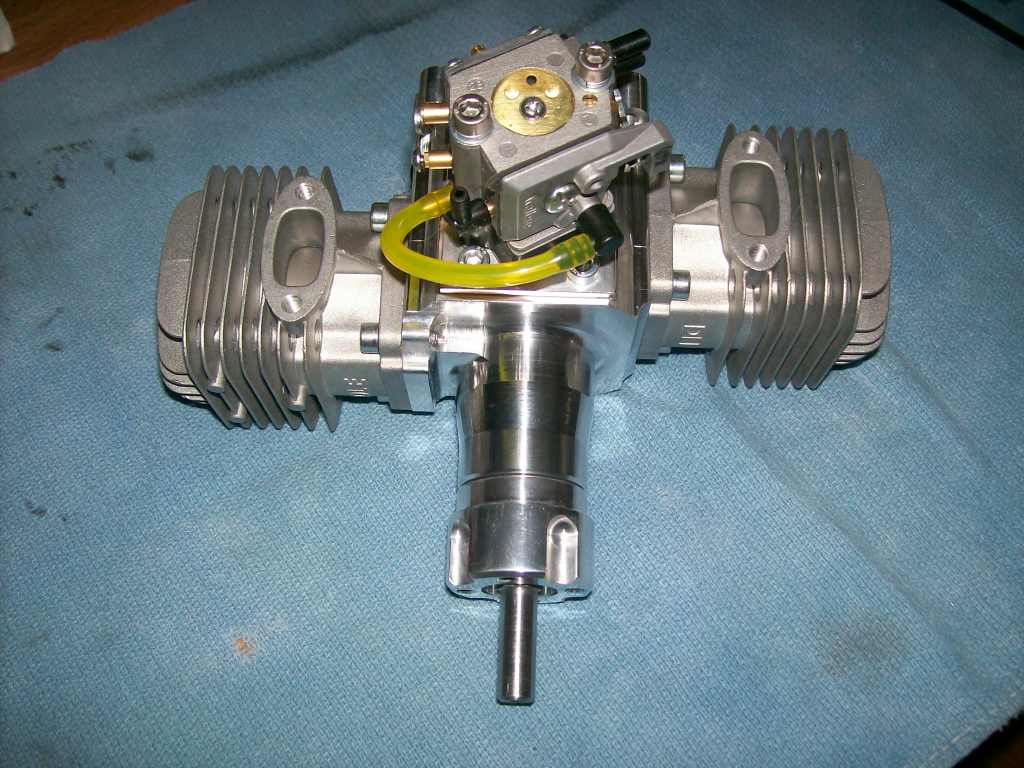

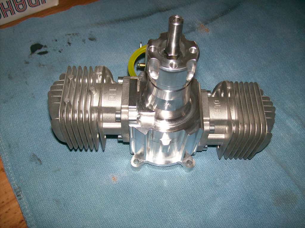

Hi guys I was going to wait a while to show this after I had some numbers to post, but that will come in a week or so.
Here is my latest creation a 60 CC engine useing DLE cylinders and pistons. Mind now the engine will be fully polished and the cylinders either painter or powder coated when completed, but this will give a person the general idea. As it is the engine is weighing in at 3-1/2 lbs I was hoping to keep it under 4 complete with everything but I have my doubts.

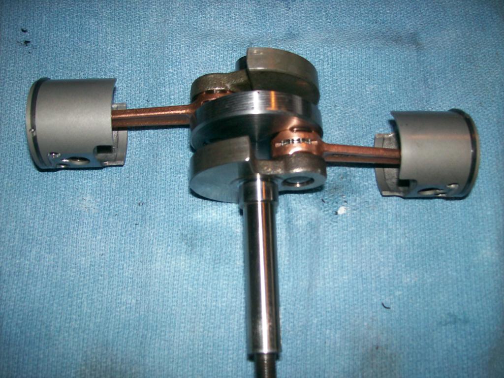

what crank and bearings are you using? Have pics of crank?  Is that 6061?

As a rule I get my bearings from USA bearings 10 at a time, the crank I made from 2 dle -30 cranks, it worked out very nice.

Thanks Guys for the kind words, Since there has been alot of intrest in the crank I decided to take a pic while I have the engine down. Nothing magic to it except getting it aligned so there is zero run out. What I did was cut the end off of one and added a disk in the middle, removed the original rod pins and replaced them with longer hardened metric dowel pins that would capture both the disk and crank.

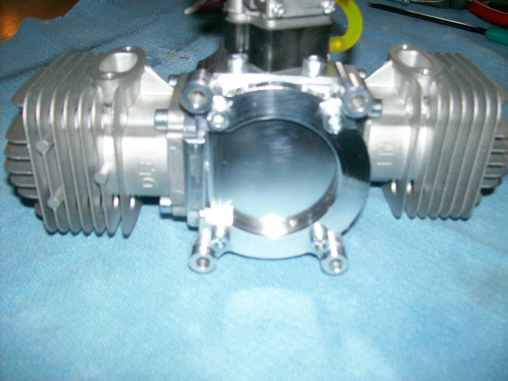

HI guys /Gals Just a couple of pics to let you know I have not forgotton about this thing. I recieved my Mufflers from Taildragger RC today the CCRC pro was an exact fit to the DLE cylinders. I want to take a sec and thank Chad for a very fast shippment and some very nice item's. My ign has not landed yet but it should be here I hope tomorrow, I decided for now just to tackel one thing at a time and went with the standard CM-6 plug caps. That may change later on but for now it will get the engine running and see what I need to work on from there.

Correct me if I am wrong, but you machine this manually, no CNC right?

Yes I use all manual machines.
