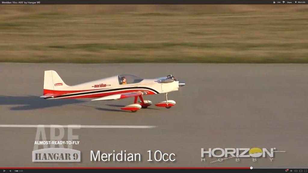

I just saw the video, and was interested to see what the airframe looked like after a flight. I got a screen capture and came here to announce the video was up but I got beat to it by Dave!
Anyway, we can all look forward to the engines black goo really cleaning up its act after awhile!
