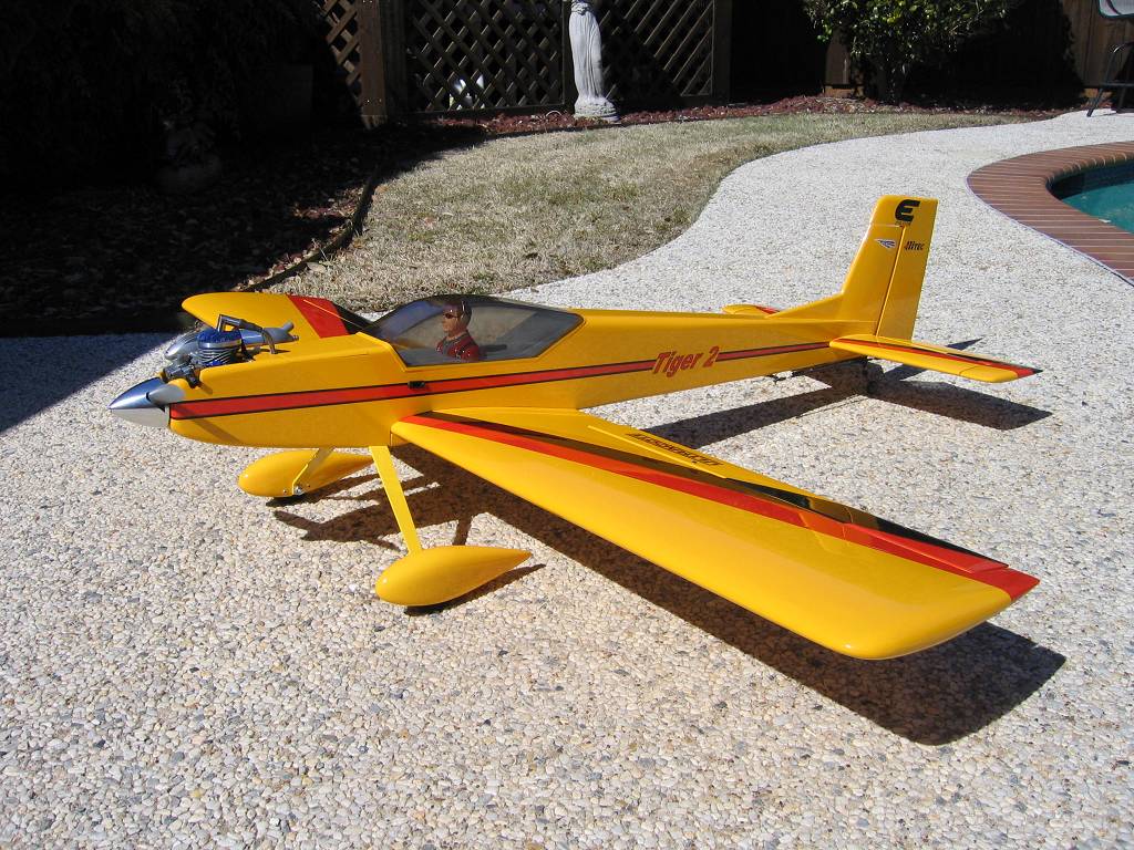

I flew my Evo powered Tiger 2 for the first time yesterday and this engine is very impressive. Runs and idles perfect while jerking this 5 lb. 14 oz. model around like nobodys business. I'm using the Tech-Aero IBEC and an 1100mah A123 battery. Only used 120mah per 10 minute flight. I must say that I'm a little disappointed in the muffler. It leaks like crazy, even though I assembled it with Permatex High temp sealer. I've taken it apart, cleaned it throughly and reassembled it using even more sealer and blue Locktight on all the threads. If this doesn't hold, the muffler will be replaced. The engine is also soft mounted on a Hyde style soft mount which all but eliminates vibration. Happy camper here. RS

Love the color scheme Russmall.
That and the landing gear so change the look of that plane in such a good way!
I am so steeling it for my next project.

Go with a mac muffler and problem solved

I used copper RTV from the start and have had no leaks from the muffler and I'm nearing thirty flights and my first gal of fuel.

Thanks Twin_Flyer, steal away cause I stole it from somebody else, LOL
airborne2.4, I will go with a Macs muffler if I have to replace the stock unit. Are you using the #6720? I found it on Macs website but not at Tower.
AA5BY, That's the same sealer I'm using. Glad it's working for you.

was that a kit or arf..i like yellow planes,somehow end up with yellow..

It's built from plans. My friend bought and built the kit, then made a copy of the plans for me. I used cub yellow because for me, it's easy to see. RS
