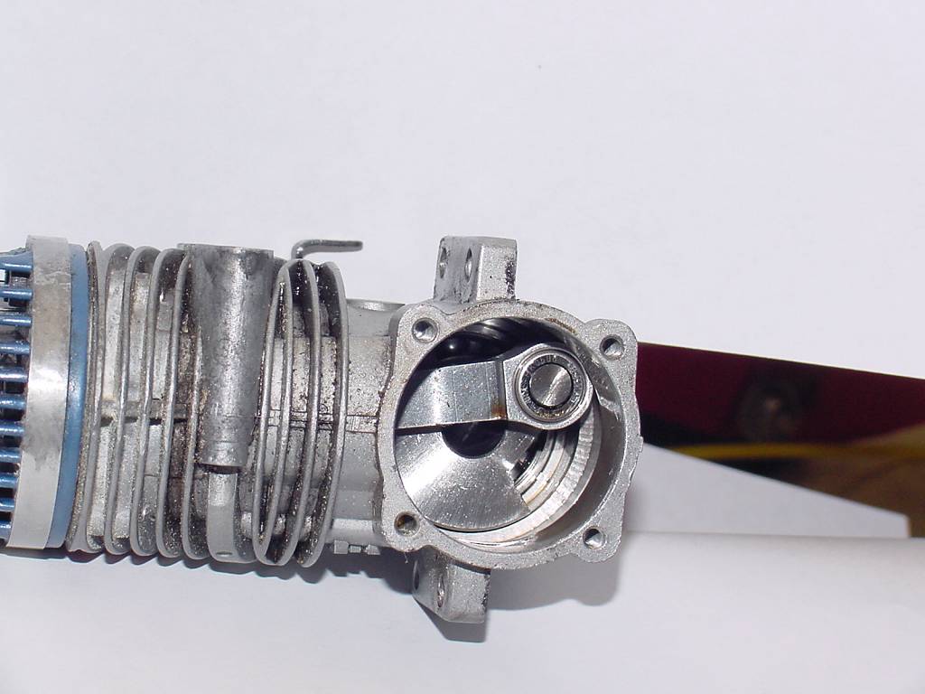

Pete from Horizon posted regarding my issue and said the rear cover can be removed without voiding the warranty. I'm going to remove it and take a peek inside . If it's the crank pin any damage/wear should be visible .
Old 05-08-2013 | 05:51 PM
  #1305
CiprianGugu's Avatar
My Feedback: (17)
Joined: Jan 2004
Posts: 188
From: Jamestown, TN
Default RE: New Evolution 10cc gas engine
ORIGINAL: flyinwalenda
Take a picture and post it for us to see, if you can.

I removed the backplate and it was clean inside. I couldn't tell if the crankpin is worn but it looks to be a bit irregular. I can see some slop between the pin and the needle bearing but I can also see a little slop between the wristpin/bushing too. The clicking at idle must be the movement (slop)of the connecting rod when under pressure. I can see and feel it move.
I also noticed what seems like excessive slop in the prop driver and the crank. Didn't look like any excessive wear on the crank, driver or key but there's about 2-3mm of slop back and forth . Just seems like there shouldn't be that much.
Here's some pics and there's really not much to see. Will require a tear-down to find out if anything is worn. Looks like I'll put the backplate on and send it in .
Brian,
You can't really see anything without removing the conrod. If this engine was mine, I would take a look there before sending it in.

I agree however Pete at Horizon said anything beyond removing the backplate would violate the warranty ....so.......I'll just send it in.
That could be the cause and more especially if the prop was ever loose for very long as that would allow the key slot to increase size from normal clearance.
I only had one backfire where the prop cam loose but it never started. All other run times the prop was tight.
