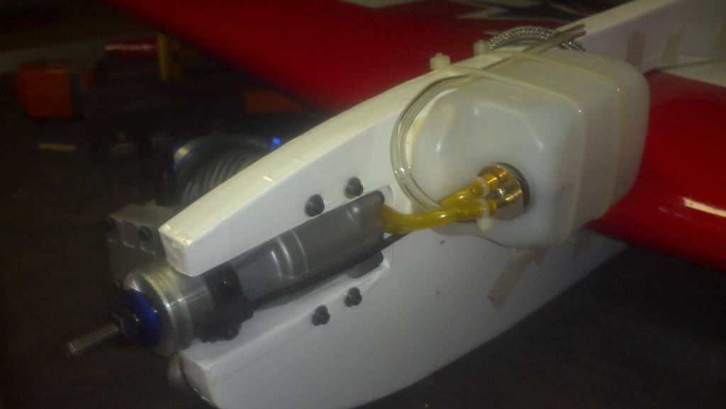

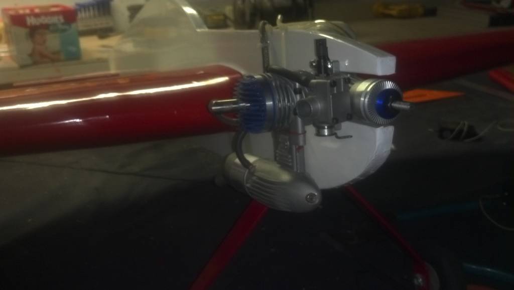

I got my engine mounted up and plumbed up. I am using a 6 oz tank since it fits better than the 8 I had laying around. I took the muffler apart and cleaned everything with alcohol and siliconed it up as well. The plane will finish out at about 5 Lbs 2 oz when done. I still have to attach the ailerons, elevators ect., and install all the linkages and servos. TheIgnition is mounted in the wing LE and is routed through a grommet for a clean install. The plug wire should be the only indication that this is a gasser.
Hopefully it will balance and 3D
