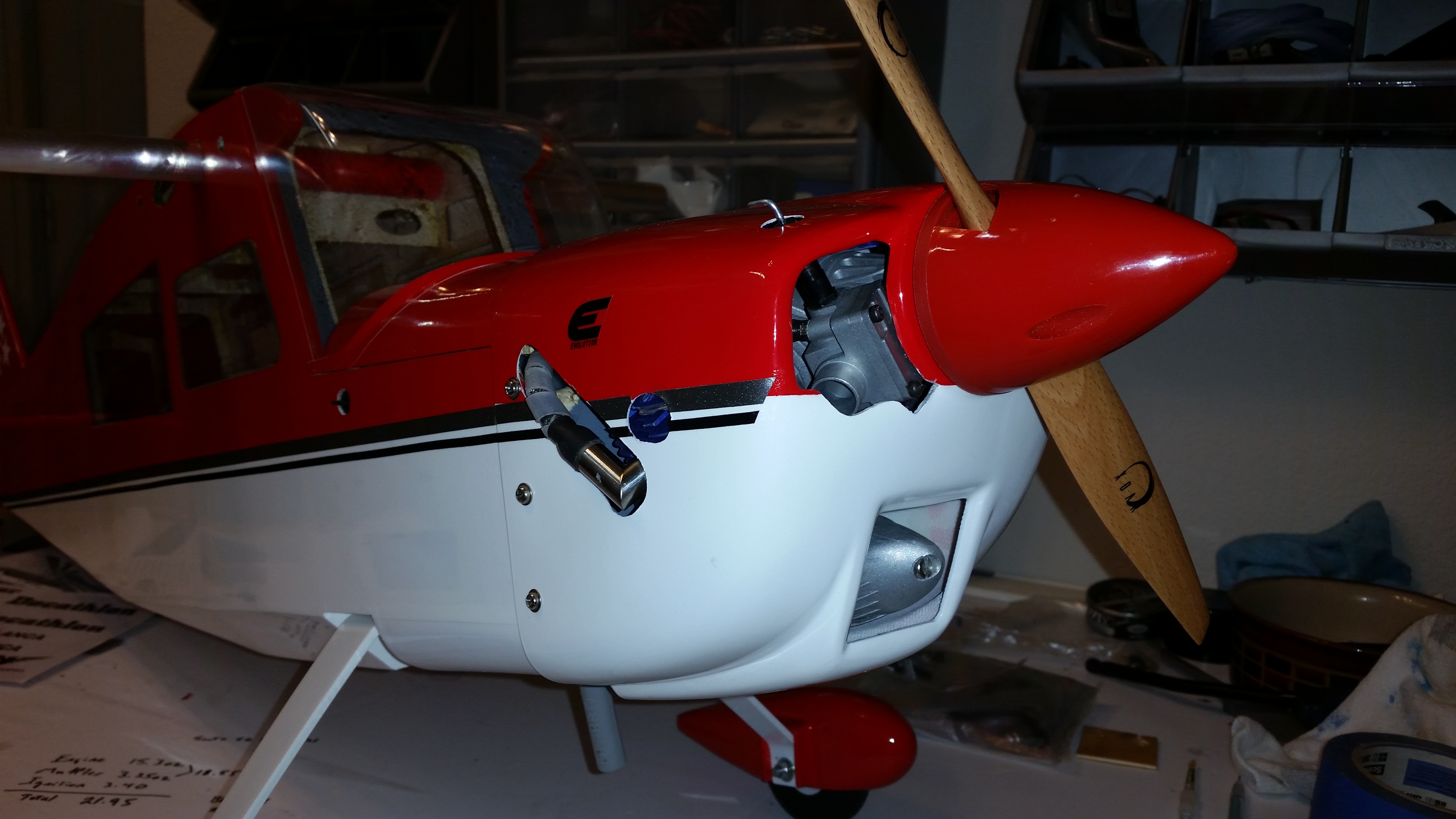

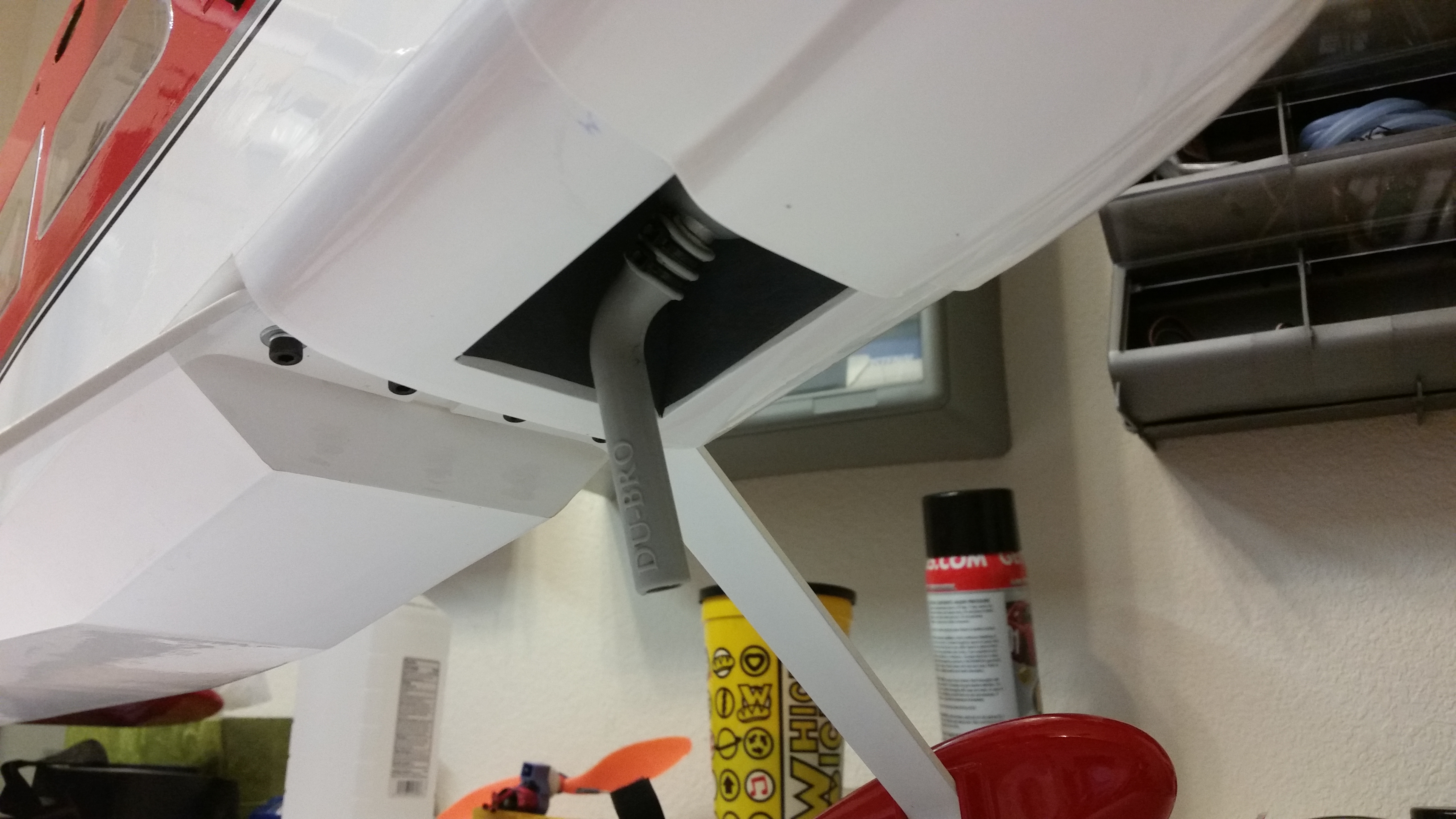

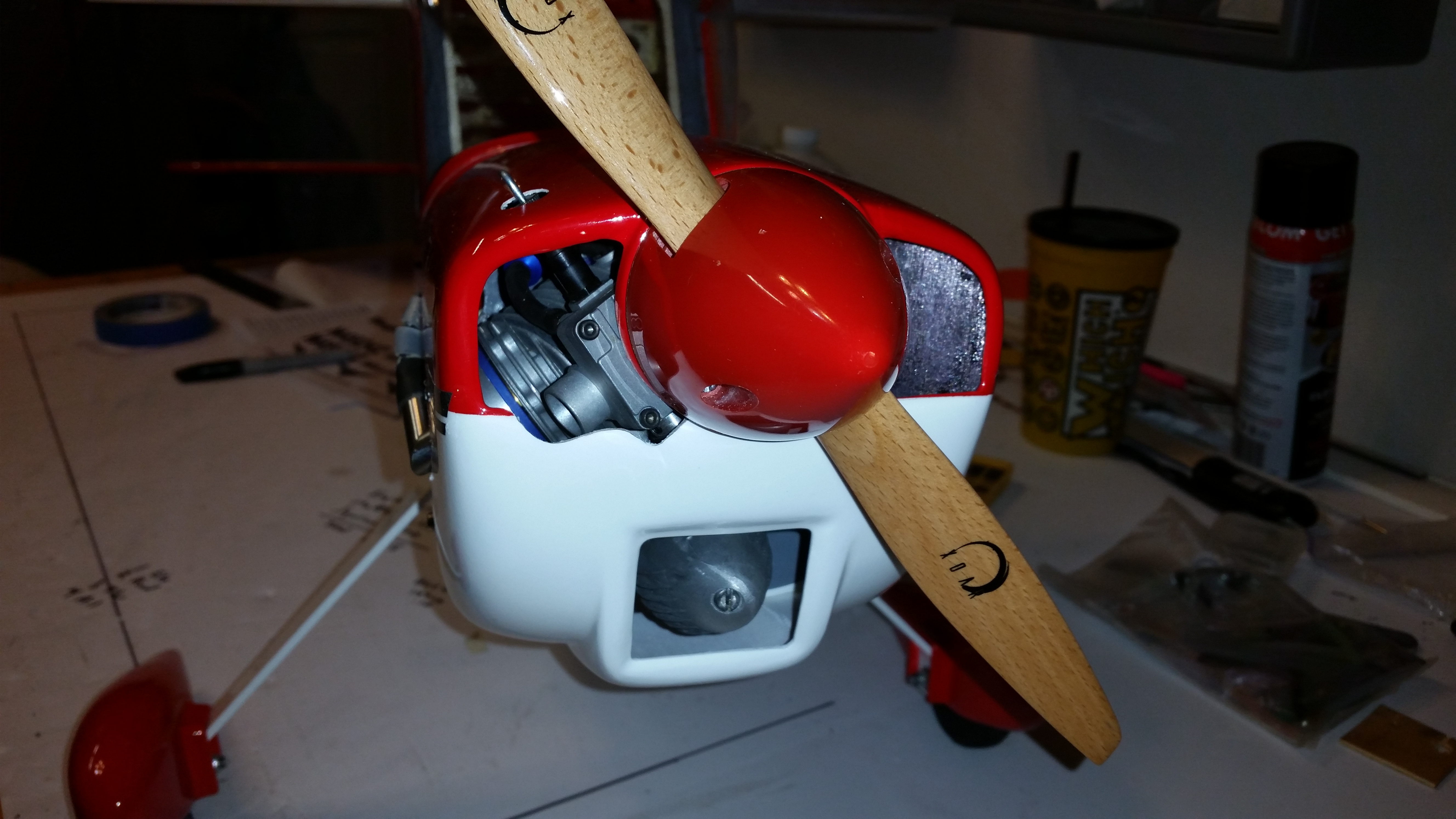

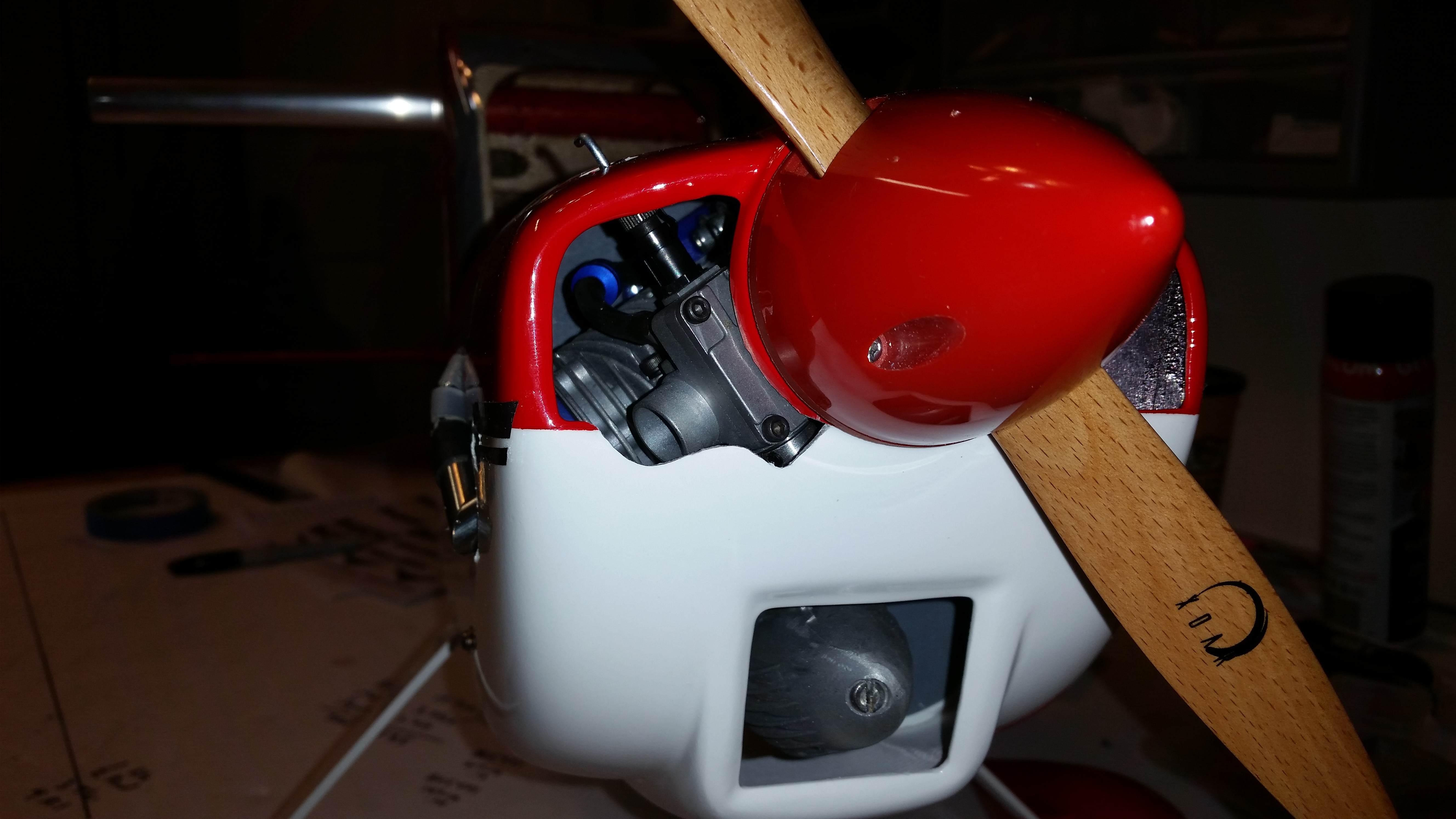

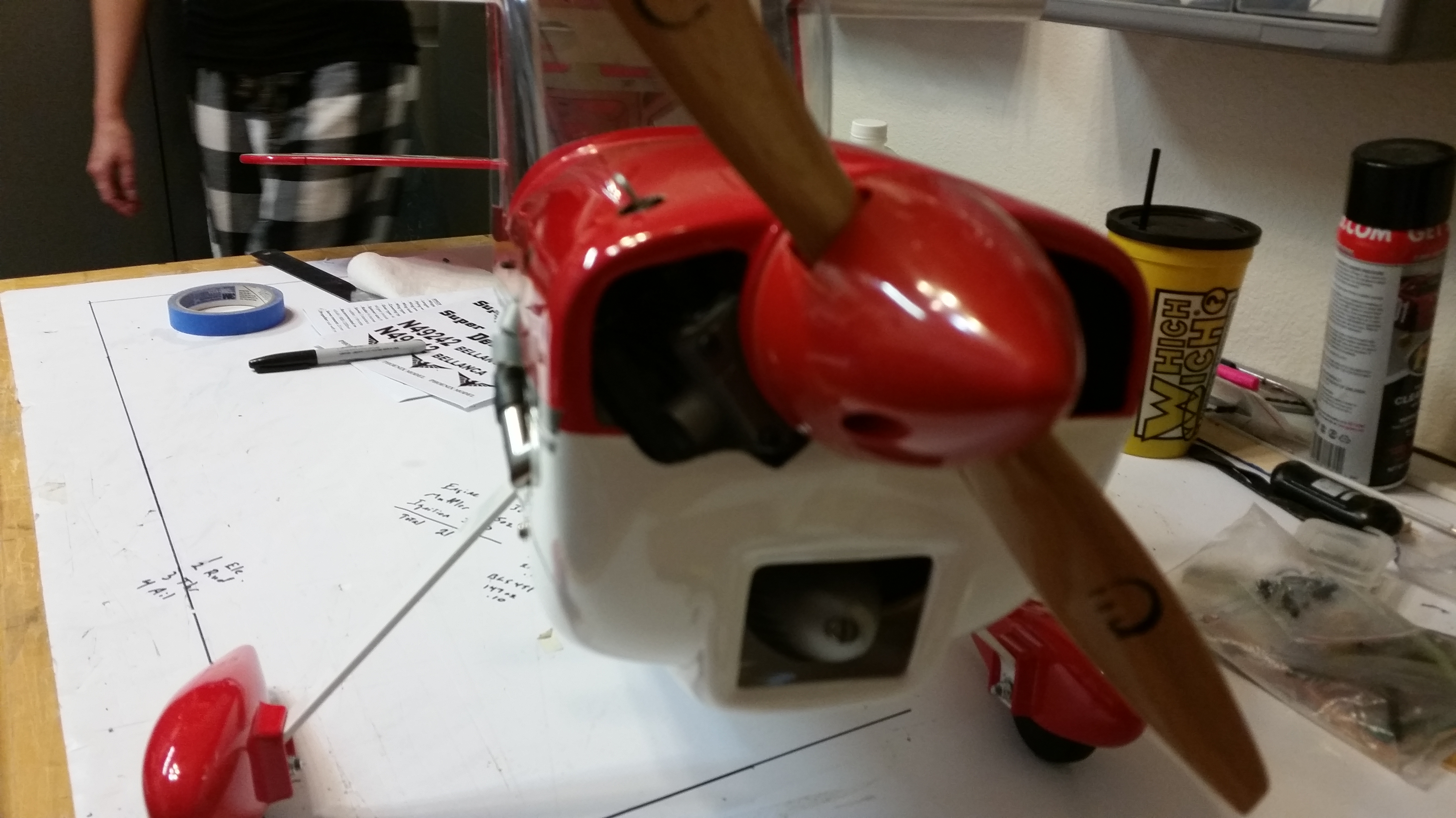

Well, so far I have only had a chance to run my engine once before mounting it in a Phoenix Models Decathlon. The airframe calls for a 46-55 2c so I am hoping that the gx10 pulls it along nicely but not expecting unlimited vertical either.
Anyway, the question that I have for you guys has to do with my cowl opening size and exhaust area. This is my first gas engine and I know that they tend to run hotter and need more cooling than equivalent glow. I have the off cylinder side of the cow set up with a baffle to direct incoming air onto the engine and the cylinder side opening has been opened up some to un-shroud the carb venturi. I am going to include some pictures. So do I have enough of an opening or should I do something else to the cowl? I really do not want to overheat it.

Old 09-17-2014 | 04:25 PM
  #1838
Joined: Aug 2008
Posts: 3,821
Received 20 Likes on 18 Posts
From: Waterford, Mi/Citrus Springs, Fl
I would suggest you leave the cowl off for a while, to get to know the engine a little AND too make sure nothing you have going on with the cowl is making it overheat. The experience of running without will let you know about any issues right away when you put it on. The idea of blocking the one side is probably a good one.
I have this same combo ready to maiden, but I went with the engine on it's side and a Bison Pitts muffler. Not sure I would do that again because the engine sits very high within the cowl. We'll see how it all works out.
Mods include rudder servo in back (for increased options when it comes to setting the CG), and carbon fiber tube installed in the really soft alum. struts. The rest of the package all looks good. It's right at 7lbs ready to go. Looking forward to the chance to maiden... -Al

The section of the engine that needs cooling most is the cylinder and ideally one should try to direct incoming air in and around the cylinder fins. The other area of major concern is getting rid of hot air from the exhaust as quickly as possible, hence the rule of thumb of having the exit hole 3 times the size of the inlet, not always necessary depending on the install but a good reference point.
Karol
Old 09-19-2014 | 08:10 AM
  #1841
Joined: Feb 2012
Posts: 65
From: Champaign, IL
Unfortunately the 3 to 1 rule is not a good starting point. Pe Reivers had a really, really good forum that had research, examples, and information regarding cooling of model engines (as well as dis-proving the 3 to 1 rule). I just noticed that it has been removed, so unfortunately I can't hyperlink to it. Sometimes it works out that the 3 to 1 rule will work in a particular installation, but it has nothing to do with the rule itself being correct. It is always best to use telemetry or testing when you begin cowling an engine to determine if you have enough cooling air moving through a cowl. Pressure differences cause air to move from one location to another. One good way to create a low-pressure zone is to add a ramp (or louvers) to an exit hole. This does not always make sense for a scale airplane, but it is an effective way to provide some airflow.
Keeping track of temperatures when cutting holes in your cowl is the best way to monitor the effectiveness of your cooling. There is no magical formula that will work for every airplane installation.
Jimmy

I placed an order for a few more temp sensors for the Eagle Tree system and I already have the remote dashboard that can be set to sound an alarm once a preset temp is reached. What cylinder head temp would you start to get concerned at? I already have the system installed in the airframe, I just need to hook it up to the computer and complete the programing and presets at this point and then it is ready to go.

Sorry for taking so long to reply. I would set your alarm to go off at 300°F. If you can maintain the operating temperature below this, the engine should be getting enough cooling. If it is consistently above 300, reconsider the cooling.
