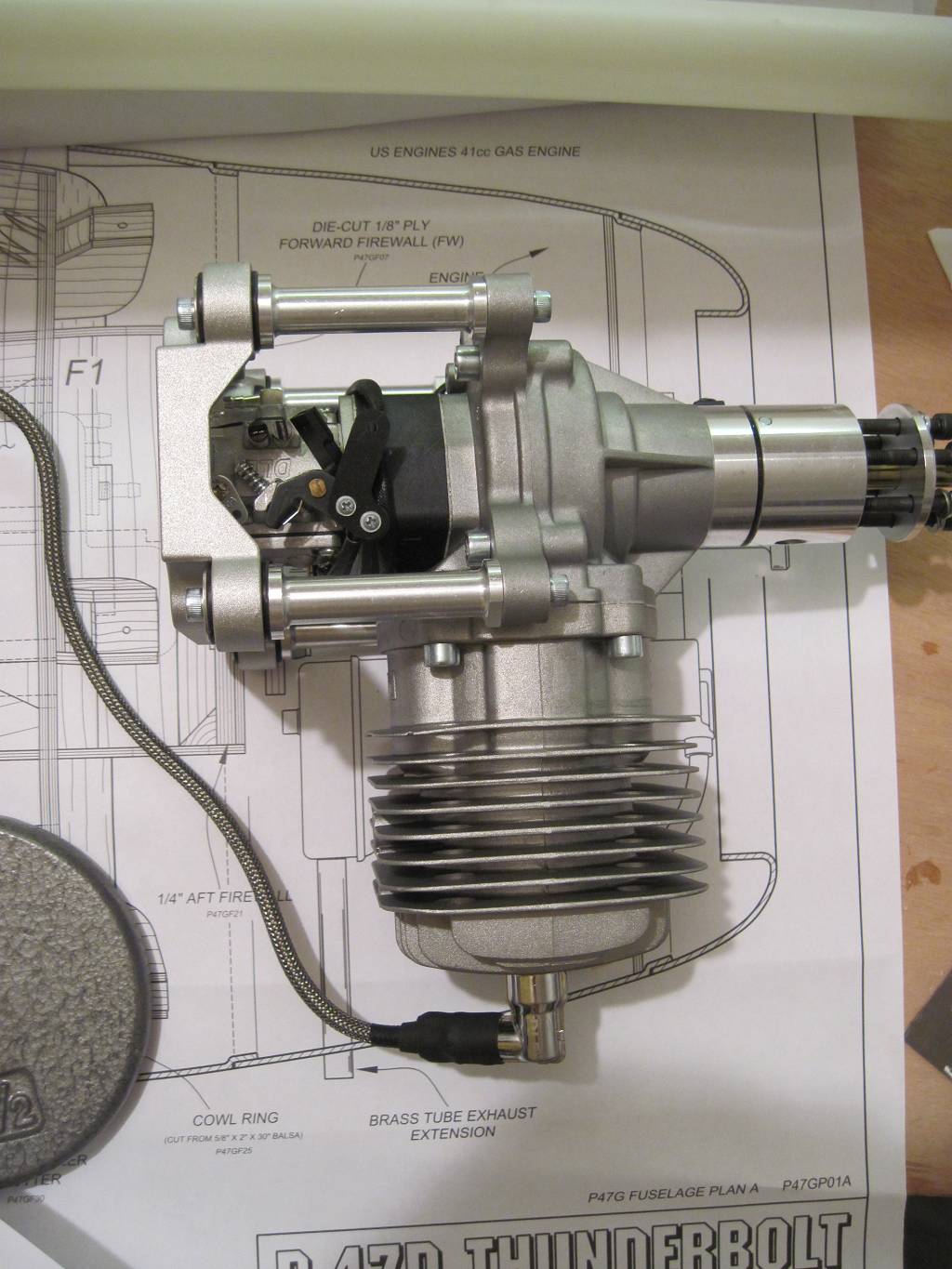

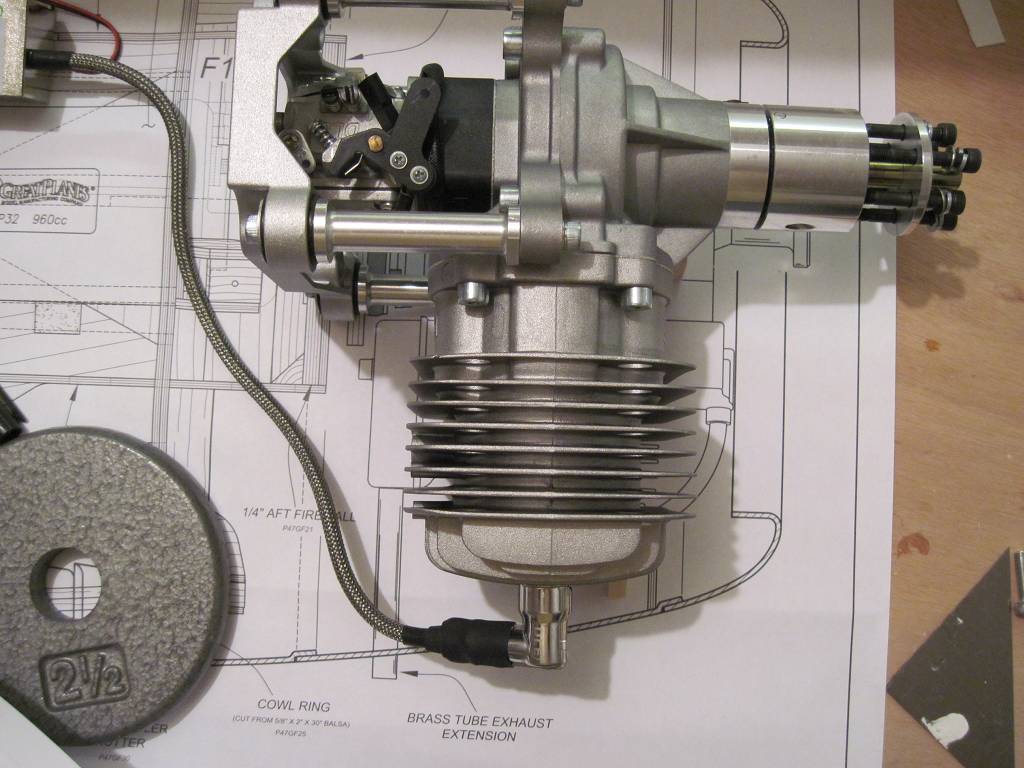

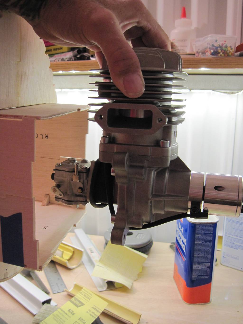

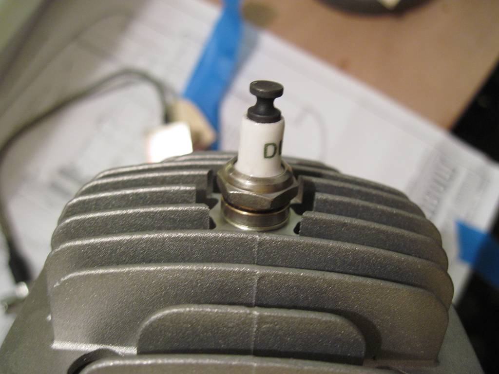

I just got my DLE85 and my first impression is that it is a nice DLE engine. I do wish they would have swept the spark plug back like the DLE55r, some builders like to stuff the larger engines in the cowls and use them for ballast instead of using a pound or two of led. The muffler is oversized and not really useful for those that are using this engine for there scale frames. Aftermarket mufflers will be available in a few months. I am building my own to fit my plane. I like the throttle linkage and the chock has two arms, one on each side for multiple choke linkage. I like the ISO mount and we will see if the bushings last. I’m sure they can be replaced during maintenance. So far I like the looks of this engine.

the iso mount is impressive,I machine radial engine mounts for all my war birds,I am not a big fan of stand offs,to much flex for me.just a thought.

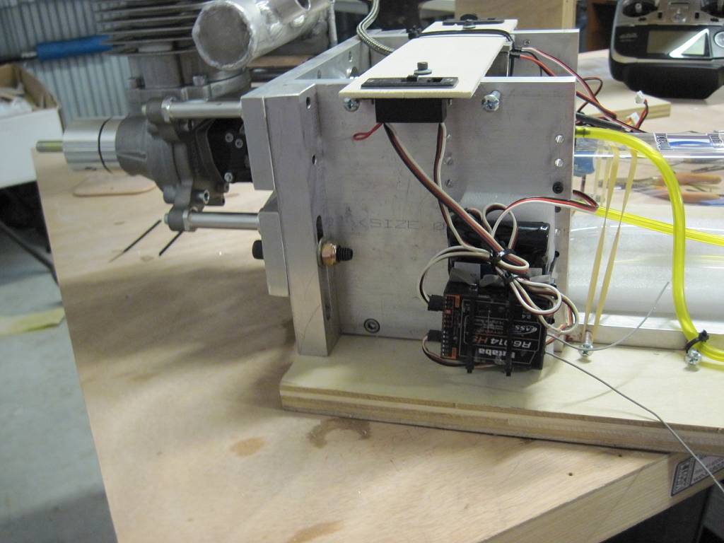

On the DLE85 mounted upright there are two nipples on the carb one on the top and one on the bottom. The manual says nothing of these or witch one is the gas in. Or what the other one is for, can anyone tell the answer please. I am planning on doing a test run tomorrow. ThanksTB

The one on the side pointing up toward the cyl head is the fuel inlet.
It appears the other one is for carb reference pressure.

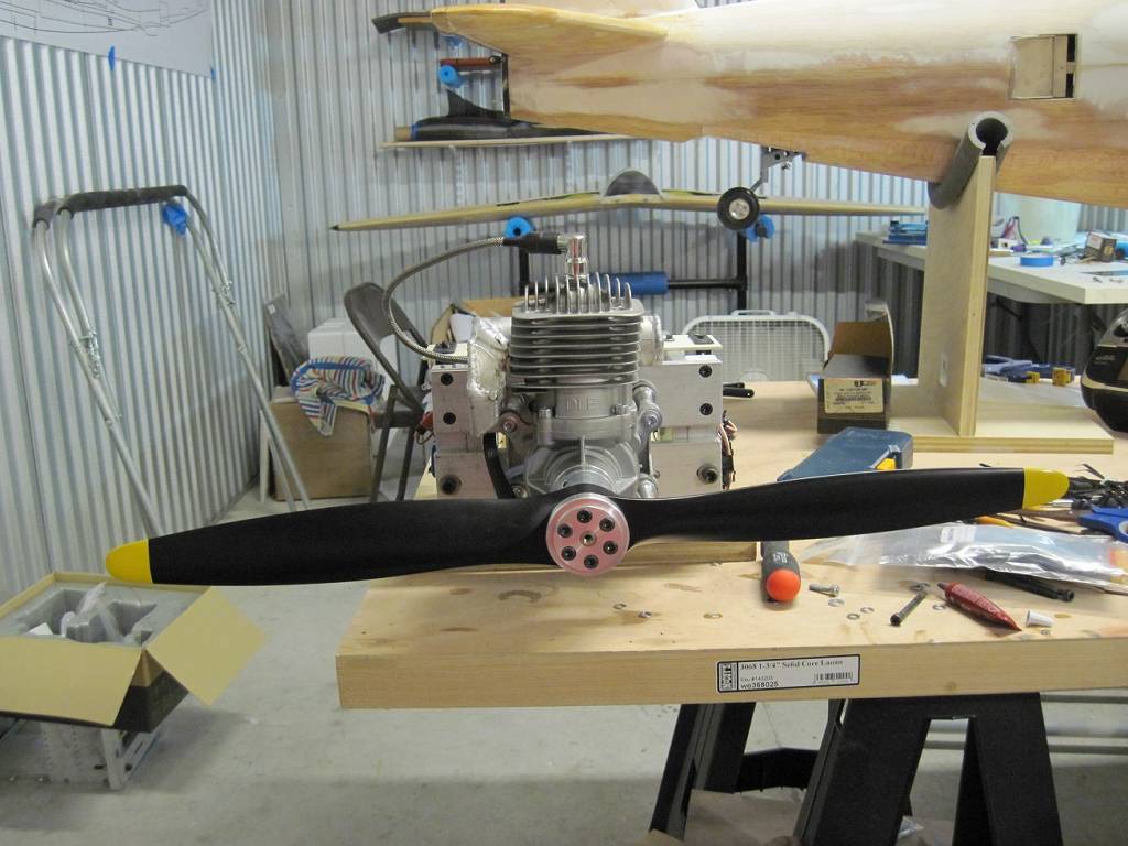

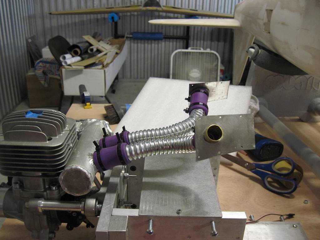

I was guessing that but was not sure. I will be testing today and later in the next week or so with a 22x10x4 blade prop. For now I will be testing with a 24x10 and I will be watching the rpms to keep them under 6000 + -Is there a need to put a hoes line on the carb reference pressure nipple?

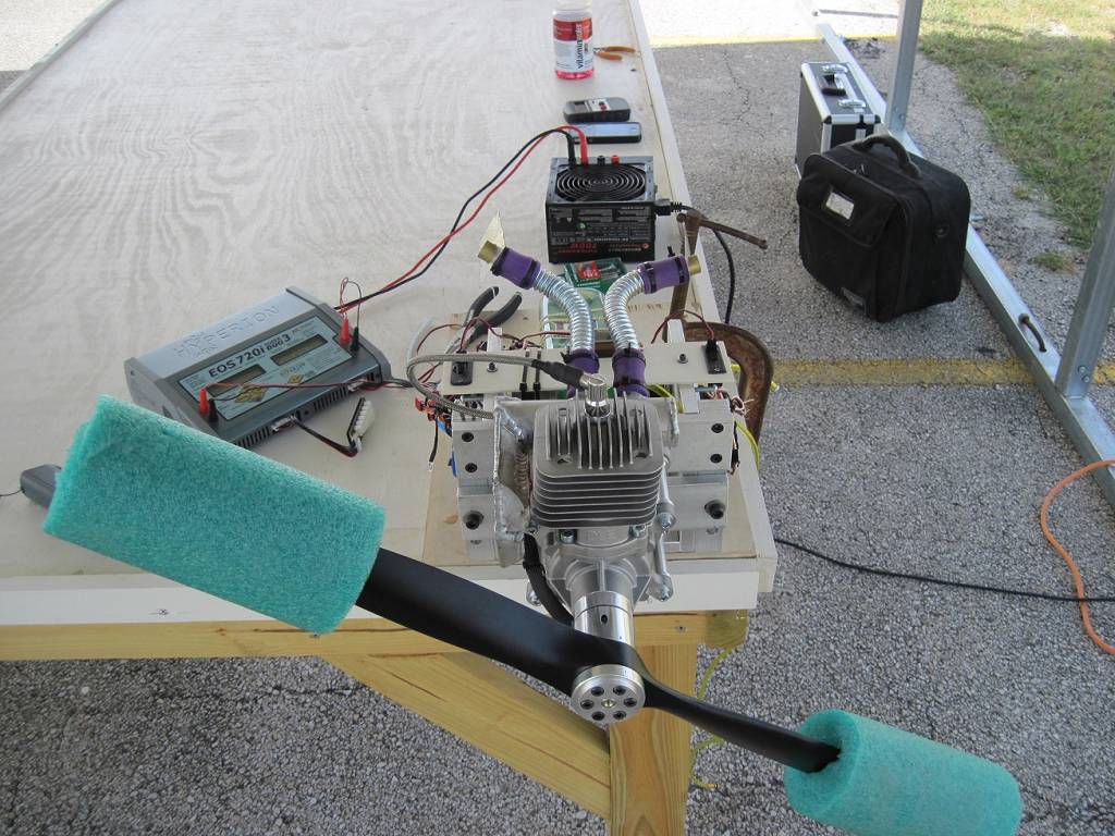

I got the first test run in. Today was more about my muffler then anything else. The muffler was strong with no problems and the exits held up. I wanted to get some heat readings too. The exit plats reached 150 max. In the air they should be cooler. The engine ran flawless. Started right up and I kept it between 3000 and 6000 rpms. I am using a 24x10 so I am governing the rpms at 6000 for now. Next week I will run the 22x10x4 prop.

It looks like you know what you're doing but remember you don't want to run these on the ground for too long or break 'em in on the ground. Seeing that you were monitoring temperatures puts me at ease but a lot of people have failures due to overheating on the ground!

Yes I only ran it for a couple min max, just enough to make sure me muffler worked, kind of like you would do with the plane just get it running and go. I will be breaking it in in the air once the frame is ready.

I will have to agree with an earlier post. Why stick the plug right straight out the top of the cylinder? I will probably buy this engine regardless but may wait to see if a version II comes out with the angled plug. I was going to buy a Brison 5.8 but the 46 lbs thrust of the DLE 85 may edge out the Brison 5.8 on power. I will most definitely put a Bowman ring in the 85 before I fire it up. My previous experience with the DLE 55 leads me to this decision. The difference in performance is undeniable with the Bowman ring installed.
DLE......................angle the plug PLEASE!!!!!!!!!!!!!!!!!!!!!!
