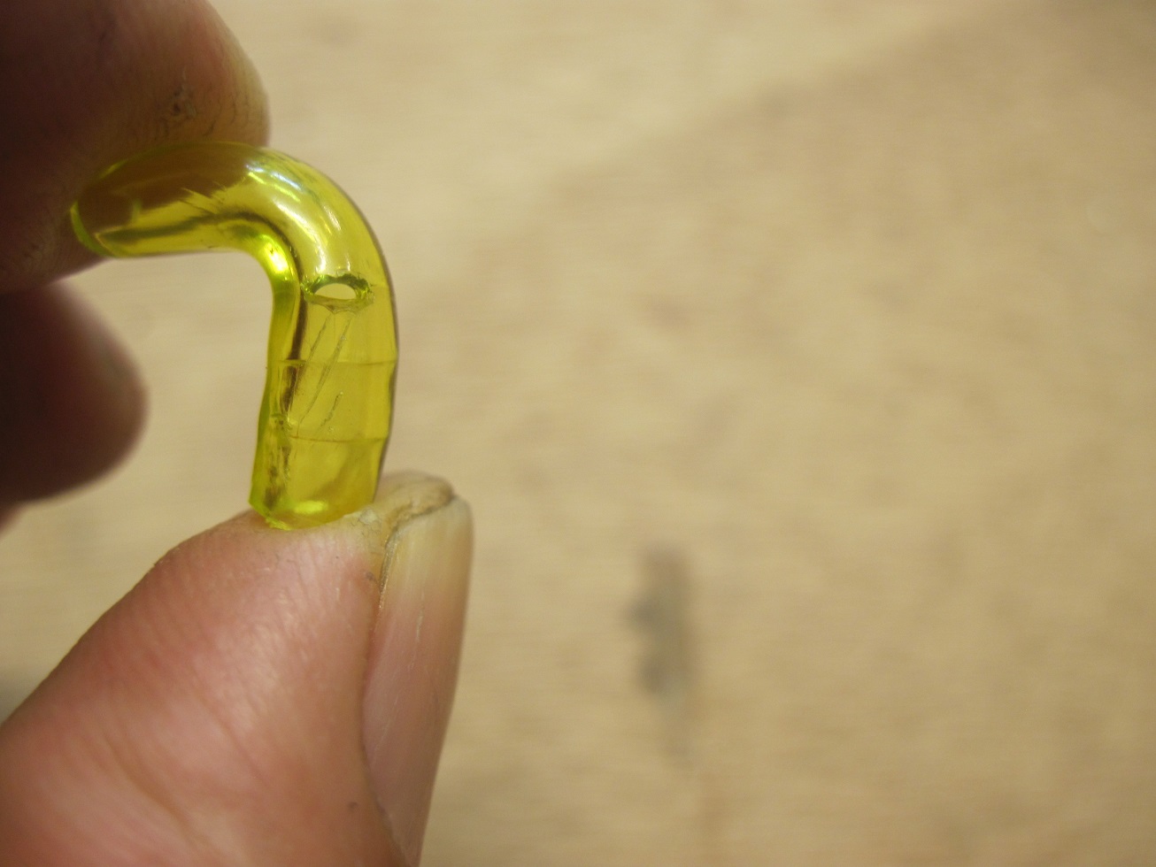

Had a flame out yesterday, this was the reason. The tygon fuel line cracked just as it turned to go into the fuselage right at the end of the nipple.

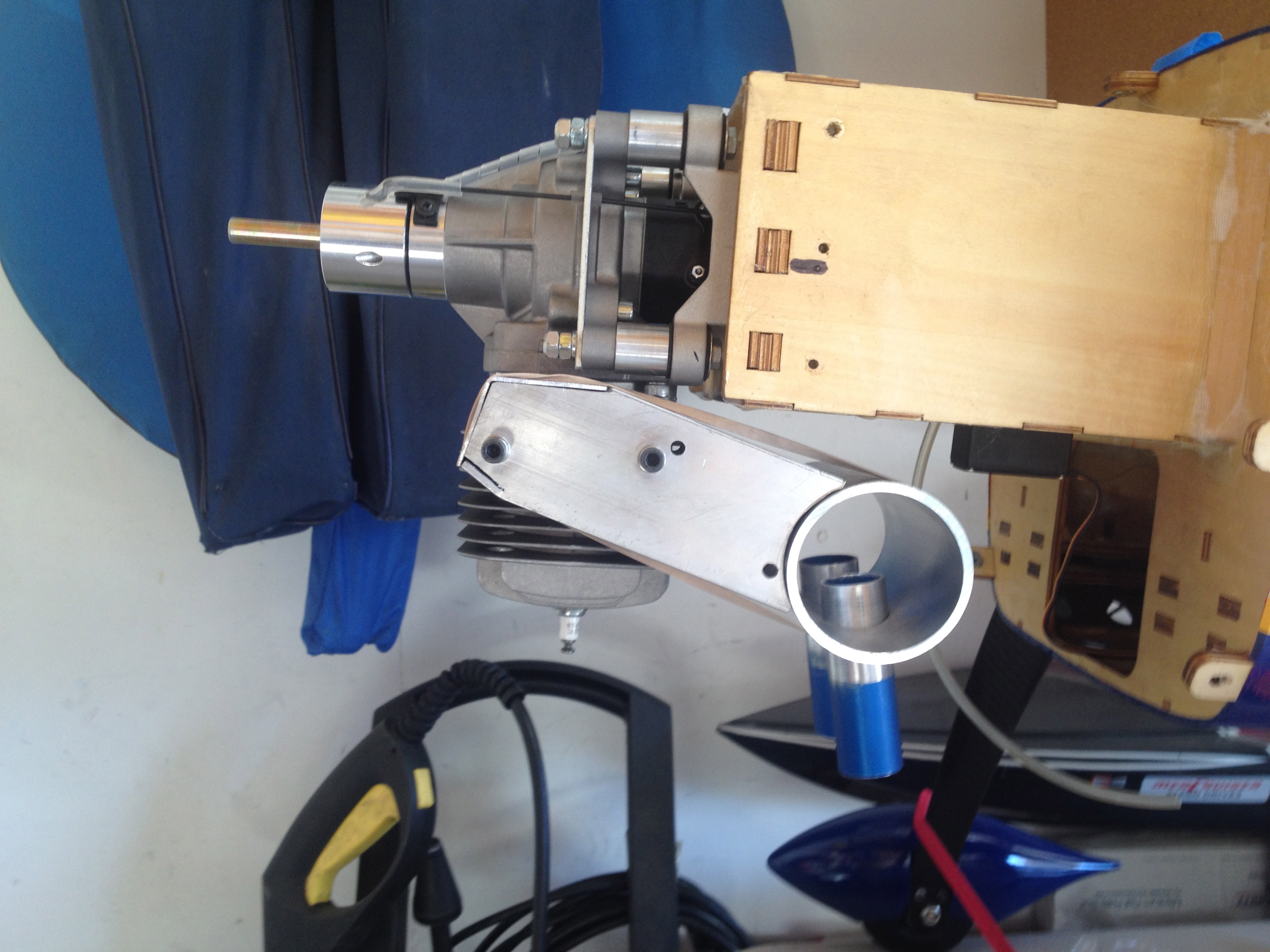

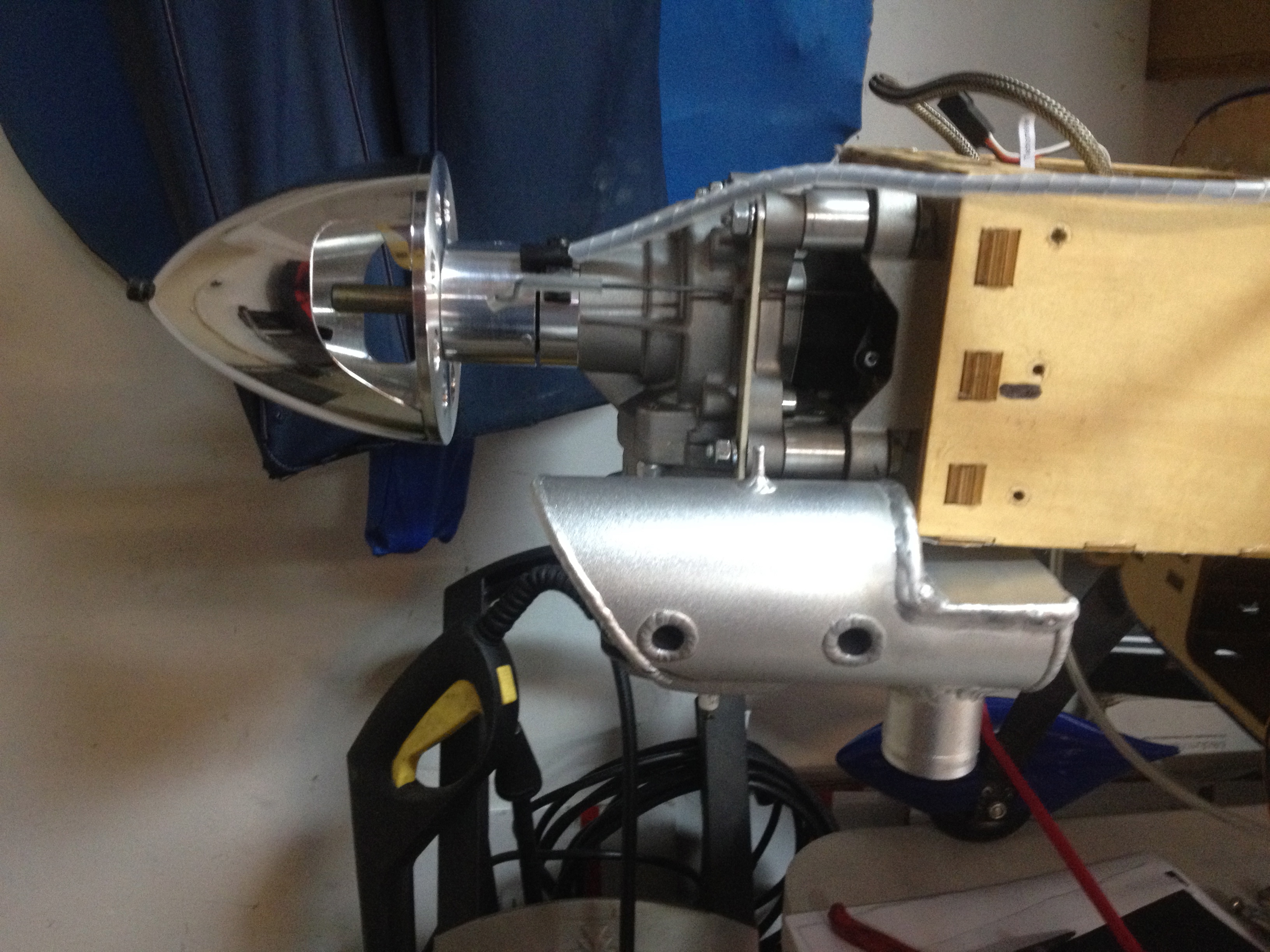

I mounted my on the EG Raven 33% but required lot of modification because the firewall too long and I don't want to cut the firewall so I made a short standoff to use with the vibration damper came with the engine, next i have to cut the big fat muffler to fit under the firewall. After did all that I thought it will be fit nicely inside the the cowl but damn the front muffle still hit the bottom cowl that required to cut a small hole, again i don't want to cut the hole in front of the cowl and decided to go with the pitts muffler and build that by myself, ran to the metal stores picked up some tubing and 1/16 sheet Aluminum and make it in few hours, now just need to weld them together and waiting for the prop and few more stuff to complete build.
Tom
