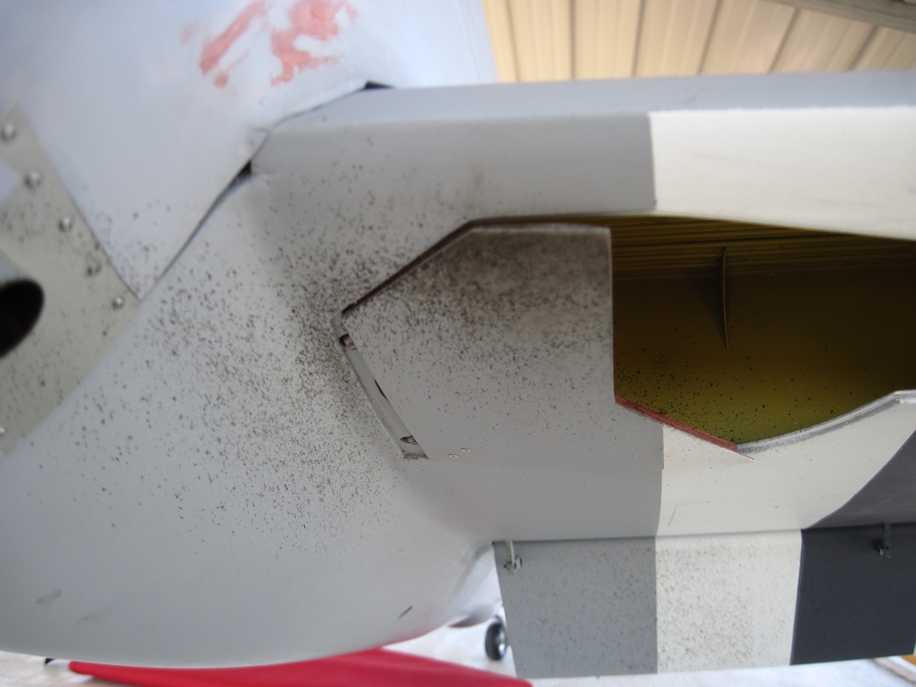

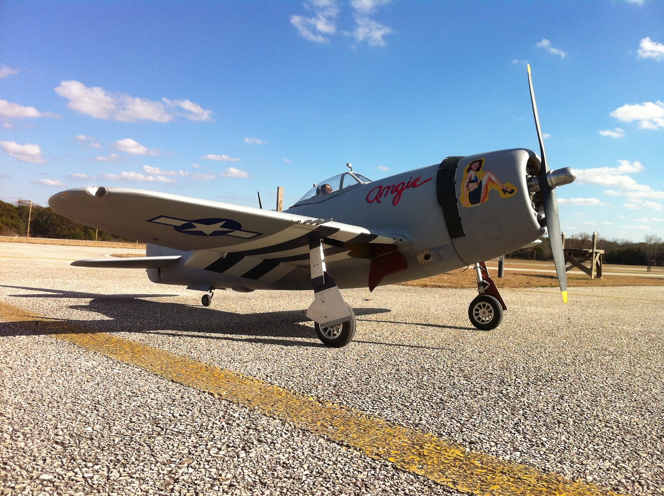

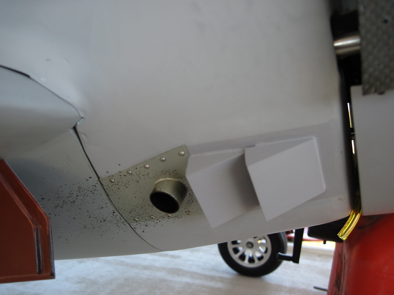

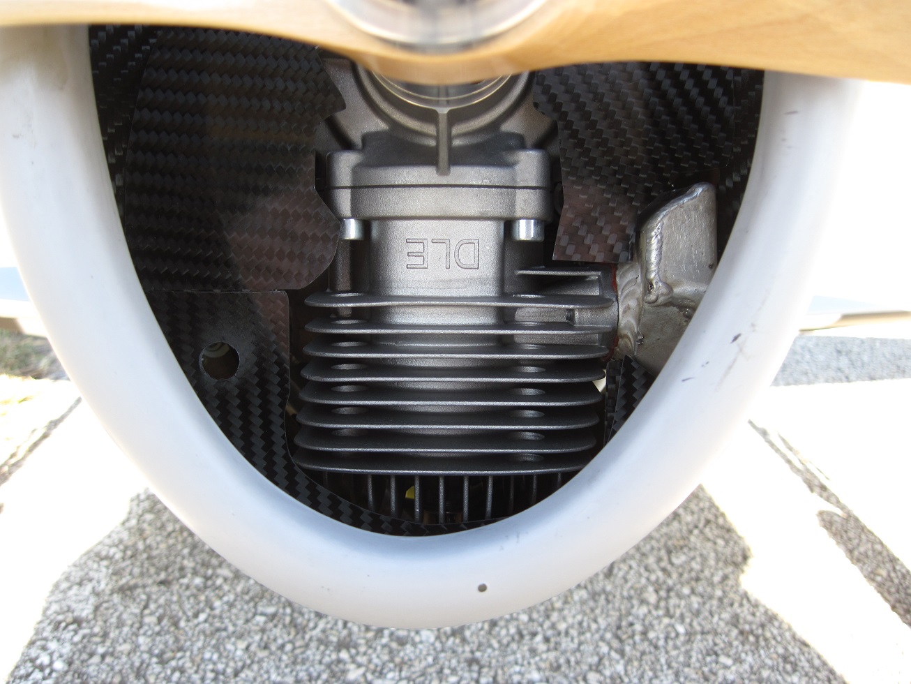

I finally finished my P-47 and got to run the engine for the first time in the frame and with the modified muffler. She started right up and ran nice and smooth. The muffler and exhaust sounds great. It is running pretty rich and I had a 26x10 Xoar prop on it and my RPM was 5600
I am planning on putting the 25x10 on next run up and see what the RPMs are . I need as much ground clearance as I can get. I also have the 22x10x4 prop that will be the running prop once the engine is broken in. I figure it will take 30-40 flights to break the engine in.
The temps after worm up, throttle up and a short taxi run up and down the runway was in the 180-190 with the cowl off and about the same + 10 degrees or so. It is running much cooler then my EME 120 does. More test to come and a maiden next week.
TB

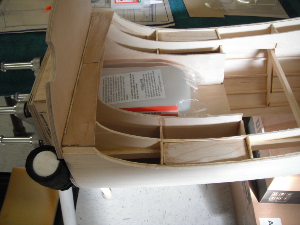

Fella's, the Ziroli Hellcat that i am building that the DLE-85 will go in is actually a bit restricted to fuel tank size. There is plenty of width and length available but the distance from the fuel tank box to the top of the wing is under 3". I was planning to use a Dubro 32 ounce tank but finding that it will interfere with the top of the wing. Would a 24 ounce tank enough and provide 10 minutes of run time with a bit of a safety factor? Thanks.

Thanks Tony. After studying this a bit further and not finding another tank in the 30+ ounce size range that will fit is to install the tank on its side and cut some sheeting out of the wing center section, the tank will then fit between the two center ribs, there is no actual center rib on this design.

Better to have more then less on these warbirds. Good chose and solution.

Why not consider using two tanks side-by-side or in any configuration? The jet jocks do it all the time and it eliminates some of the "slosh" you get in a big single tank. I have done it on several models with no problems. You will need a slight knowledge of "plumbing" but it is quite simple when thought out.

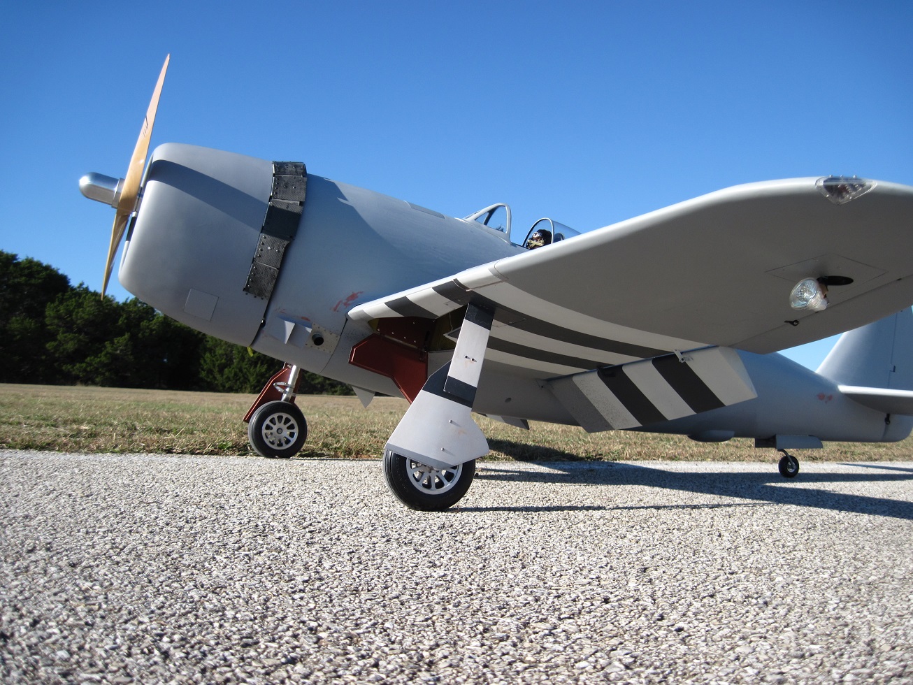

I have 10 flights on my engine now. I am using a 26x10 prop and getting around 5800 rpms The engine is running good, although this has been the only DLE that has given me trouble on starts, flooding. I have done tests to see what the starting procedure is and on a normal first day start I chock then flip, she pops after a few, then no chock and she starts after a few flips. Warm starts are without the choke. Additional cold starts of the day are with the choke. But a couple of times the first start of the day she would flood with the choke. So she is a little finicky. Not sure if it has to do with setup or what.
Otherwise this engine is pulling my 37lb plane around really nicely. After 15 more flights I will try the 4 blade prop.
