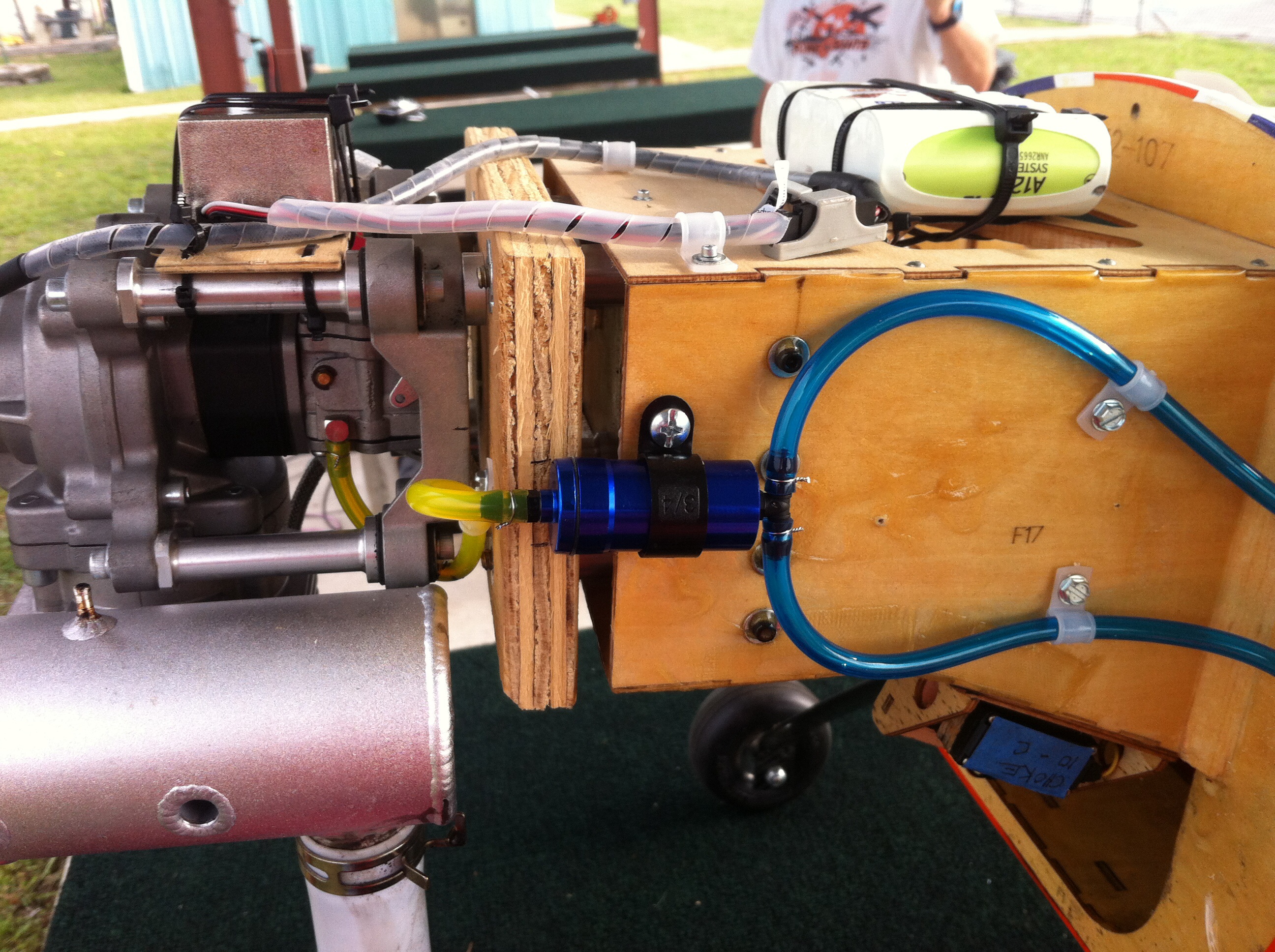

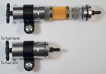

Old 05-27-2014 | 10:58 AM
  #155
TonyBuilder's Avatar
My Feedback: (11)
Joined: Mar 2010
Posts: 4,166
From: Austin , TX
http://www.jlproducts.net/ProductQuikFire.html
TB

Old 05-27-2014 | 11:01 AM
  #156
OldScaleGuy's Avatar
Joined: Dec 2005
Posts: 2,933
Received 7 Likes on 7 Posts
From: Reidsville, NC
Thanks Tony. I do recall seeing this advertised in one of the monthly magazines. Looks like a nice addition.

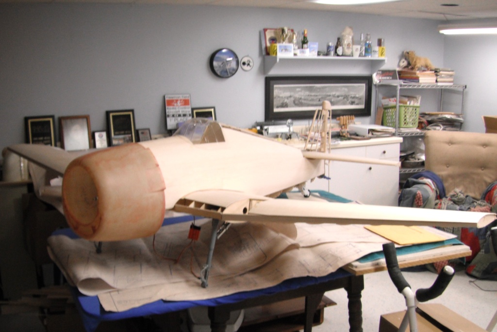

Old 06-02-2014 | 07:54 AM
  #166
Joined: Dec 2005
Posts: 2,933
I figured it was too much for a 1/4 scale Extra. That's ok, on to the engine test stand it will go.
The engine was purchased for a Ziroli Hellcat (still under construction) so it needs to be dependable before first flights on that plane that will occur next year.

Old 06-02-2014 | 11:42 AM
  #168
Joined: Dec 2005
Posts: 2,933
Wow, that is a great looking Tigercat. Yes, it does have a good long ways to go and i can't stand being stuck in the workshop when it is decent weather outside. So it will sit most of the summer except for rainy days.
