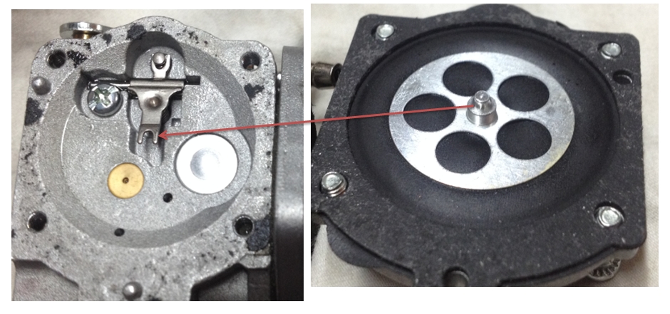

Gent's I need help. Yesterday i had a problem with my engine that couldn't run at high speed, went home and took the carburetor out to check and clean the filter put all back and the engine won't start and kept spit the gas out and flooded the engine. Thanks in advance.
Tom

Check ignition module, I replaced mine and it started right up.

Do you have a good spark? Charged battery? Those are a couple of things to start with.
Old 05-18-2014 | 02:47 PM
  #139
tom_sandiego's Avatar
Joined: Nov 2005
Posts: 323
From: San Diego, CA
Tony and Steve
The ignition is fine and battery full charged, something to do with the carburetor the engine fired for few seconds then quit by flooded
Tom

In my experience this engine/ carb floods easy. When I fuel up I have to clamp off the fuel line to the carb or fuel will drop out of the carb. Don't know what to say about your issues, normally all me engines have been hassle free.

Thanks Tony, i have to take a look at the cab. again

I found it, the problem was I didn't assemble the regulator diaphragm cover correct. I didn't have the pin with the slot on the Diaphragm slide into the lever that caused the valve open :-)

Can't tell 100% from the photo but the fork looks high compared to normal.

Still had same problem the fuel flooded the plug and come out from the rear, have no idea what to look next. Trucrkacer are you mean the lever to high? is that cause the fuel come out and flooded the plug?

Its hard to tell from the photo but the fork that engages the pin on the diaphragm looks to be high. In most cases the fork is usually even with and parallel to the flat surface of the surrounding carb body. If the carb is flooding, the needle is not sealing properly or its pop off pressure is set too low. Either problem could be caused by a defect, damage or improper adjustment.
I'm not recommending this but some people have actually removed the part of the pin on the diaphragm that engages the fork as they feel it serves no purpose. This comes from some very knowledgeable people and you can find reference to this if you do a few searches here on RCU.

Will do that Thanks
