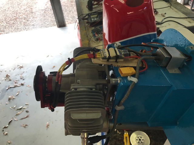

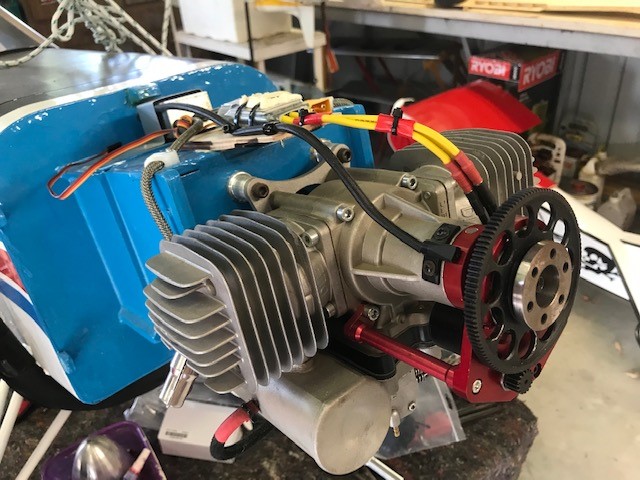

Have started to fit the starter bits to my DLE-111 on the 1/3 Pawnee.
I am going to have to rotate the mounting 180 degrees otherwise the motor will protrude through the top of the cowl. In order to do this the bracket that bolts to the engine case will need to use the lower bolts either side of the carby housing, I will have to split the bracket but should still work fine.

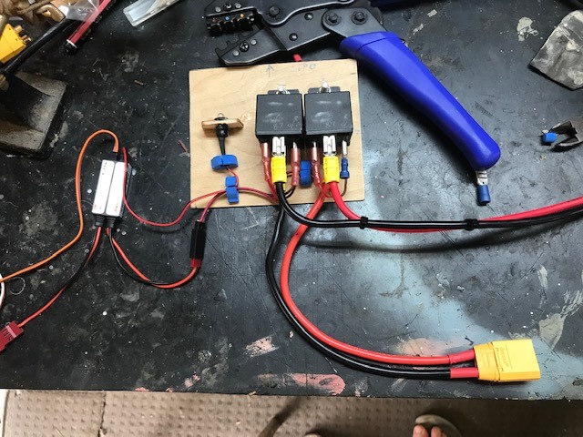

Will be using an opto kill switch to trigger two 6V auto relays that in turn pass the current from the lipo to the ESC. This way the lipo is fully isolated from the ESC when the starter is not in use.
Photo is my trial fit of the bits.

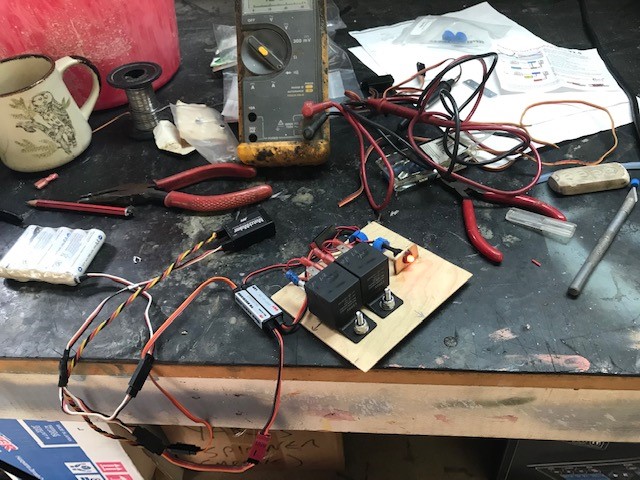

Spent a few hours mounting and wiring the speed controller as well as the relay board. Relays all working correctly.Just need to run the cables through the fuz and out behind the engine, terminate the connector, fit the relay board and give it a run.
Oh and ado a CG check again!

ok progress so far not that anyone is reading this dribble.
All cabling is completed, relays working as designed.
Next issue is to program the ESC, specifically change it to plane mode and set throttle end points.
At present when I plug the battery in it detects a "throttle", in this case switch is in full throttle position and goes straight into programming mode.
My aim will be to program the switch as follows:
- S0 relays off, ESC not connected
- S1 ESC receives a throttle stop setting & relays are triggered connecting the Lipo and the ESC arms with correct beeps
- S2 ESC receives a throttle full setting and motor is engaged to spin at full power
Hopefully this works, if not it will be use a manual arming switching to trigger the relays or a spare channel on the Tx/Rx to achieve the same.
Plan A, B or C!
Old 12-03-2019 | 03:46 PM
Joined: Apr 2016
Posts: 941
Received 139 Likes on 123 Posts
Happy to report the starter is now operational.
Programmed the ESC last night.Switch function for 3 position switch on AUX 7:
  • S0 - opto kill switch off, relays off, ESC off
  • S1 - opto kill switch is on, relays are on, ESC initialises and arms. ESC sees a "throttle STOP" signal. Lipo is connected to the ESC
  • S2 - as above but now ESC sees a throttle "FULL" signal and the motor is driven to full power to engage the engine for starting
Finally switch is put back to S0 which dis-arms the ESC and isolates the Lipo from the ESC cct.
