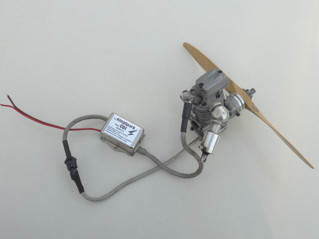

Mate:
If you like, recommend to try our unique power input CDI: KingSPark,
Ultra wide power input range, " full metal jacket " etc.....
This is a 30 (5cc) 4-stroke with KingSpark CDI, approaching a practical engine system infintely:
Running on 16V
http://v.youku.com/v_show/id_XMTc1Mj...ce%3Dautoclick
Running on 4V
http://v.youku.com/v_show/id_XMTc3MzY1MzEwMA==.html[/url]
Guarantee working power range is 4-14V,actually 3.8V-18V is OK also,
(we have applied a copyright protection,any similar imitation is illegal,all rights reserved.)
We developed the first Chinese auto-adv mini CDI in about 2004, but it was imitated seriously soon,
and later we invented this 4-14V CDI technology about in 2008, even in world wide this type of mini CDI is
the first one, (NO2 Generation auto-adv mini CDI ,If you like, I would name it innovation from orient, IO-CDI and
If all the costs withdrewed (N-K-US$, if sombody like to buyout this technology is welcome,but exclude Rxx) ,Maybe we can open the source code and write thesis to describe the
detail hereon, to promote CDI level a big step world wide),
Our imitator has been in imitating this for nearly 10 nears, but still in the imitating way, this time it
is a pretty hard work for them, any of consumer can witness it: copied,copying,cloned,cloning,.....
Furthemore,CDI is just a little part of our unique mini power system, due to the well known seriously copying,we
research and make it mostly for ourself, maybe to withdrew some researching costs, or let others know the
existence of CDI is not always you look like, occasionally, a few users can experience it, include 3W GmbH :
