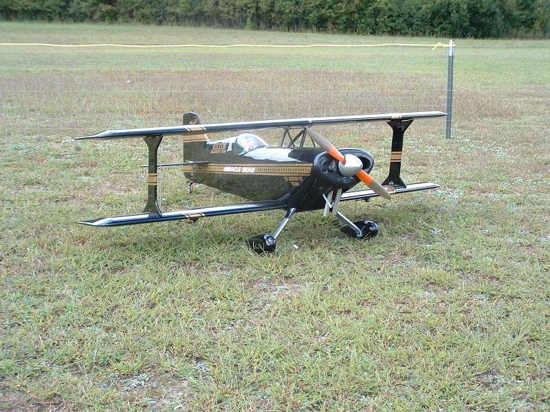

Old 09-19-2004 | 08:07 AM
Joined: Sep 2003
Posts: 72
From: Oceanside, CA
Default RE: What gas engine to replace an OS 1.60??
well guys I don't have the plane but I want to buy it.
the only catch is that it already has an os 1.60 in it. I know it puts out around 4 horses and I don't mind using glow but I want to change over
to gas. this plane is not to heavy but it is big.
heres a pic included.
it has about the same specs as an aeroworks 27% ultimate.
I know a guy who had a DA-50R on his.
SPECIFICATIONS
Wing Span 63" (about the same size)
Wing Area 1420 Sq. In.
Length 63" (maybe a little shorter)
Weight 14 to 15 pounds (assuming the same weight)
thanks for all your help.
I have been trying to find out who makes this biplane and can't find anything out.
I beleive it is a weeks solution but don't know what kit it was made from.
Old 09-19-2004 | 10:33 AM
PlaneKrazee's Avatar
My Feedback: (14)
Joined: May 2002
Posts: 4,878
From: Gales Ferry, CT
ORIGINAL: Goekeli
Why ZDZ40 when the DA50 weights about the same and is in a completely different class?
Joe
It would depend on the airframe. The ZDZ is more than enough power for the Gene Soucy 1/4 Extra. It is good for planes between 12 to 15-16 pounds where unlimited vertical is required. I would not use a DA in that plane as you would cut away much of the cowl. The DA is good in planes weighing 16- 18 pounds with unlimited vertical. It would be gross overkill in a plane less than 15 lbs.
