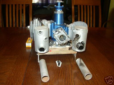

Looking at buying a used BME 102. The carb is bolted on the engine at a 45 degree angle. Weird having the throttle shaft angled 45 degrees from the firewall. Is this something the owner installed wrong or just the way the older BME 102 was made?

Sorry, Hope, this picture can explain it better than I can. See how the throttle servo linkage would have to come in at a 45 degree angle?[img][/img]

Never could figure out why someone would design an engine and not make the carb block for the best shot at the throttle servo....Too lazy to figure out a piece of 3/8 G10 with a few tapped holes in it ? 3/8 thick G10 is $24 a square foot..That's enough for at LEAST 36 carb insulator blocks....Sheesh

That is interesting, I went in the garage and looked at mine, and it id no where near that bad. The diaphram hold is almost straight out. THe carb has a slight tilt but it makes the radius of the choke and throttle arms in line with the fuselage.
Not to be insulting, are you sure it is mounted correctly?

Although I do not have the 102, that carb does not look right. My engine is like Geistware's where the choke and throttle are as close as you could ask for.
Your's looks waaaay off.

Looks like if the carb insulator block were to be turned over the carb would bolt on in a better position.....

By the way, what happened to those pipes and that throttle arm laying on the table?
The pipes are not supposed to be removable are they?

I have a BME 102, and just finished installing it in a 33% H9 CAP 232.
The bottom line is.... yup, that's the way the carb is mounted. Makes the throttle servo/linkage a bit of a challenge, but that's the way it goes.

I wonder if there are two different sets of holes in the case or if there was manufacturing change, because my 102 isn't anything like that.

What happened is you have one of the first BME 102's. The machine shop messed up the cases
They were fixed on the next run of cases.

Wouldn't be much trouble to make a new insulator block from 3/8 G10...Bolt the block to the engine with flathead screws, rotate to carb to whatever angle you want and drill and tap the block for 10-32 allens....Piece of cake...every conversion I ever made has been done this way, the throttle shaft is parallel to the cylinder/s, direct straight connection to the throttle servo.

Todd is right. I just looked at my 110 (use same carb) and the manufacturer cast the carb BOLT mounting boses 90 degrees wrong. They should be at 2 o'clock and 8 o'clock, rather than 10 o'clock and 4 o'clock. Wonder how that got out?
I happened to find a pic of the corrected arrangement for comparison's sake.
Tim
