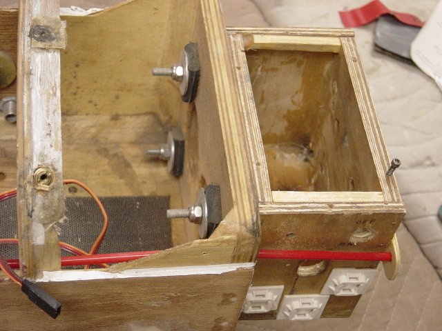

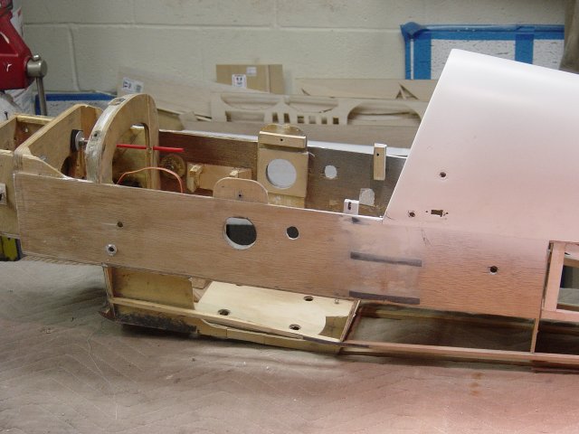

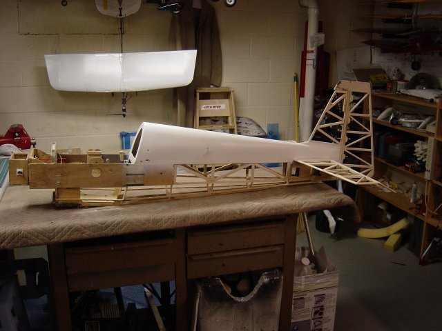

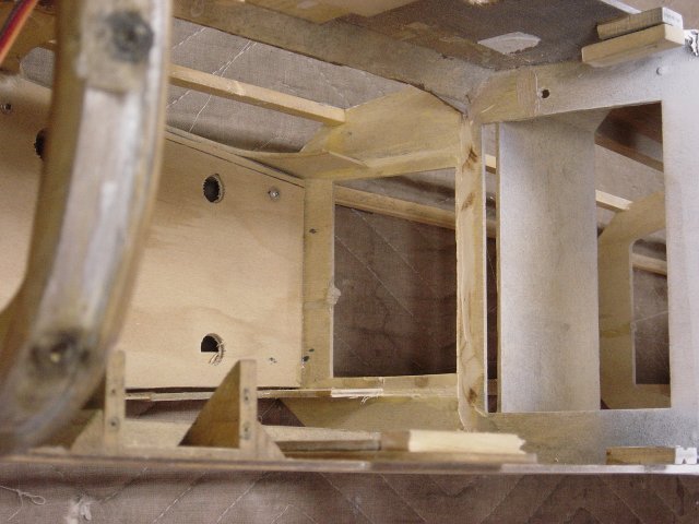

Jerry, here are the photos of the Laser I am restoring.
The wings are in good shape so I did not include them. In the eng box pic I am thinking about replaceing it with eng. stand offs, not sure of that is a good move or not. From what I can tell from my 1/4 scale Laser this has been ripped apart on the inside and had the sides replaced with frame.
