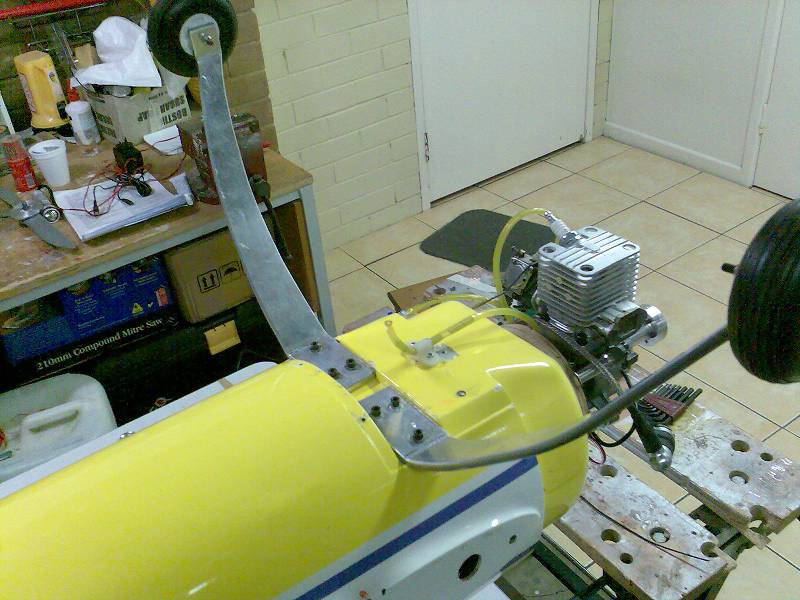

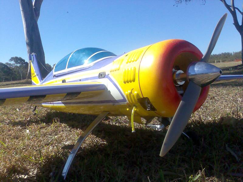

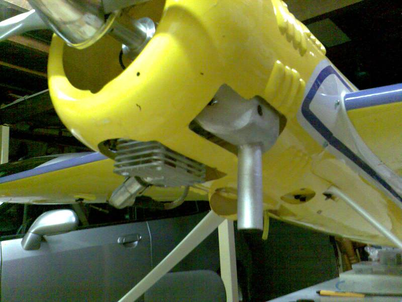

Crabby. Hows the maiden going - been up yep?. I have exactly the same plane - CMP Yak 54 140 fitted with an SPE40 as well. Its a really heavy plane for the wing loading so keep the speed up - other wise she will tumble out of the sky with no recovery prospects. The SPE pulls this plane with authority - a great combo. At the moment I dont know wether I hate the Yak or love it. It's bitten me twice with no notice. Make sure you keep the elevator movement really tight or she will snap and die. Good luck. lets us know how it goes.

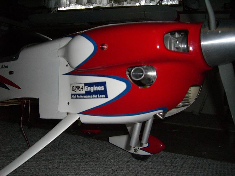

Sure have. BCMA Engines. Great engine, great service!

ORIGINAL: Lou55
http://media.putfile.com/Very-Windy-...-GP-27-CAP-232
Yep, thats an SPE40. Very nice indeed Ya gotta be happy with that! What ratio of fuel/oil are you running?
[8D]
Old 10-29-2007 | 05:50 PM
  #218
Banned
Joined: Jul 2005
Posts: 1,791
From: Port Orchard WA
Default RE: SPE 40cc
I'm at 40:1 now running Pennzoil. Put a 20X8 Xoar on it when it really started coming on. Great little engine. Prime it, two flips and it's running like a champ.
