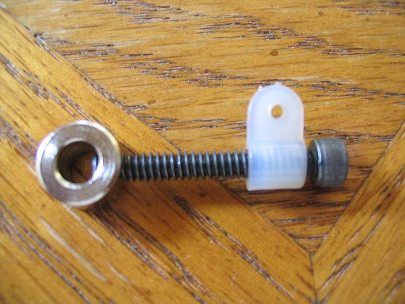

Grind the stock carburetor arm off, and put one of these on. I have 3 gassers set up this way. Works for me.
You need a wheel collar to fit the shaft, a #6 capscrew about the same length as your servo arm, and a DuBro #559 horn bracket.

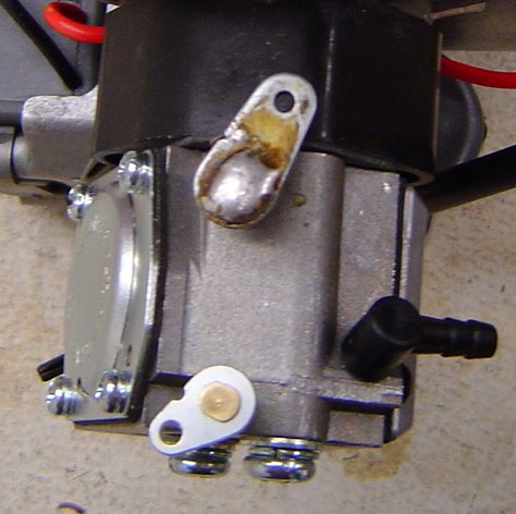

Remove the carb from the engine.
Remove the butterfly from the throttle shaft, then you can pull the throttle shaft out of the carb. Now you can solder it without worrying how hot it gets. I just did this with my new G62. Instead of using the plastic arm and set screw method, I ground off the top of the shaft and flipped the stock arm over and rotated 180 degrees, then soldered back on. This also let me keep the return spring hooked up which I like as a safety feature.
Here's a couple of before and after shots. Not the prettiest solder job, but it works.......

Old 03-12-2006 | 06:26 PM
My Feedback: (11)
Joined: May 2004
Posts: 310
From: Danville, VA
Default RE: 3W Throttle Arm Attachment
Ben whatever you do don't take the butterfly shaft out,just get some stay brite solder and flux solder it on. The hole procedure takes less then 10min!If you take the butterfly off you have to brad the screw when you put it back together or the screw cac come loose and into the engine and engine into the trash.Loctite won't work!
