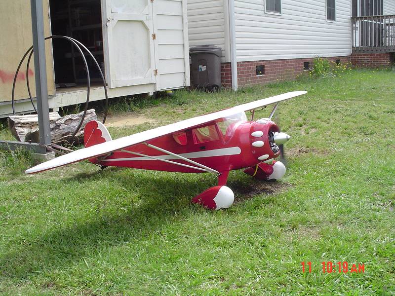

I have mine in a kange monocoupe and it flys great
