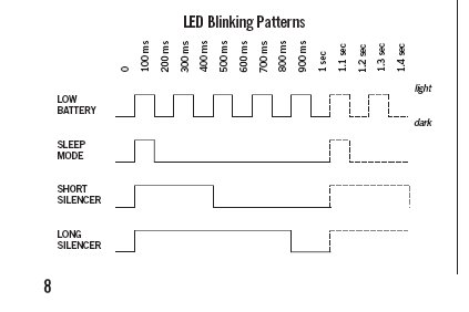

There were two kinds of programming method. The first one, doesn't use LED and use only servo during a programming, the second one use a LED and servo. Please if you don't understand programming send me a message and I'll try to describe it in more detail.

And now I would like to write a little bit about a programming. You can setup a closed and opened possition for a choke, and then you set a type of silencer. After this you can see the LED flash shown on a schema shown by [bluemagic98] for short silencer (4th curve, short light longer dark.) for long silencer (5th curve, long light and short dark). You will never see it again until a next programming procedure will take place. So after power on you don't obtain an information about a type of silencer.
The 3 short flashes and 1 long flash (after power on) tells you, that ignition works properly and battery is good, otherwise LED will blink continously (1st curve). (A battery is checked during the blinking after power on.) This curve isn't drawn in a manual.
Please write me if it was useful for you otherwise I'll try to explain it in more detail.
