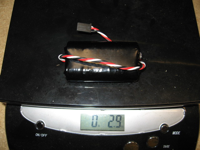

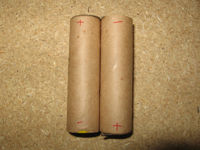

Picked up a few VPX packs today for one of my ignitions
ID:	812835   Click image for larger version

Yep..they are just smaller than the original's--same chemistry. finished weight 2.9oz

VPX is a new line of rechargeable power tools from Black and Decker. They are using 1100mah A123 cells for their power packs. You can find them at Home Depot, Lowes etc. $19.95 for a 2 cell pack.
