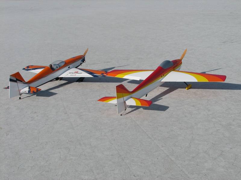

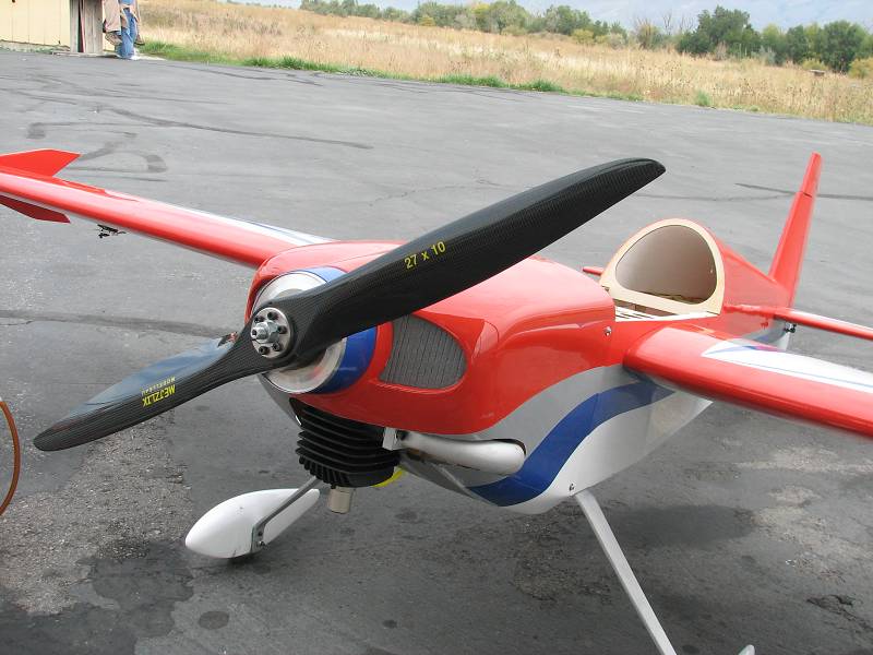

-the meter as noted -is a RS I have had for many years and is for all intents and purposes "good enough".
On this hard packed salt/mud - we performed the tests from all points and met (barely) the published requirements
to do this:-- The ZDZ40 F3A was running a 20x12 ZDZ prop -wooden - in low 6000rpm the exhaust system is a Carbon fibre full tuned type (Ed Skorepa) and the all composite fuselge was carefully taped and tightened and shimmed etc -to eliminate all buzzing and rattling --the fuselage sounds--sounded awful in the air and had to fixed to meet the sound test
the test -by the numbers -is a POS .
But -part of the rules - so we did it -by the rules.
None of the in cowl gassers have a chance of meeting this test done correctly.
Power wise- this plane is a rocket but appeals to a very limited audience - the entire setup is expensive.

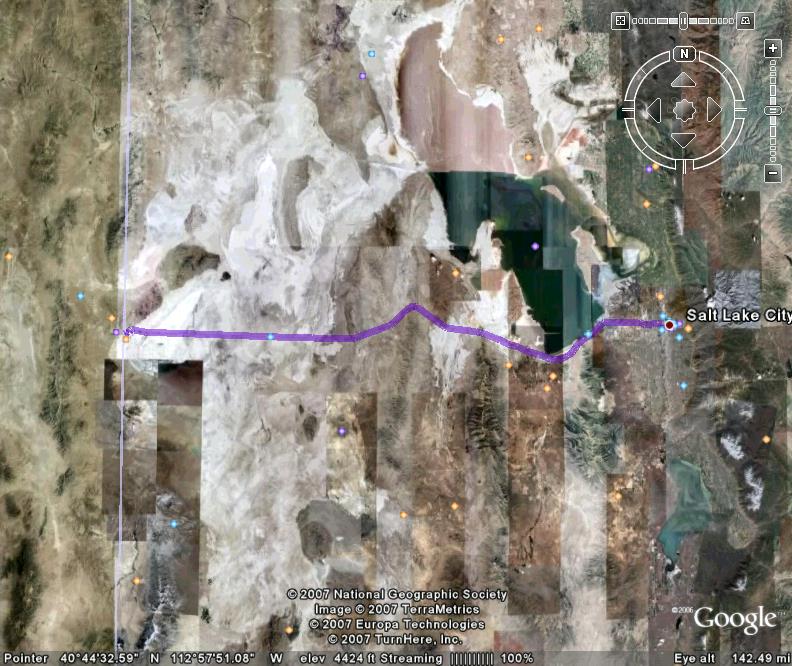

the salt flat is quite interesting - it self levels due to water table rising slowing and essentially flooding and receeding - -it is like a huge billiards tabe in flatness and almost as hard--- in summer ,it is always slightly damp,cold and hard
Hmm.. I better rethink my idea of what you fly on. Kinda hard for a simple Dutchman. If there are no open pores, there is no damping at all and total surface reflection will be a probable. Your readings may well be higher than they would be over concrete or macadam.

actually - it is unique -not like concrete as it is deep
some years it is absolutely FLAT for miles n miles
that is why speed runs are done here --- 200 mph feels like cruising along at 60-- your only referrence is the black line to keep you going to/thru the traps the reflection is also unique - a light meter reads same - up or down
If you ever want a full even tan (burn) this IS the place. the purple line on map ,is 100 miles long--almost halfway, is our flying field

2) Prop noise.
Tip speed should stay below Mach 0.7, or the prop may start showing flow speeds approaching speed of sound. "ripping" like the crack of a whip is the result. Thinner foils with thickest foil section far back rip later and at higher tip speeds. Thin foils can be had with carbon or metal props
Lower tip speeds can be realized by keeping the pitch up. Pitches of half prop diameter or less easily enter the noise danger zone. The sound waves may set the prop in vibration, which endangers the prop and operator as well.
