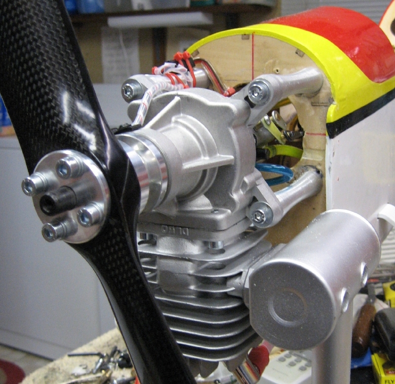

paul5992 - regard JXF props.... I have had some, and they work well, but there are variations in firmness and rigidity from prop to prop. Try the "untwist" test. Grab a NX or 3W or Menz....try to untwist the blade and watch. Then do the same with the Xoar or JXF. In my experience the JXF untwists more easily than others. The very WORST out there for this un-twisting are the Master Airscrews, Zingers, and absolute BOTTOM of the bucket, the Top Flites.
Please know that I am not "bashing" products as I only share my personal experience and observations on these threads. If I do not "know" how something acts, I'll not comment.
In the case of props, I have done a lot of experimenting.... my DL's really are "happy" (so I'm happy) with the NX and Xoar 22 and 23 x 8's.
If you are concerned about hub compression, and still want to run a soft prop, simply drill four 1/8" holes through the hub like mounting holes. Get 1/8" hardwood dowel. You will have to tap the 1/8" dowel into the snug fit holes drilled, then simply put a drop of CA glue on front and back. The dowels will absolutely stop compression.
This is the same fix (only done with 3/32" dowels, or hardwood toothpicks) to firm up the cheap-ARF firewall engine mounting holes so they don't compress under standoff tightening. Works like a charm.

Coke, Xjet - have you DONE the modification I'm suggesting to any props and run them?
I have done this a few times, when pressed by needs to use less-than-optimal propellers, and although there may be some stress/load redistribution in the hub, the ones I did sure didn't fail, either.
Not picking a fight, just trying to offer help to someone who was trying to prevent worse problems through hub compression while in use. (As a former ZDZ owner, I can tell you that that phenomenon DOES occur, and can be REALLY BAD when it happens in flight).
I'd be interested in some sort of a means to test the compression load distribution across the whole hub face before and after such a mod?
BTW - with softer hubs, torquing the screws to an appropriately "correct" value doesn't cut it....they will loosen nearly immediately when run, then they must be re-tightened, and that is where the circle starts.
Personally, the NX, Xoar, and PT Models hubs seem to be quite hard. The JXF that I have vary from prop to prop quite a bit.

Bob, You could always set up two dial test indicators on the front plate after tightening the bolts. One on the washer just outside of the dowel and one just outside of the bolt head. Set them both to zero and come back a couple of hours later and see how much they have moved in relation to each other. The one outside of the bolt should move more. I know I kept re-tightening the bolts on my TBM prop and after about the fourth time the hub cracked. The Vess don't seem to have that problem. Also keep in mind that these props are side loaded against the four bolts so over-tightening is not necessary. I just snug them up in a set sequence and then run back through the same sequence until they all remain snug. If your spinner back plate has particularly deep serations it will usually take a little longer to get a new prop set into them as they cut deeper.

ORIGINAL: aerobob
