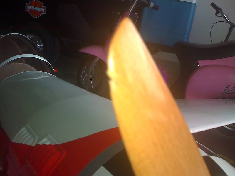

Lou, so you think an MSC 22x8 pulls harder than a xoar? Also do you think it would be worth the shipping to order one separate from my cowl for brake in?

I've never used an MSC. The comparison was written by Patrick Roy. He works with the UAVs and knows a lot about the subject. If I were you I would buy a Vess 22B or 23A and run it but that's just my preference. He compares a 23A Vess against a bunch of 22X8 props and not on this engine. My 23A gets 7400rpm and a ton of thrust so it's not overloading this engine. The props I wouldn't buy are the TBM or a Zinger. I'm quite surprised your Xoar broke. Did you have the Beechwood ply prop that I use or the solid wood? The ply props are really resilient. You may want to get some second opinions on the MSC props from someone who has used them. Bubbagates or JrJohn may have used them in the past. Anybody want to jump in on this???

Thats great cambo welcome to the family. Lou should I run a 23A on a motor thats not broke in yet? I was gonna switch to the 23 a or b once I was on synthetic oil but not now. Wanted to stay with a break in prop. My xoar was a beechwood I like a week prop so if I hit it on the ground hopefully the prop breaks not the motor or the fire wall. Thats why I don't run plywood or carbon. The prop picked up a little stick in the grass. Talk about dumb luck.[][]
